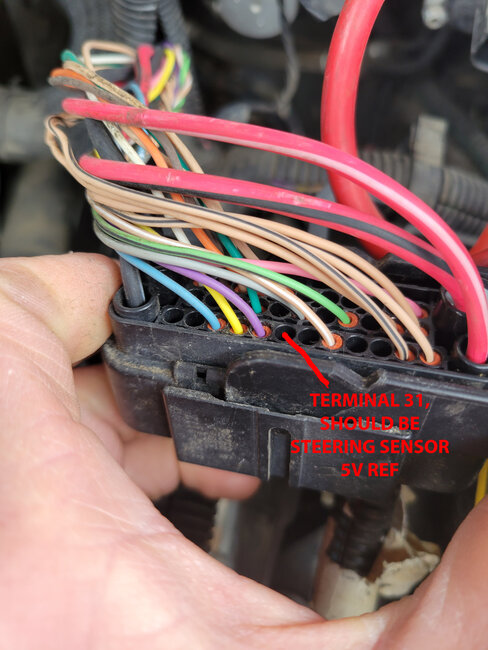

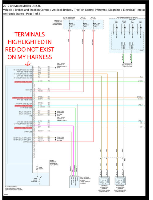

The ALLDATA diagram for this vehicle shows 4 wires going to the EBCM that simply don't exist on my car. The 5v ref, signal A/B and low ref are not present on my EBCM harness. I also checked my Mitchell manual, and the diagram is incorrect as well. This makes me unable to test the circuit any further.
I have attached diagrams detailing the missing terminals. From what I understand, the PSCM gets signal from the sensor and turns it into serial data to send the ECBM. for whatever reason the ECBM is not getting the signal which is good at the steering module. I am simply stumped and am nearly to the point of bringing it in to the dealer, which I would rather not do.

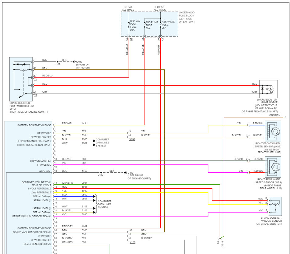

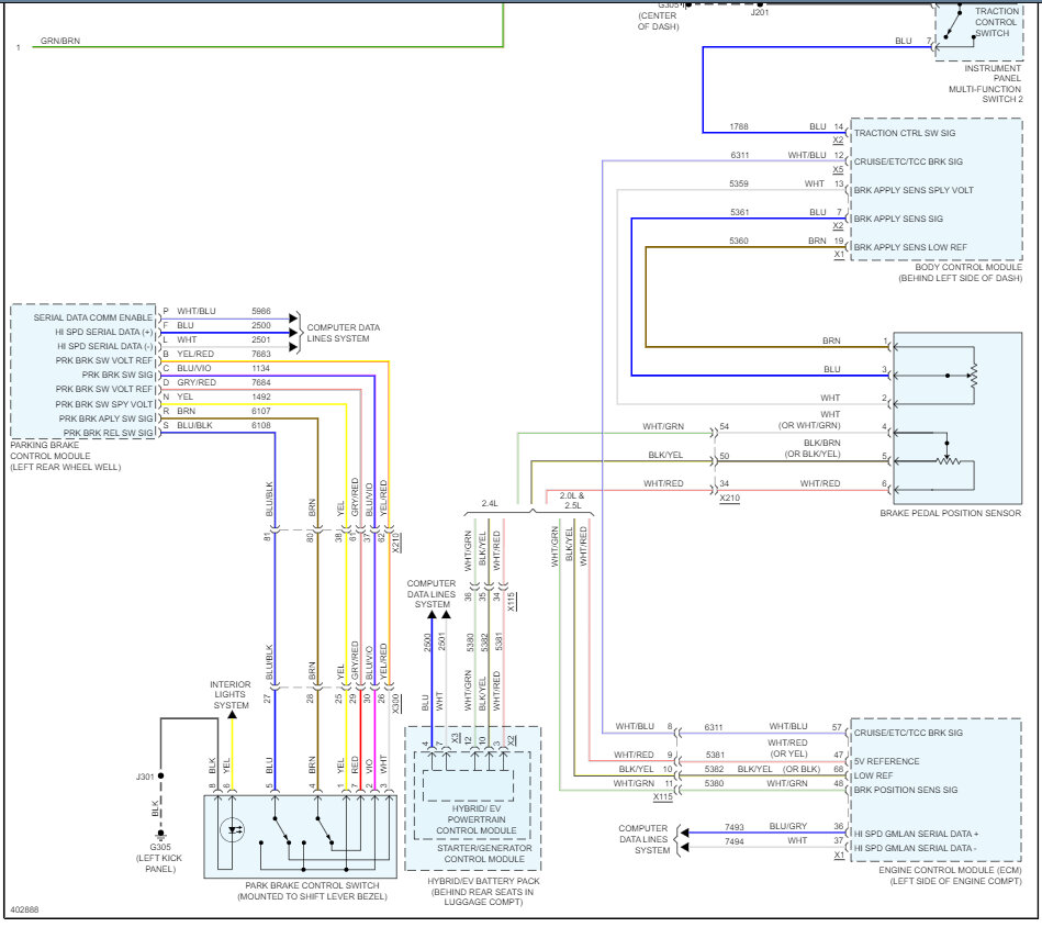

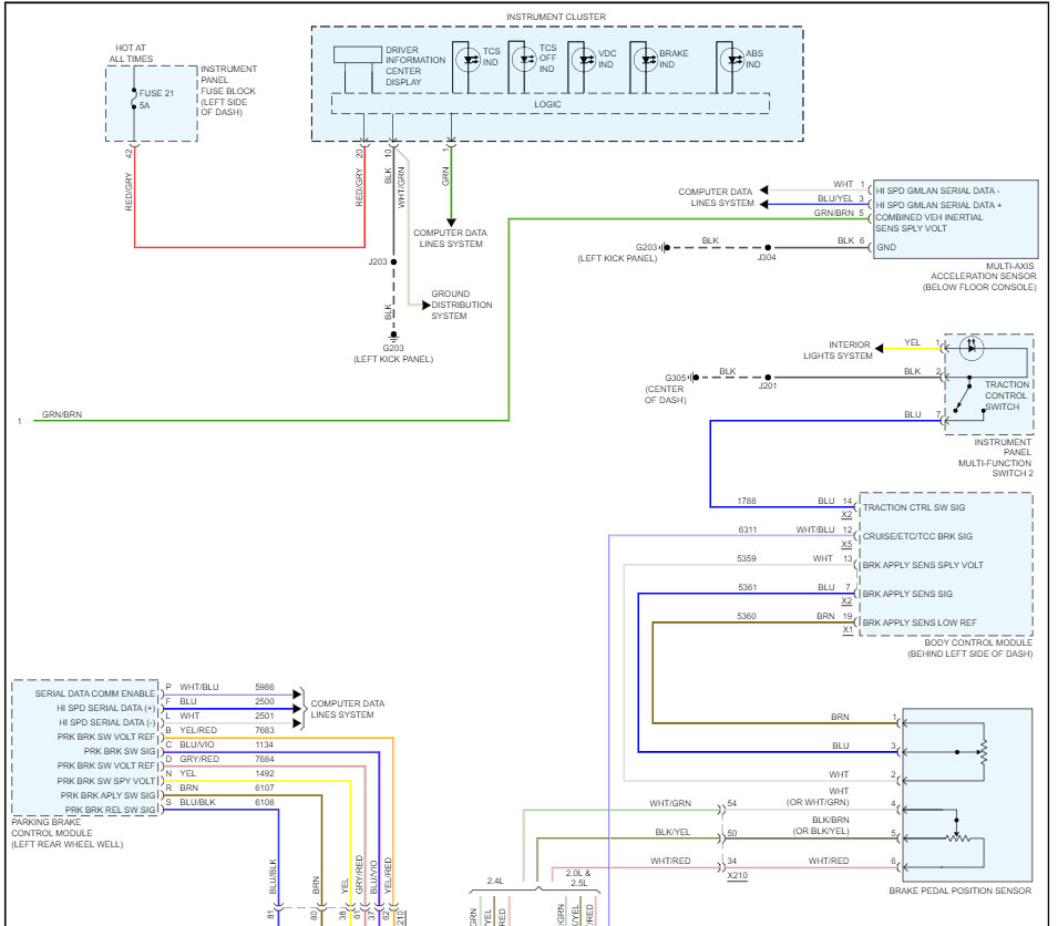

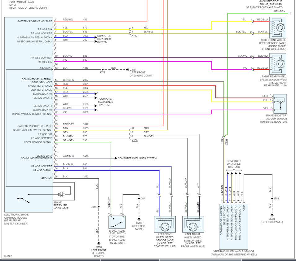

It looks like you have a late production model because the 2013 brake control wiring diagrams are different. Check out the images (below). Please let us know how it goes.

Thank you for the diagram, Ken. If it's a late 2012 model it would make a lot more sense as to why the steering sensor terminals would all be missing from the EBCM harness.
Unfortunately, it appears that the 2013 diagram doesn't correspond to the harness in my vehicle. I think it is correct in that there are only serial data in0puts to the ABS module coming from the steering position sensor/power steering module, so I think this is pointing me in the right direction.

So that leaves me with the problem of being unable to find the correct diagram for my electronic brake control module. The cars production date was indeed very late in the last year of production, but even the 2013 diagrams don't resemble the one on my vehicle.
For whatever reason, the two steering position signals which are good at the power steering control module, get jumbled or corrupted on its way to the brake control module. Both signals show 2.5 at the PSCM, but on the ABS module by data shows 2.5 volts for signal one and 0 for signal 2. Is there any additional diagnostic procedures to try or check before throwing in the towel and bringing it in?
