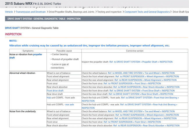

Have you checked the tire balance or a bent rim? Do you feel the vibration more in the steering or the seat and floor?
If it is more in the steering, then suspect the front wheels as to where the problem is coming from. If it is more in the seat/floor, it is likely in the rear.
You indicated the tires were replaced. Were all four replaced? Are they the OEM size?
I attached the general diagnostics below for a vibration. Take a look through it and let me know if anything helps.
See pic below.

Sounds like a plan. And just to confirm, was this an issue prior to the repairs to the rack and pinion?
May 1, 2022 at 11:35 AM
DIVIDES
  • 903 POSTS
I don't think i had this issue before the rack if i can remember correctly, but i drive it again and it's mainly 60-67 MPH.
May 1, 2022 at 11:46 AM
  • 110,244 POSTS
That sounds like a tire balance issue. If it was a mechanical issue, I feel you would notice it through all speeds. Also, check to make sure the tires don't have a shifted belt or anything that could cause issues.
