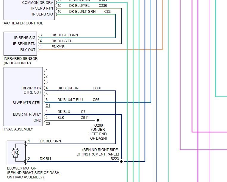

My daughter has the vehicle listed above that has given us some problems in regards to the heat/air controls (this has auto controls). The knob that controls the speed doesn't work, the speed is basically nothing at all. It used to just work on high, now nothing. I just replaced the Blower Motor Resistor and now it only blows on high constantly and does not even turn down or off and the knob for changing positions does not seem to work either (it did work before-hand), but the blower itself does work. Not to mention when I took out the old resistor it was for a 2010 Jeep Liberty. Very Strange. I thought about looking into the Blower Motor Relay or Fuse but can't seem to locate it? Maybe not.. I wish there was an YouTube video out there for this year on this topic.

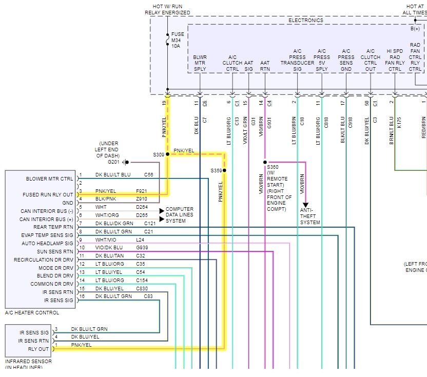

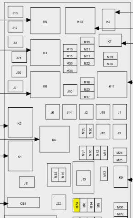

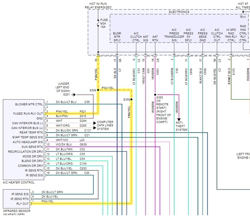

It sounds like the HVAC (Heating Ventilation Air Conditioning) control head is not responding and is most likely offline. When this happens, the default state of the HVAC system is typically blower speed set on high and the mode set to defrost. Let's start by checking the fuse for the HVAC controller. The fuse you'll need to inspect is M34 in the fuse box under the hood. See the attachments for fuse location and system wiring diagram.

I checked the M34 fuse and it looked fine but I replaced it anyways and nothing changed. Like you said, it's stuck on blowing high on the defrost mode. Any other suggestions?

At this point it sounds like the HVAC control head has most likely failed and will need replaced.
