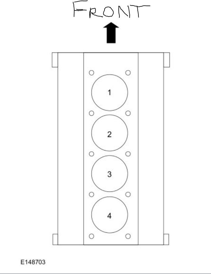

SCGRANTURISMO
  • 4,897 POSTS
Hello again,
A misfire sometimes will cause your vehicle's Malfunction Indicator Lamp (MIL) or "check engine" light to illuminate, and sometimes it won't. If it was illuminated for a misfire it would have the Direct Trouble Code(s) P0300(Random Misfire)or any combination of P0301 - P0304 (Misfire with the last number being the cylinder with the misfire)(P0301 Misfire in cylinder 1)(P0302 Misfire in cylinder 2) and so on. But a misfire might not turn on the MIL or "check engine" lamp. The key here is not whether the MIL or "check engine" lamp is illuminated or not but to find the cylinder or piston that is misfiring. We will do this just like I described above. Then we can figure out why your engine is misfiring, which is relatively simple and get it fixed. Please get back to us with what cylinder(s) or pistons are misfiring and we can go from there. I have also included a layout of your vehicle's cylinders, or pistons, so you have a reference to tell us which cylinders, or pistons are misfiring.
Thanks,
Alex
2CarPros
