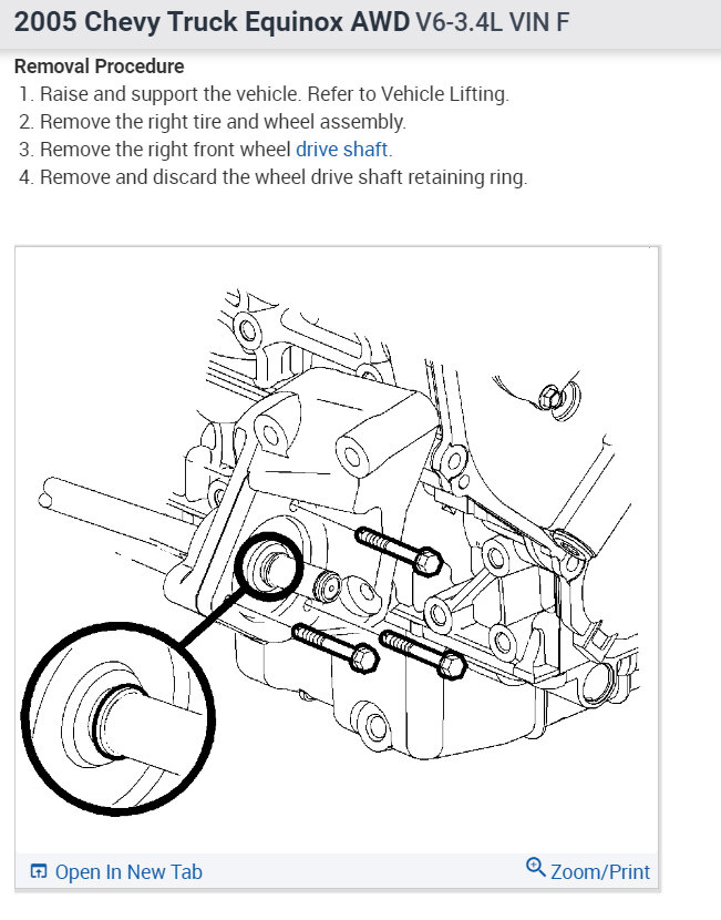

I purchased the vehicle listed above. I was aware that the vehicle had a blown head gasket and needed new CV axles. After repairing the engine and replacing the front CV axles, I also swapped out the front brake calipers, pads, and rotors. For the rear brakes, I replaced the shoes, hardware, and wheel cylinders, and performed a brake line flush using Bosch ESI6-32N Brake Fluid.
While replacing the CV axles, I drained the transmission fluid and refilled it with Valvoline Maxlife Multi-Vehicle (ATF) Full Synthetic Automatic Transmission Fluid, Part #773775. When shifting through the gears to properly fill the transmission, I noticed a forward bucking motion from the rear end and heard a grinding noise from the rear differential.
Raising all four wheels off the ground, I observed that the vehicle now seems to roll in park, necessitating the use of wheel chocks to loosen the lug nuts. When in drive, the front wheels aren't spinning, but the rear wheels are, with one spinning faster than the other. Applying brakes results in the same grinding noise from the rear differential.

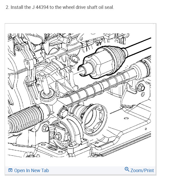

It sounds like one of the CV axles is not installed completely, I would double check the inboard CV axle joints to make sure they are in the transaxle fully. Check out the images (below). Let us know what happens and please upload pictures or videos of the problem so we can see what's going on.
