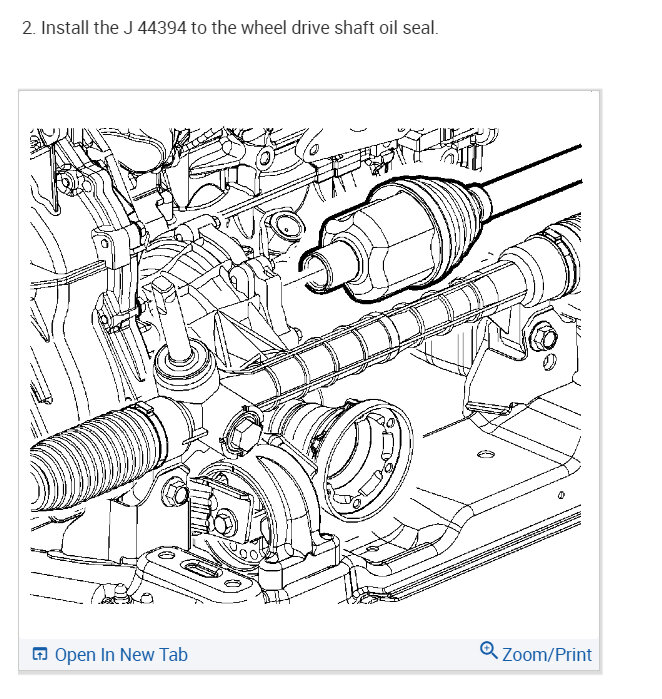

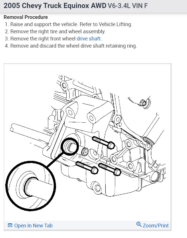

I purchased the vehicle listed above. I was aware that the vehicle had a blown head gasket and needed new CV axles. After repairing the engine and replacing the front CV axles, I also swapped out the front brake calipers, pads, and rotors. For the rear brakes, I replaced the shoes, hardware, and wheel cylinders, and performed a brake line flush using Bosch ESI6-32N Brake Fluid.
While replacing the CV axles, I drained the transmission fluid and refilled it with Valvoline Maxlife Multi-Vehicle (ATF) Full Synthetic Automatic Transmission Fluid, Part #773775. When shifting through the gears to properly fill the transmission, I noticed a forward bucking motion from the rear end and heard a grinding noise from the rear differential.
Raising all four wheels off the ground, I observed that the vehicle now seems to roll in park, necessitating the use of wheel chocks to loosen the lug nuts. When in drive, the front wheels aren't spinning, but the rear wheels are, with one spinning faster than the other. Applying brakes results in the same grinding noise from the rear differential.

I'm uncertain about the next steps. This issue didn't arise prior to my repairs, and I'm concerned I've made the situation worse. I drained the rear differential for inspection, and while the fluid was dark, no metal shavings were present. I have Versatak fluid on order for refilling. I also plan to do the same for the front transfer case. Any assistance in diagnosing this situation would be greatly appreciated.
