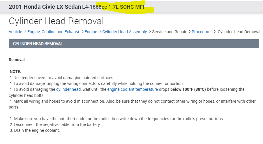

A guide for replacing the head including torque specs needed?
2001 HONDA CIVIC
200,000 MILES • 1.6L • 4 CYL • 2WD • AUTOMATIC
REDBODIE

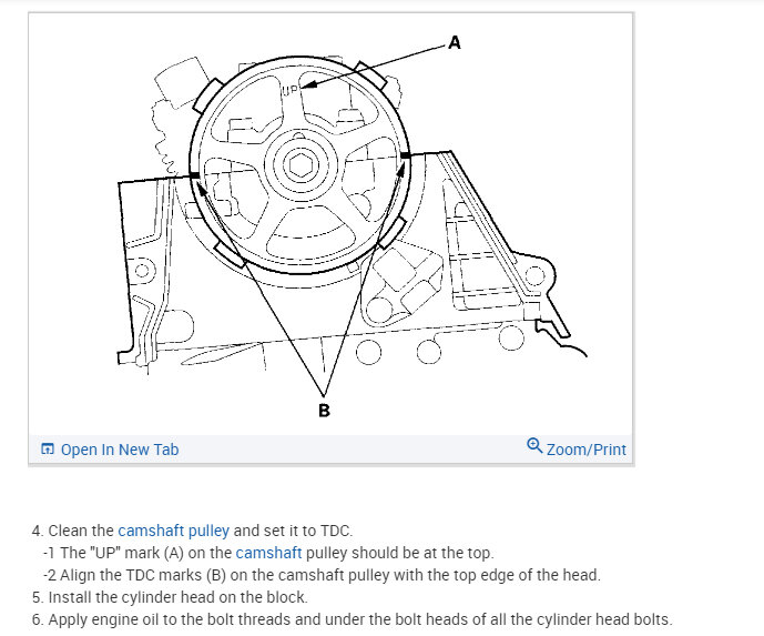

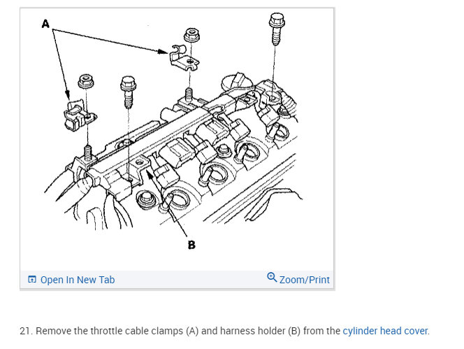

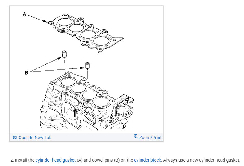

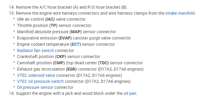

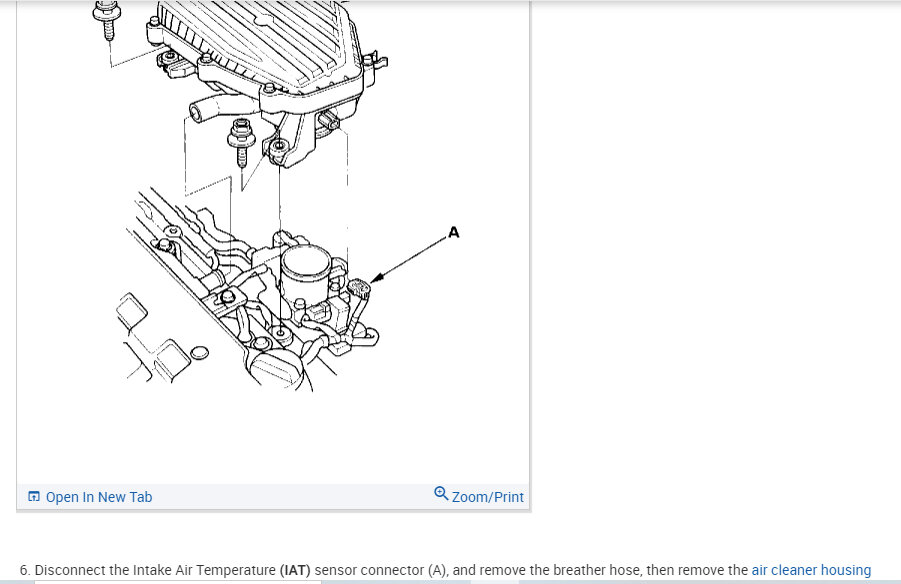

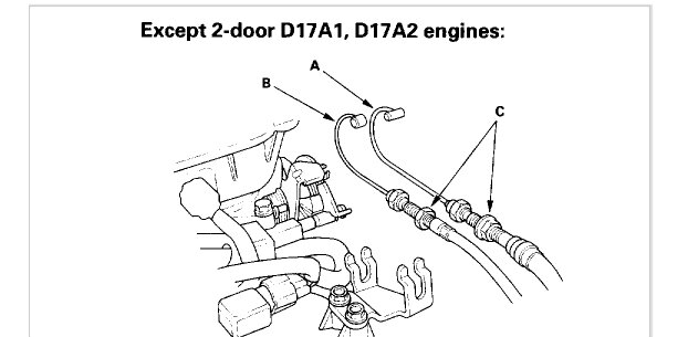

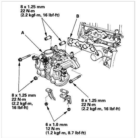

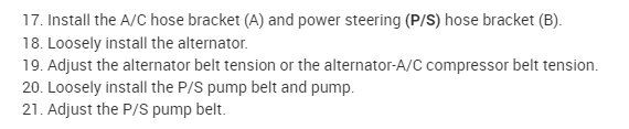

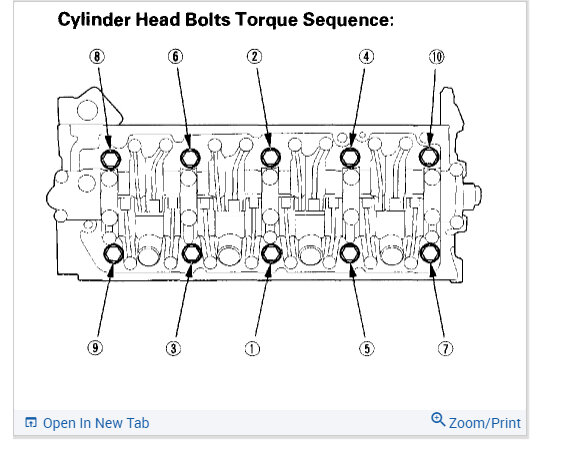

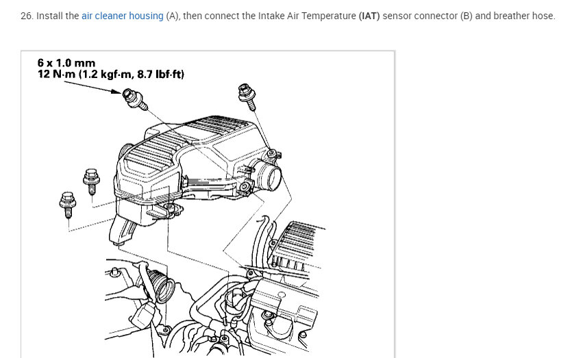

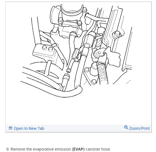

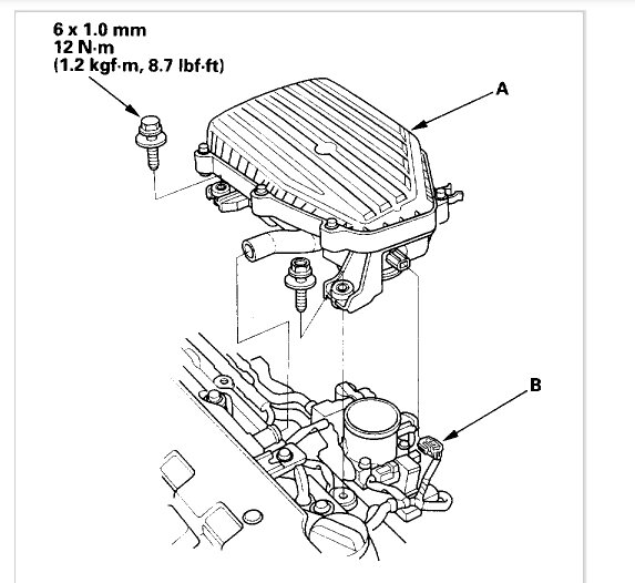

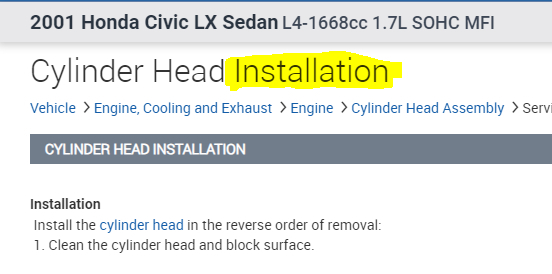

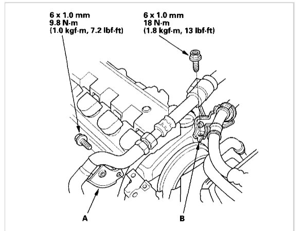

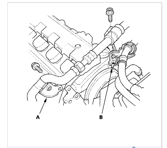

I need a free workshop manual for my car listed above lx. Or a guide for replacing the head. Torque specs etc.
Oct 11, 2023 at 7:19 AM
  • 110,240 POSTS

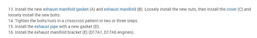

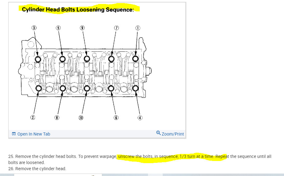

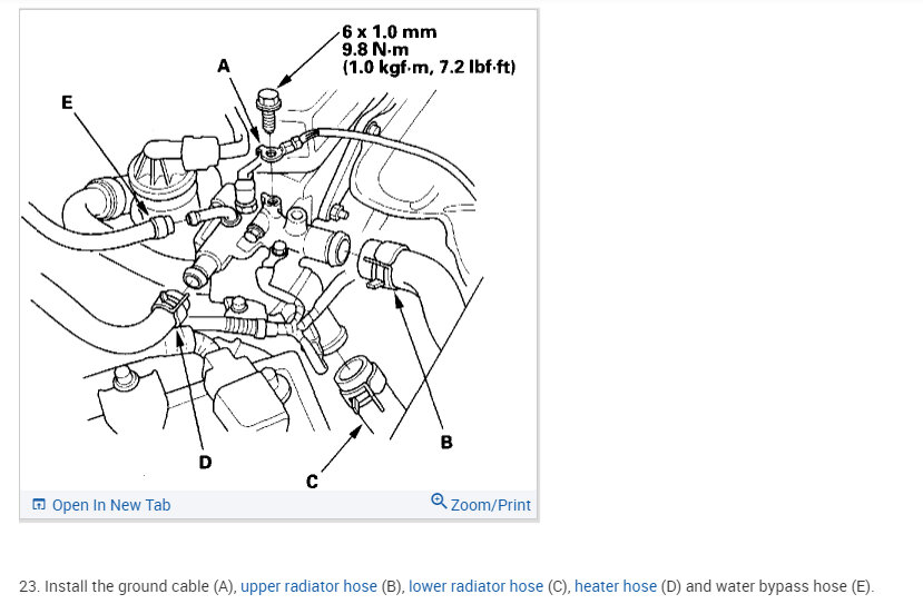

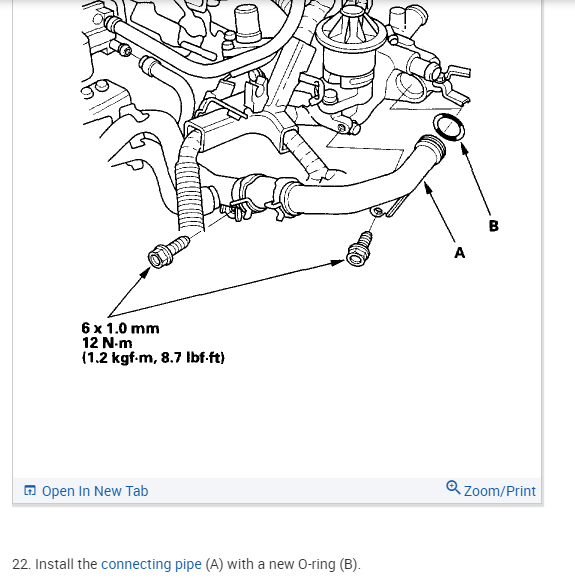

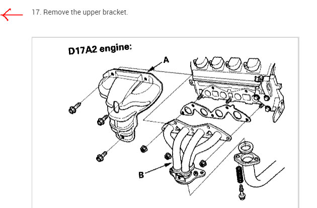

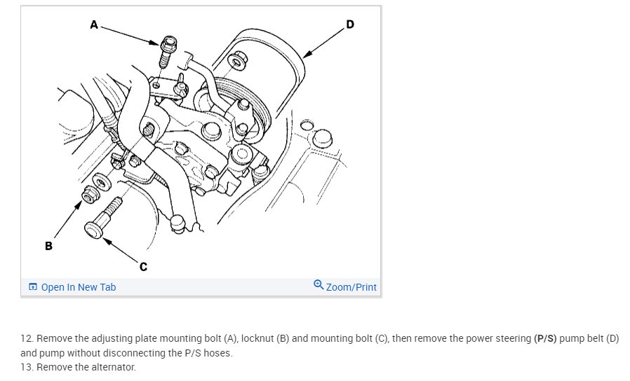

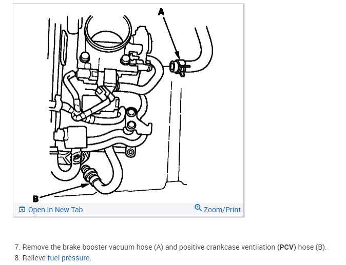

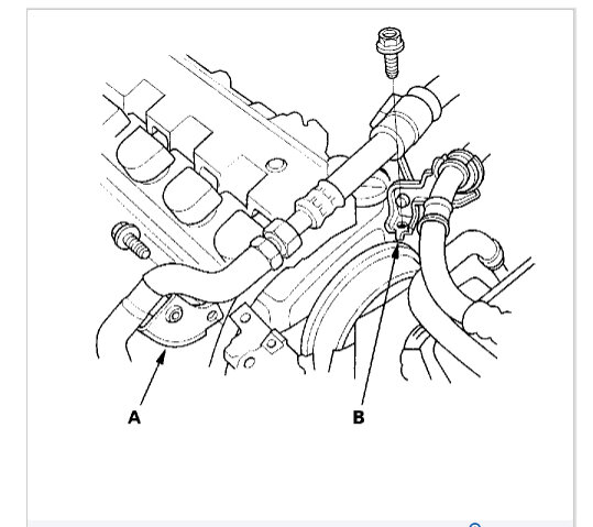

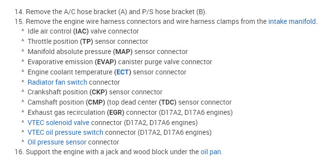

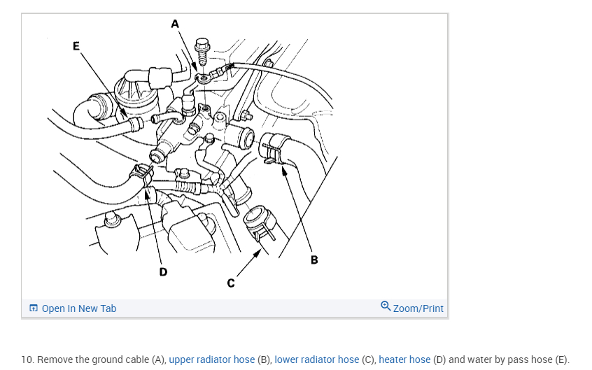

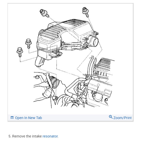

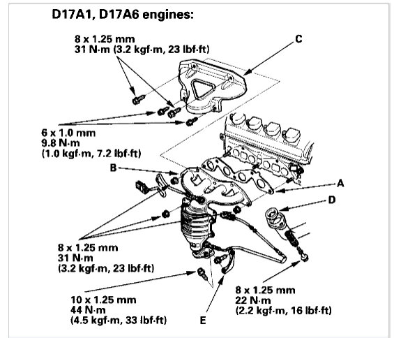

This is somewhat of a big job. LOL Also, please confirm this is a 1.7L engine. You indicated it as a 1.6L, and there is nothing like that for this model year.

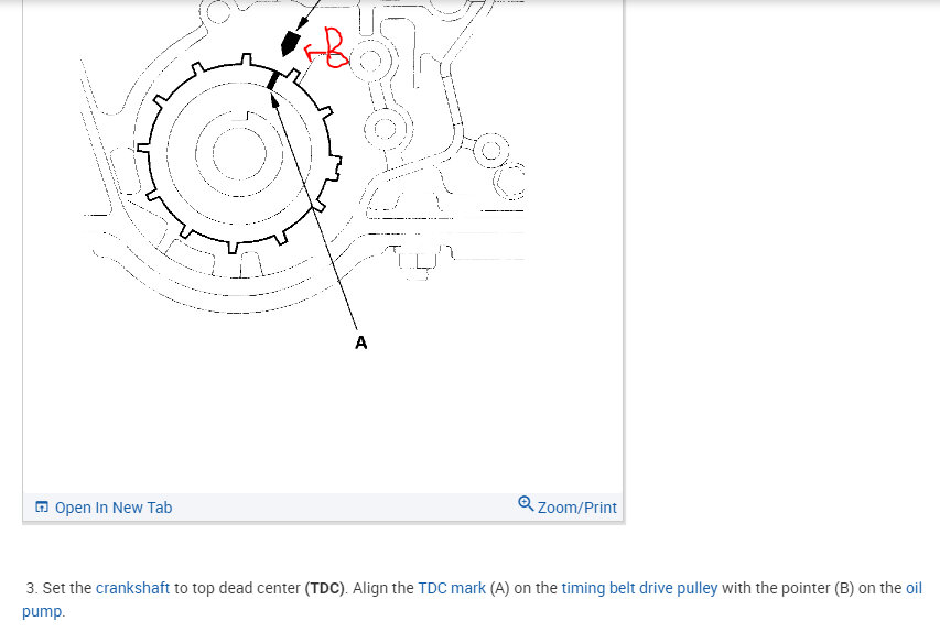

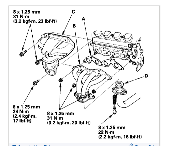

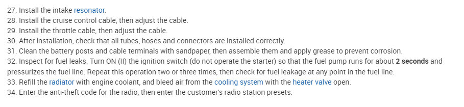

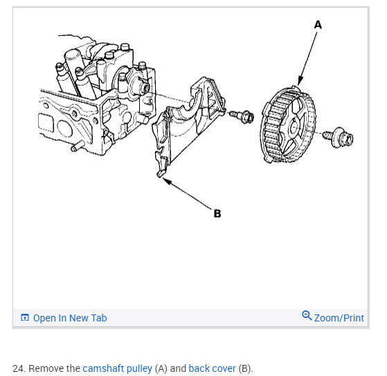

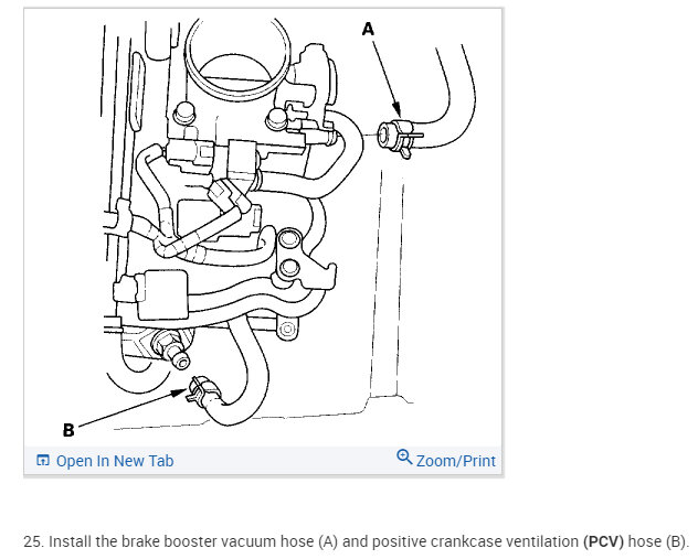

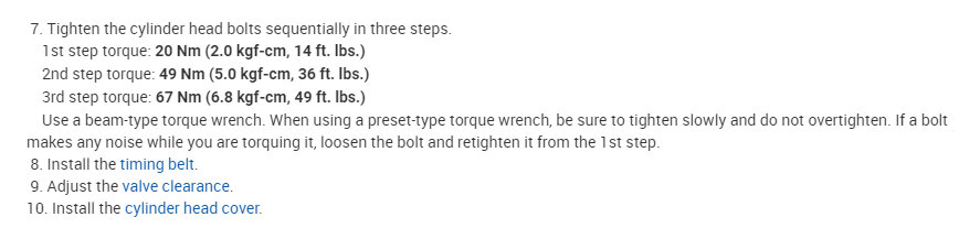

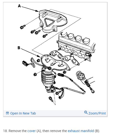

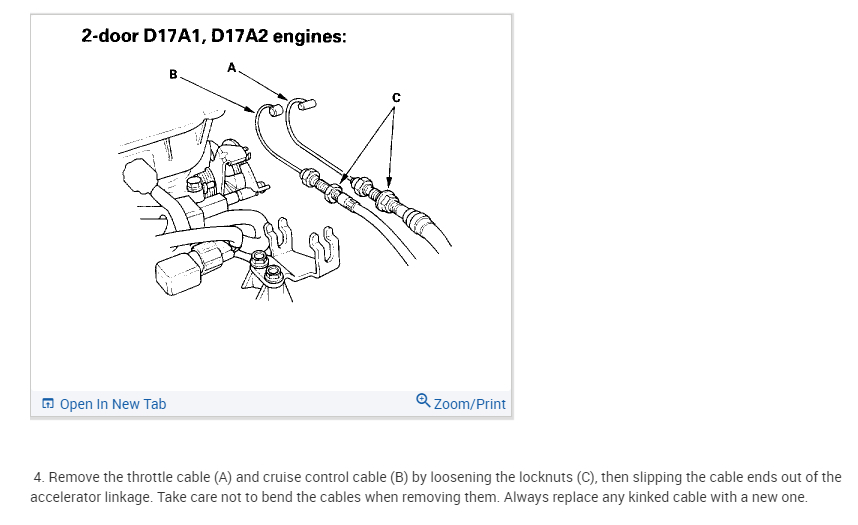

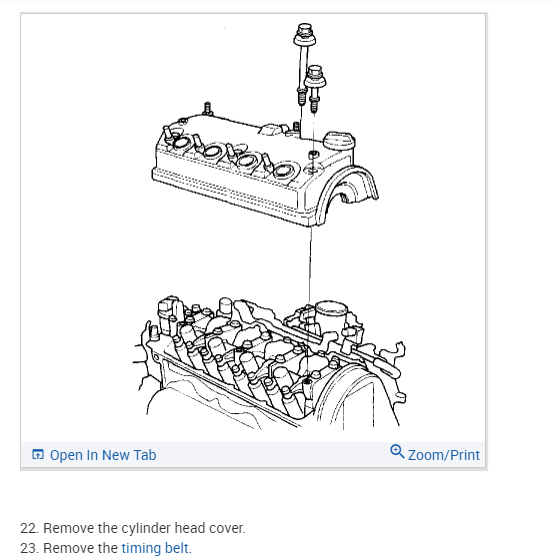

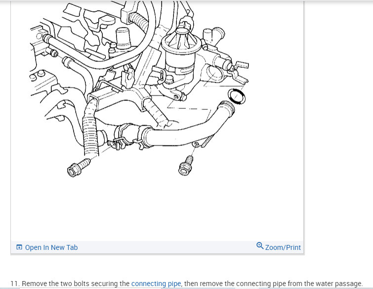

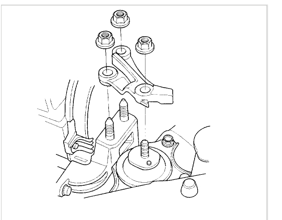

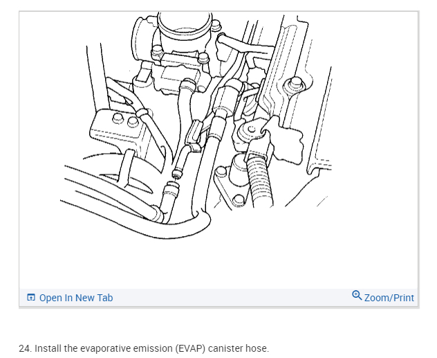

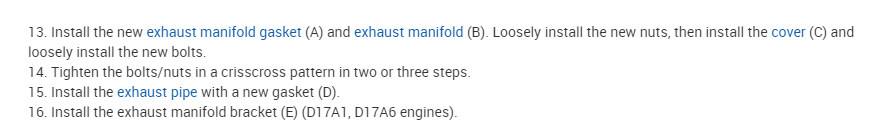

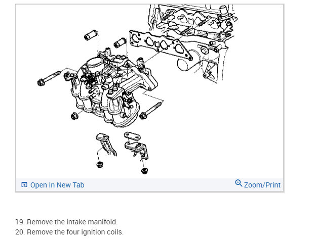

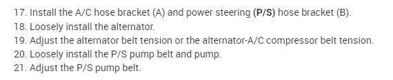

Regardless, if you look below, I attached the removal and installation directions for the cylinder head. When you do this, make sure the timing belt is set properly. This is an interference engine. If the timing is off, it can cause internal damage.
The directions include the torque specs as well. If you need help with the timing belt, let me know.
Take care and let me know if this helps.
