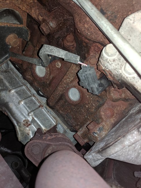

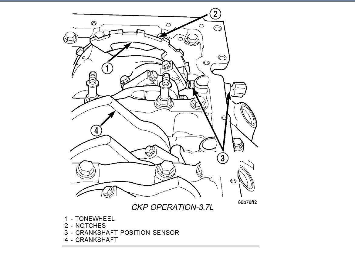

Is this my crankshaft sensor
2005 JEEP LIBERTY
163,000 MILES • 3.7L • 6 CYL • 4WD • AUTOMATIC
CASMIHOK
  • 205 POSTS
Rear right of engine.
Thank you guys, God bless.
Dec 8, 2019 at 1:31 PM
SCGRANTURISMO
  • 4,897 POSTS

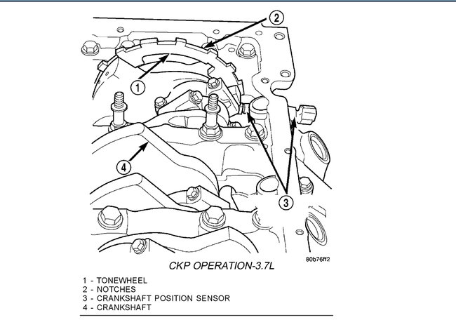

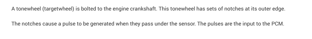

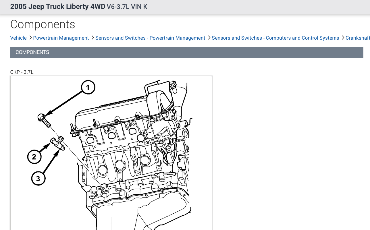

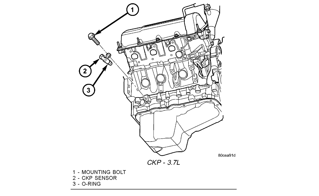

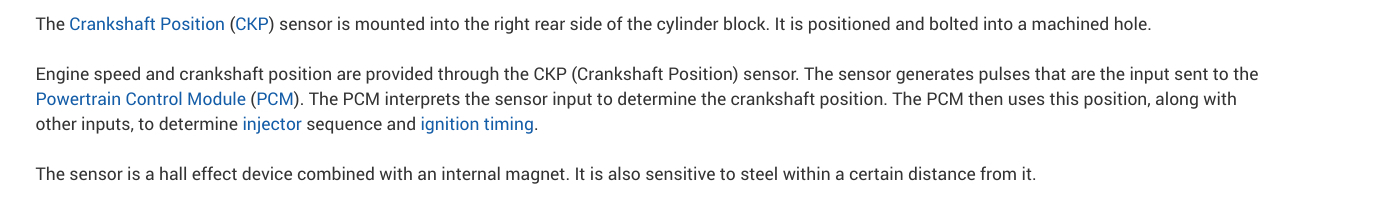

Yes it is. Here is a link below explaining how to remove and install a Crankshaft Position Sensor [CKP] in a vehicle:
And in the diagrams down below, I have included a description, location, and instructions for the removal and installation of the CKP on your vehicle. Please go through these guides and get back to us with how everything turns out.
