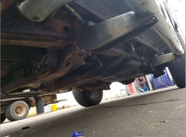

Is this frame rust a problem
35,000 MILES
OHHELP
This vehicle is from the WI. Looks like road salt is serious. Should I be concerned with buying this? Thanks.
Jul 13, 2017 at 12:12 AM
STEVE W.
  • 15,418 POSTS
It depends on how bad the rust really is and where it is. If it is just on the surface and can be scrubbed off to good steel, I would clean it up and use fluid film, Krown or Waxoyl to coat the parts and slow it down. If it is thick flaky stuff that takes large chunks off when you hit it, I would pass unless you want to do repairs on it. Rust is not fun to repair.
