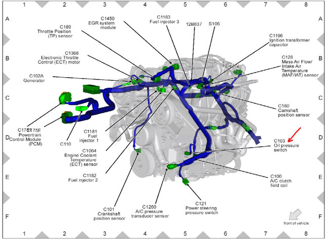

I found this sensor that when I unplug it my 5v reference goes back to normal so I’m looking into finding a replacement switch I just can’t find one anywhere. The connector has 2 wires, and I believe it’s an oil pressure sensor but the ones I’m finding as replacements are all 1 terminal. Is this not an oil pressure sensor? It’s on the driver side bottom of the engine under the power steering pump. It’s not letting me upload images or videos. Anyone know of an oil pressure sensor with 2 wires? One wire looks grey and red, and the next wire looks yellow and light green.

This is the sensor.

Yes, that is the oil pressure sender. Check out the images (below). Let us know if you need anything else.
