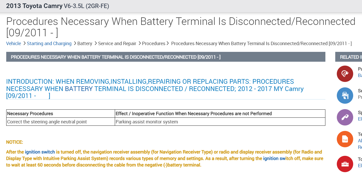

Thanks for your response, Ken. What is my next step if car-to-car jump doesn't work? Battery charger, or instead, can I use one of the smaller, quicker lithium-ion packs to bring a discharged car battery back?
Dec 15, 2022 at 9:52 PM
  • 54,837 POSTS
If a car-to-car jump doesn't work replace the battery with a new unit. Here are the instructions in the diagrams below with a generic guide to show you step by step what to do:
https://www.2carpros.com/articles/how-to-replace-a-car-battery
