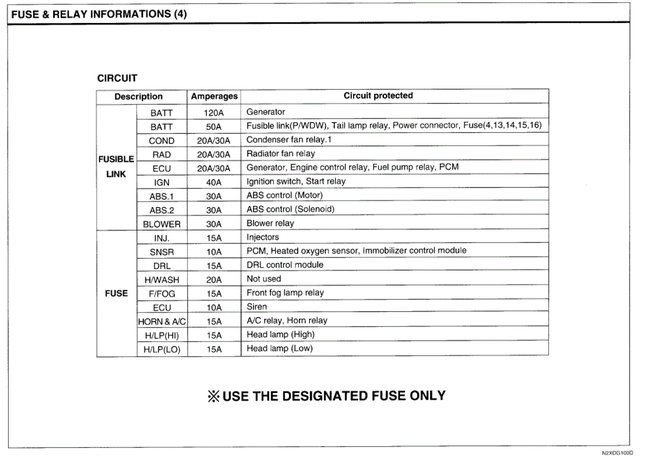

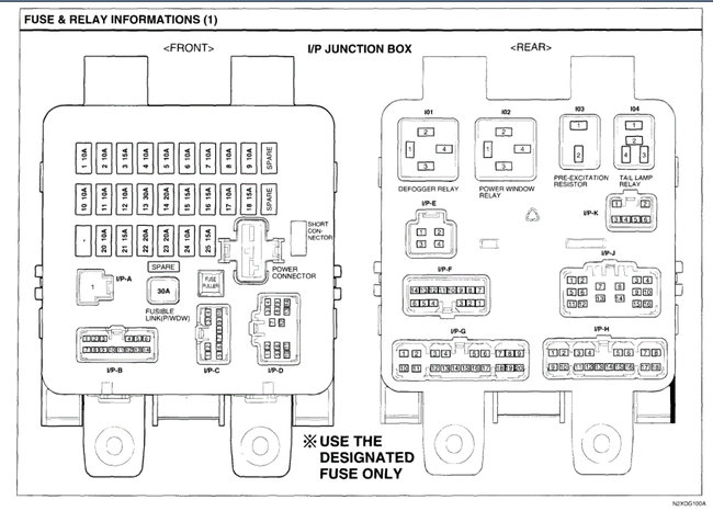

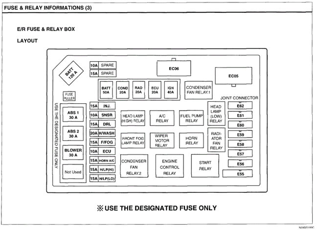

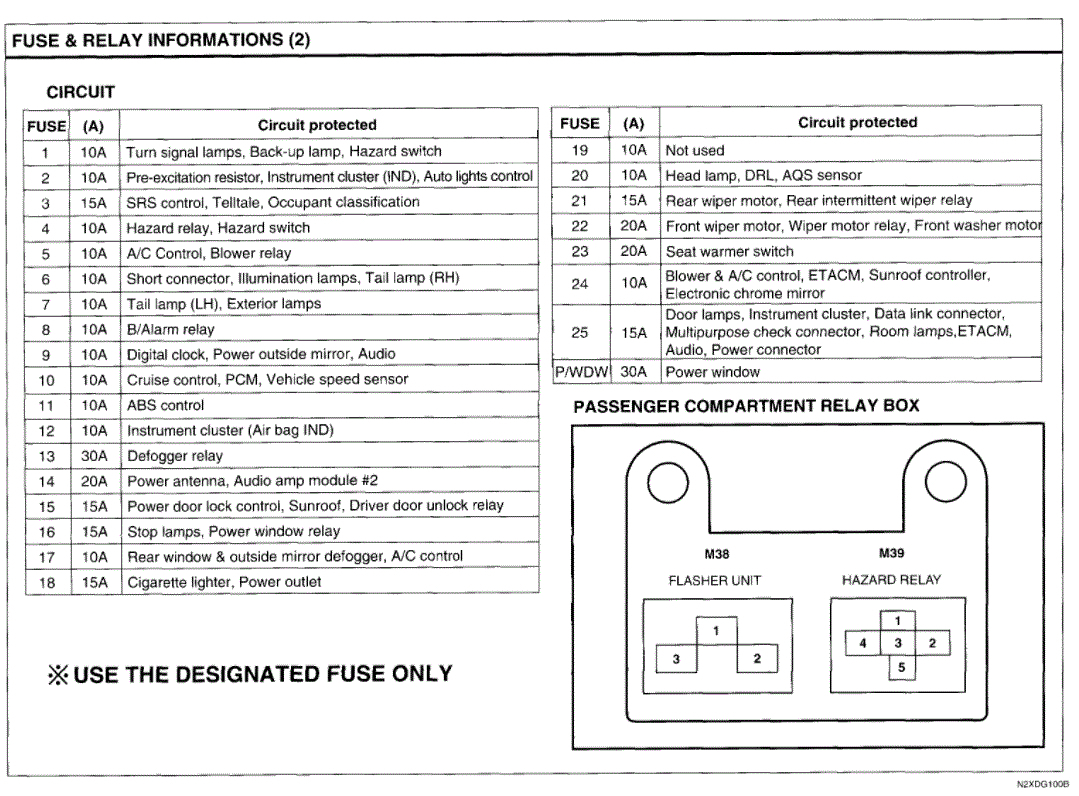

check the fuses?
2006 HYUNDAI ELANTRA
15,000 MILES
TBARB22844
If so can you tell me how to check the fuses where are they?
Apr 23, 2013 at 10:17 AM
  • 110,240 POSTS
If you look at the attachments below, they provide the fuse box orientations and what each fuse is for.
In addition to just checking a fuse, make sure there is power to it. A fuse may be good and not be receiving power.
Here is a link that you may find helpful when testing:
I hope this helps. Let me know if you have additional questions.
