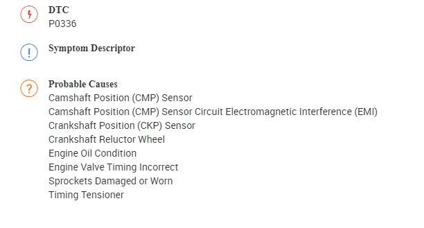

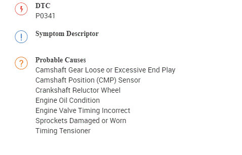

What were all the code numbers? Codes rarely identify bad parts, just failed systems.
https://www.2carpros.com/articles/how-camshaft-variable-valve-timing-works
The fact you have both cam and crank sensor codes, it indicates to me a timing issue between the valves and the piston.
https://www.2carpros.com/articles/how-a-crank-shaft-angle-sensor-works
https://www.2carpros.com/articles/camshaft-angle-sensor-replacement
I would start with a compression test as I think you have a bad timing chain.

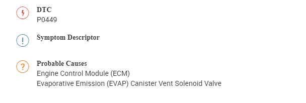

The codes that I have had so far, if I remember correctly, we're P0449, U0073, P0339, P0336, P0341. (Not in any specific order) I can't do the compression test though because the engine won't turn over. It hard chugs as it tries to start, but won't turn over. It sounds like the timing is off.

  • 52,797 POSTS
You are welcome.
Yep, that is what happens when the chain moves.
Remove the spark plugs and see if it cranks over.
I attached the code possibilities for you. The 2 codes have the timing chain in common.
There is no 339. Can you verify?
