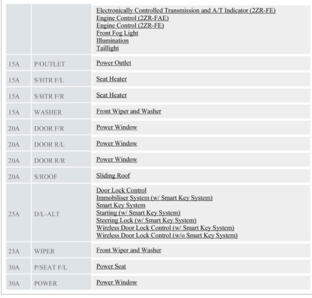

Is there a way to reset the fuel guage
2016 TOYOTA COROLLA
47,000 MILES
SEAN123456

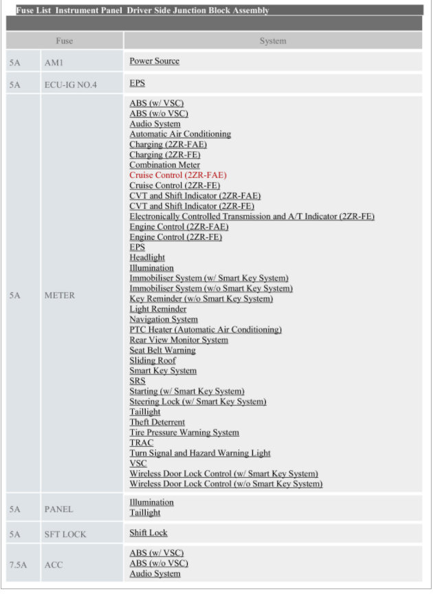

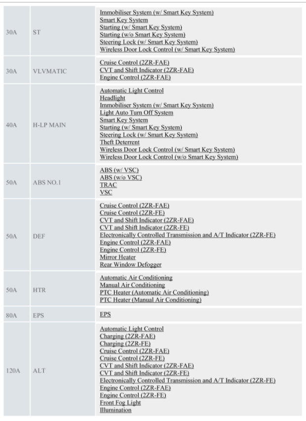

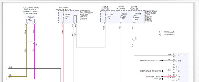

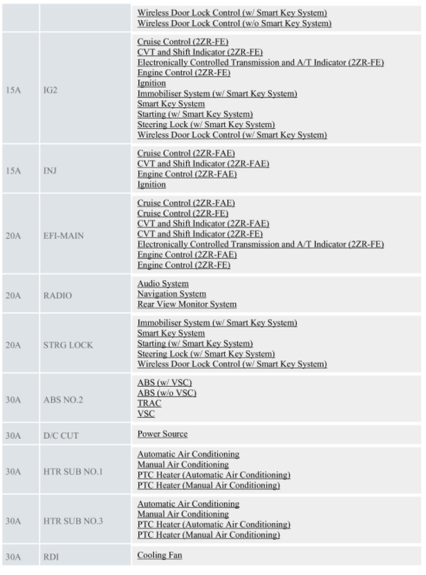

I reset the maintenance required light on my car and when I did that something went wrong with the fuel gauge. Before I reset it my car said it had just under a half a tank of gas and said I had 118 miles to empty. now it is saying I have 8 miles and the fuel gauge is on empty.
Nov 19, 2019 at 6:39 AM
  • 55,399 POSTS

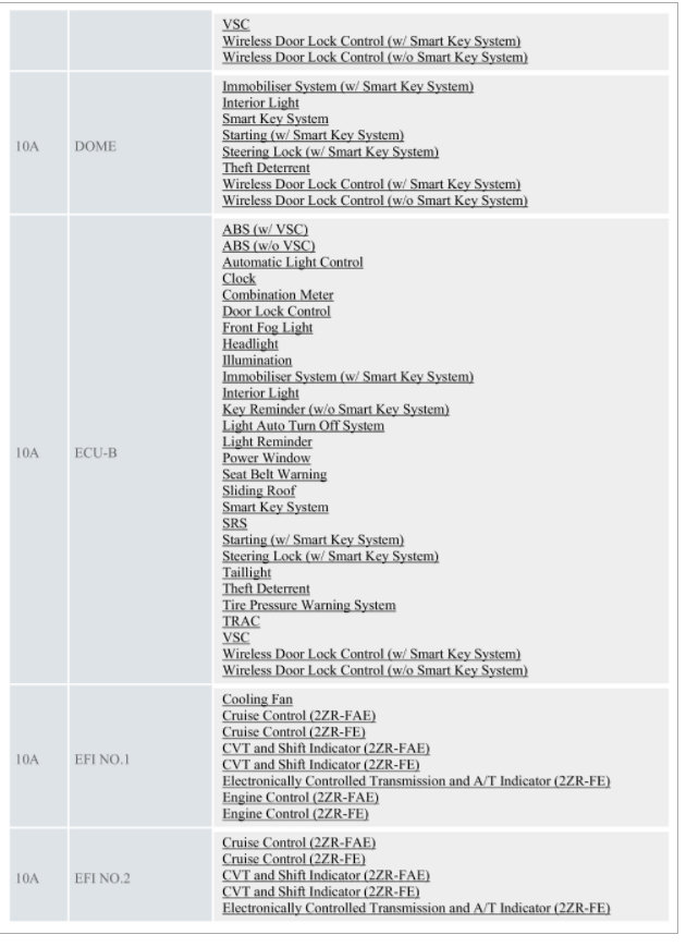

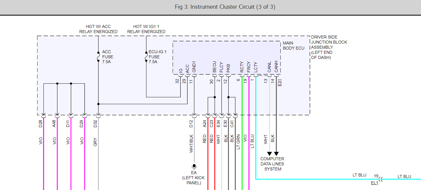

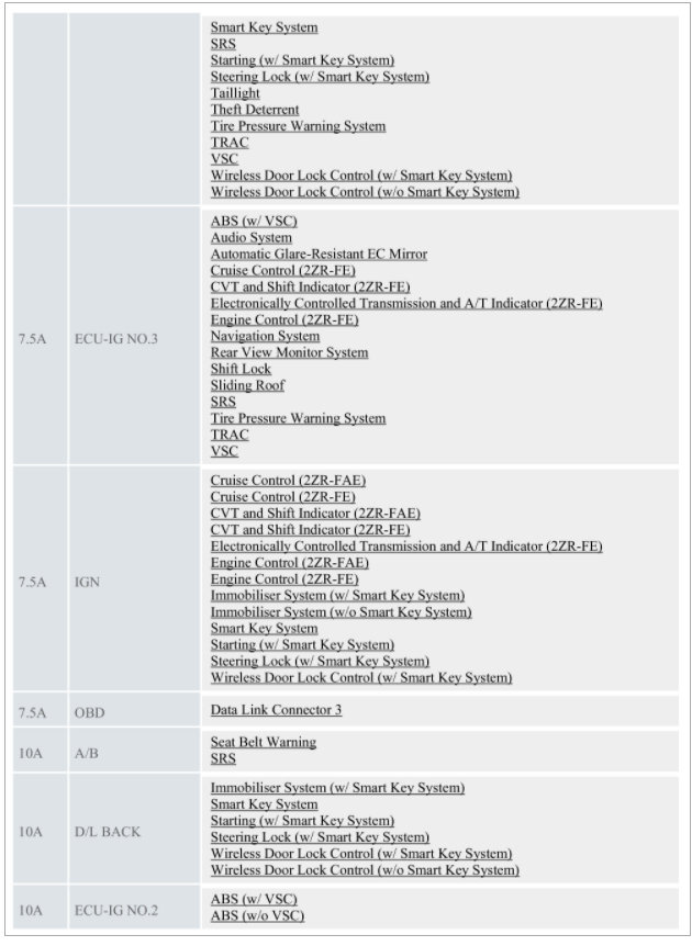

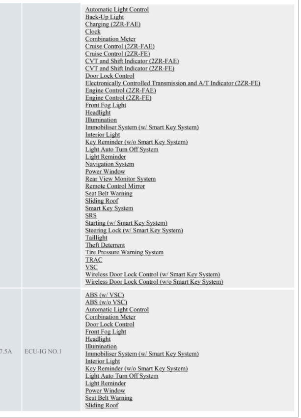

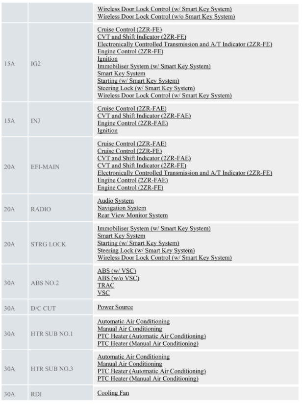

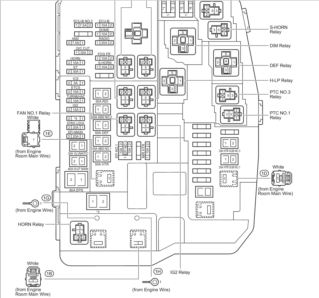

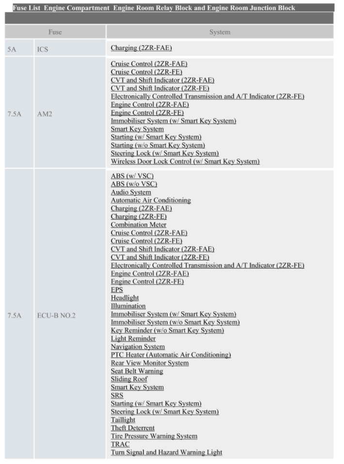

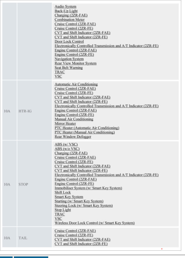

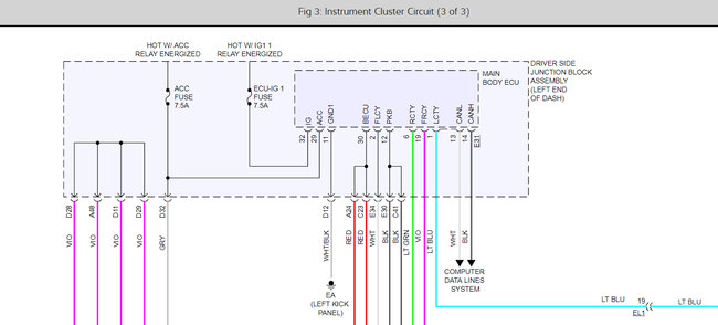

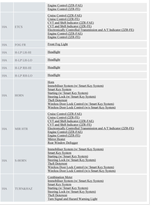

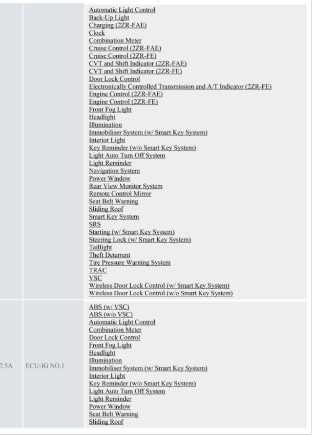

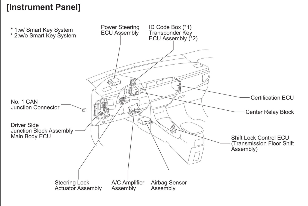

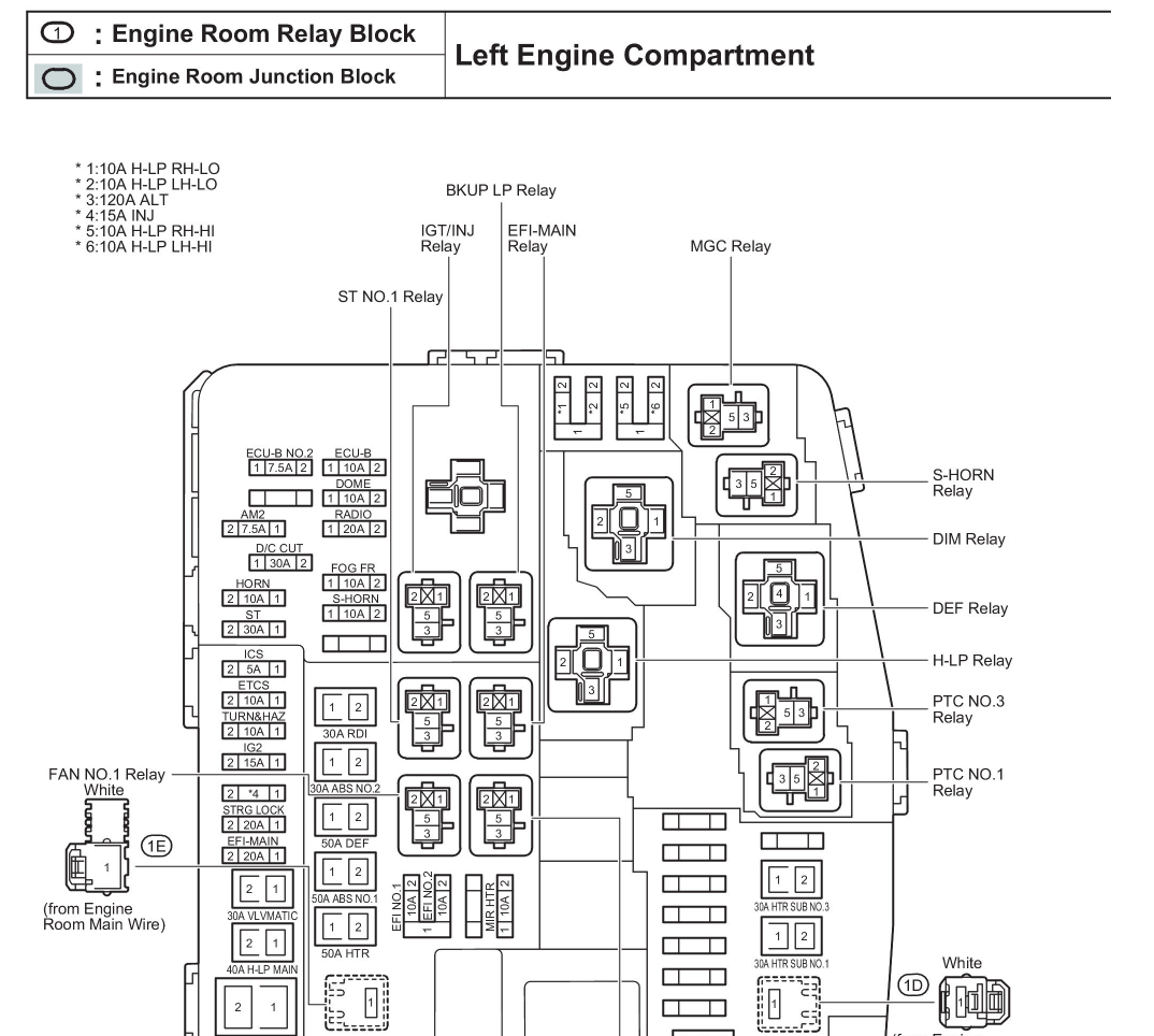

There are 6 fuses that run the instrument cluster. here is a guide to help check them and the cluster wiring which shows which fuses to check with the fuse locations in the diagrams below:
Nov 20, 2019 at 12:15 PM
