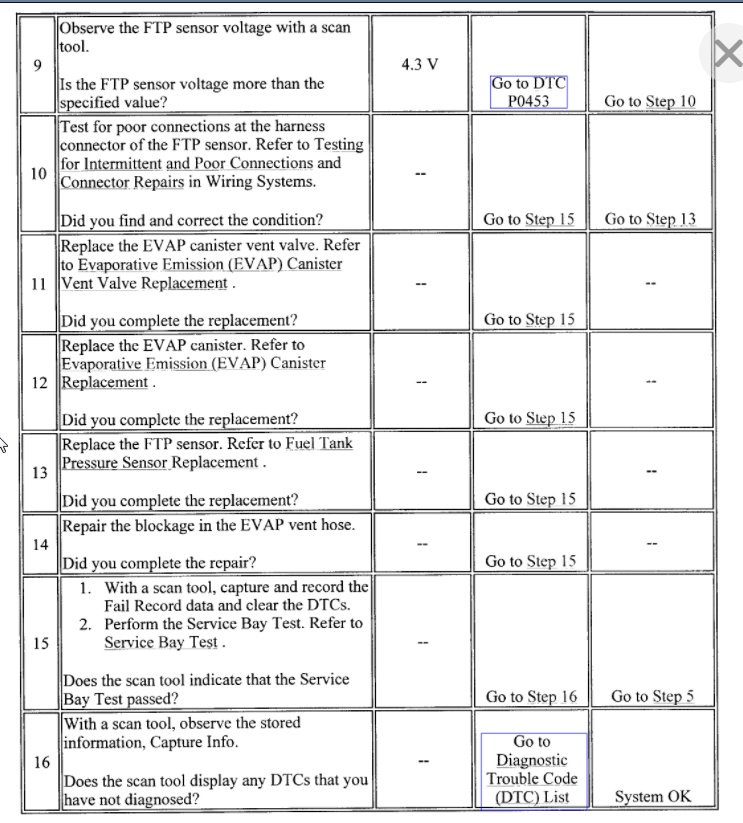

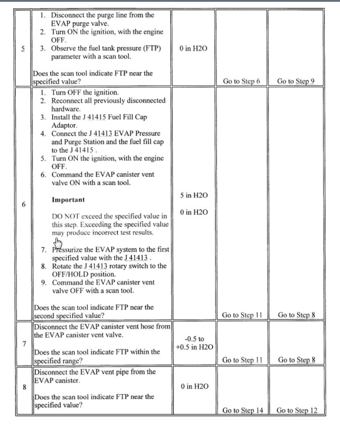

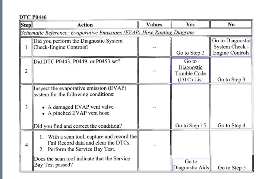

I have no codes relating to 02 and the heated 02 passes, but not the regular 02 sensor. The EVAP is failing as well codes p0449 and p0446 (no service engine light though,yet). EVAP has failed before without causing other things to fail or not complete.
Nov 6, 2019 at 3:18 AM

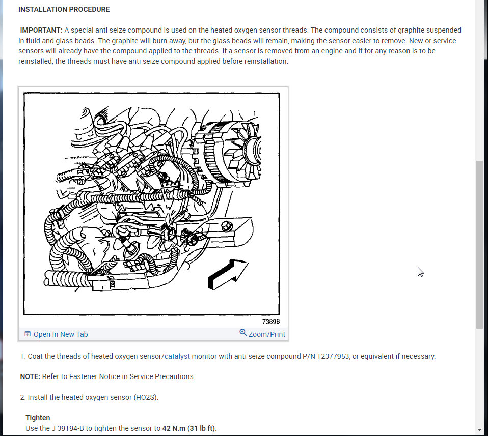

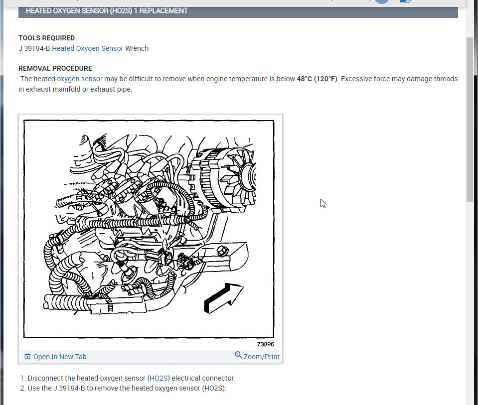

This could be a couple of things. First and foremost it could be the o2 sensors, purge valve or a couple other items as well.
I attached the testing that we need to run through in order to figure this out for sure.
Here are some guides that will help with this:
https://www.2carpros.com/articles/how-to-test-an-oxygen-sensor-02-sensor
https://www.2carpros.com/articles/how-to-replace-an-oxygen-sensor
However, I also attached the instructions on how to replace the o2 sensors as you requested.
Run through this material below and let us know if you have questions.

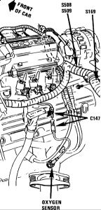

Can some one please tell me where the oxygen sensor is located
Feb 15, 2021 at 1:59 AM (Merged)
  • 75,992 POSTS
1991 Buick Century V6-204 3.3L VIN N FI RH Rear Of Engine.
https://images.2carpros.com/forum/automotive_pictures/12900_os_1.jpg
Bottom Rear Of Engine, On Exhaust Manifold
