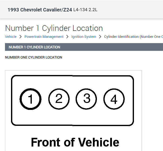

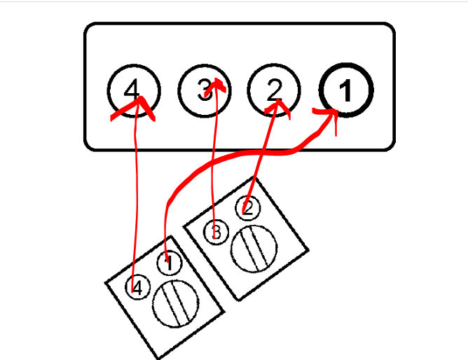

Change the spark plug wires and pretty sure we have the sequence right 1342 but the car won't start.
Tuesday, September 3rd, 2024 AT 7:02 PM
MECHANIC
110,176 POSTS
You are correct. If you stand at the front of the vehicle, the cylinders are (from left to right) 1, 2, 3, and 4. See pics below.
Also, the firing order is 1, 3, 4, 2.
Let me know if there is anything I can help with.
