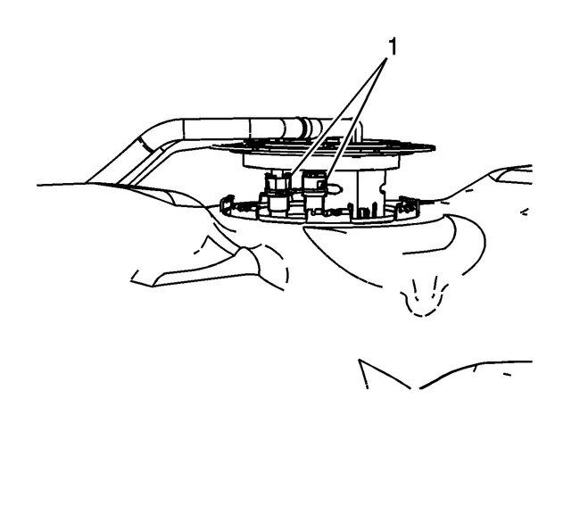

3. Slowly lift the fuel pump flange up until the quick connect fittings (1) and fuel level sensor electrical connector are just visible.
4. Disconnect the fuel level sensor electrical connector from the fuel pump flange.
5. Disconnect the fuel tank vent valve and the fuel filter quick connect fittings (1) from the fuel pump flange.

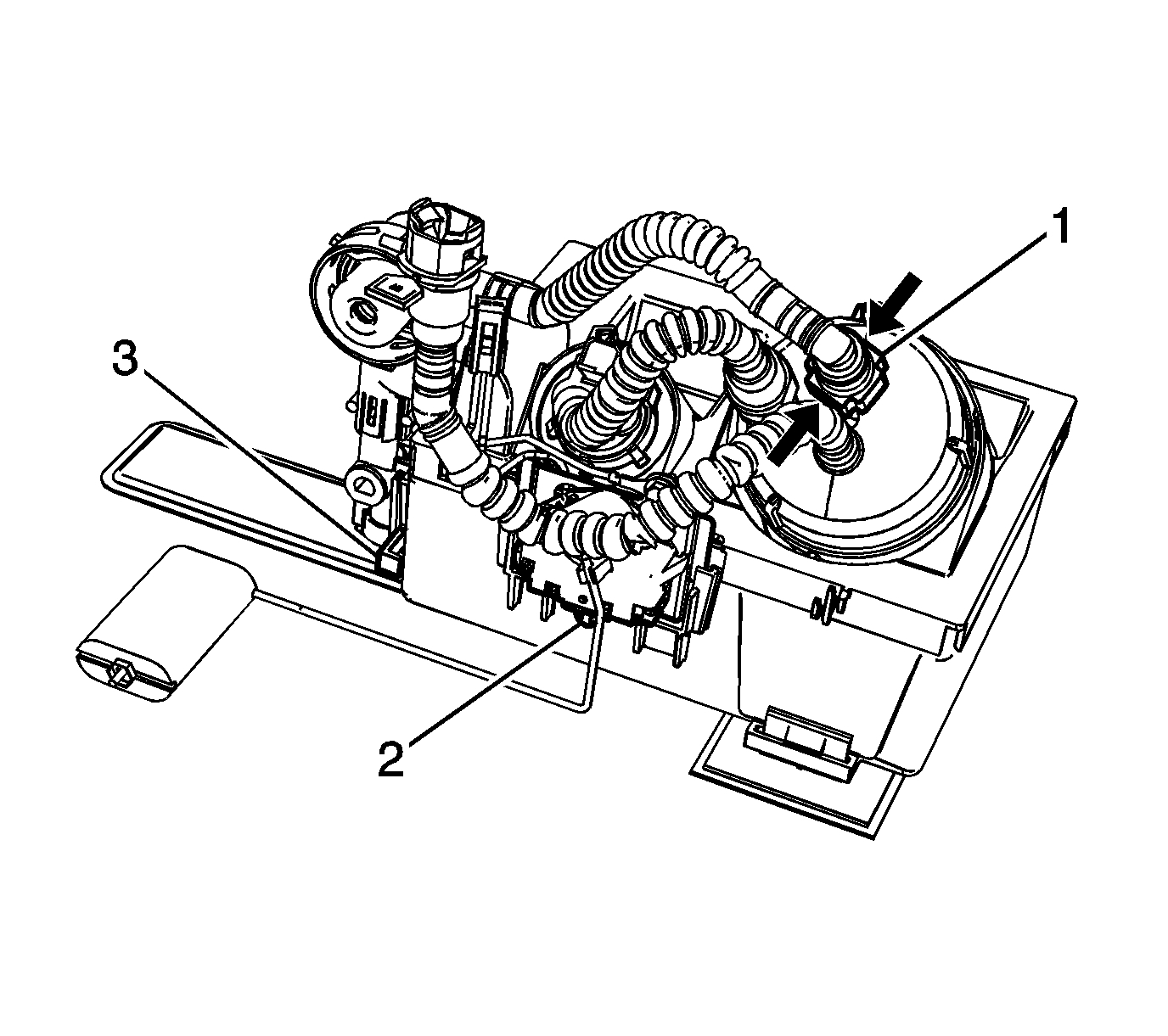

6. Remove the fuel pump flange lock ring (1) and fuel pump flange (2). If required, remove the lock ring from the flange.
7. Remove and discard the fuel pump flange seal (3).

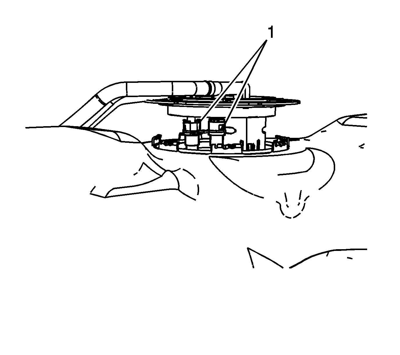

8. Squeeze the sides of the fuel pump fuel reservoir pump fuel strainer quick connect fitting together (1) in order to remove the fitting from the fuel filter. Refer to Quick Connect Fitting Service - Plastic Collar.
9. Reposition the fuel pump fuel reservoir pump fuel strainer line.

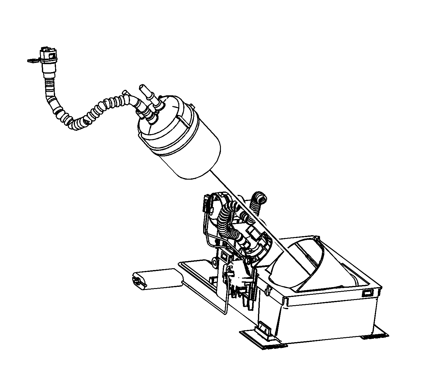

10. Squeeze the fuel pump quick connect fitting retainer (3) together in order to remove the fitting from the fuel filter. Refer to Quick Connect Fitting Service - Plastic Collar.
11. Reposition the fuel pump line.
12. Rotate the fuel filter to the left until the tab (2) is aligned with the opening in the fuel pump module.

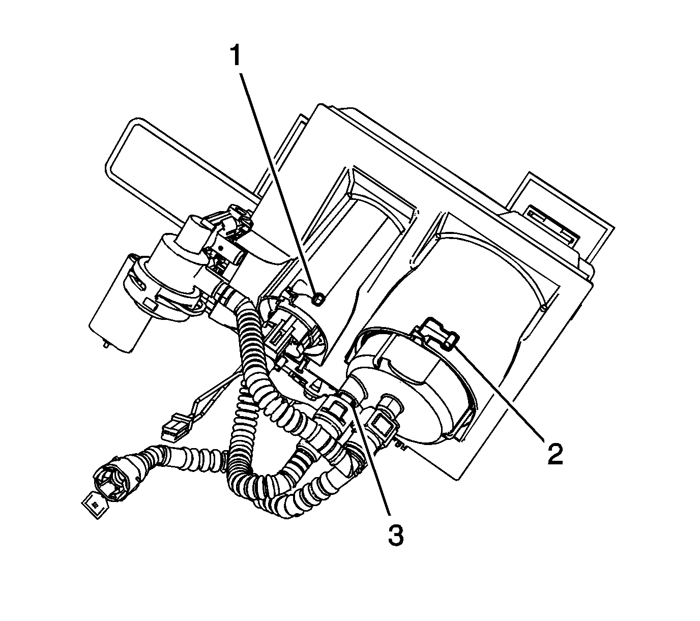

13. Remove the fuel filter from the fuel pump module.

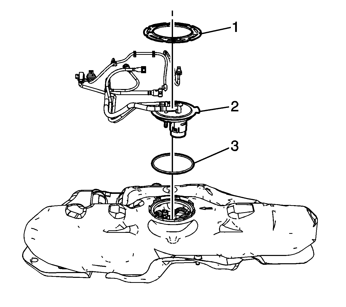

1. Align the fuel filter tab with the opening in the fuel pump module.
2. Install the fuel filter to the fuel pump module.

8. Position a NEW fuel pump flange seal (3) onto the fuel tank.
9. If required, install the lock ring onto the flange. Position the fuel pump flange (2) and lock ring (1) over the fuel tank opening.
10. Ensure that the fuel pump flange tab is aligned with the arrow on the fuel tank.
