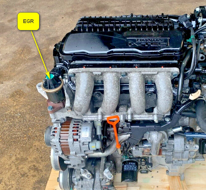

Another possible issue could be a sticking EGR valve, see image 2 below
This is a common issue which can cause the engine to stall at idle
How to remove and clean:
https://youtu.be/e-PzkoGhv0M?si=tS-xsHEEQ3RUMYsN
