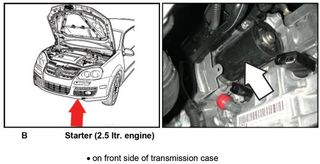

I have the car listed above Wolfsburg with a slow oil pan/valve gasket leak (getting my oil changed regularly has been keeping my oil levels at appropriate levels). The last couple of days, I experienced rough start/clicking when starting the ignition. My battery is about two years old, so I was thinking alternator or starter. Had the battery tested and it had a 10.55 volt reading. To make a long story short, both the starter and alternator passed diagnostics and the battery result was "bad." The battery was replaced through the warranty I purchased. My question is, is the starter in my car in a location where it could soak up oil from the kind of leak that I have? Would it still pass the diagnostic if it malfunctioned as a result of exposure to oil? And if the starter did malfunction as a result of being exposed to an oil leak could that make a battery read as "bad" in a diagnostic test? Just want to be prepared if the new battery I have begins to fail.

The starter bolts to the transmission bell housing, but the starter itself sits along side of the engine at aproximately oil pan height. I attached a picture of its location for you to see.
As far as your questions, yes it is in a location where it can get oil on it. However, I doubt that is going to cause the problem you experienced. Honestly, it sounds like a bad battery. I cannot begin to tell you how many starters are saturated with oil and never have a problem. If it checked good and the alternator checked good, they should be fine. Also, the clicking you described is a typical sound heard when the battery is weak.
Feel free to ask any other questions you may have.
