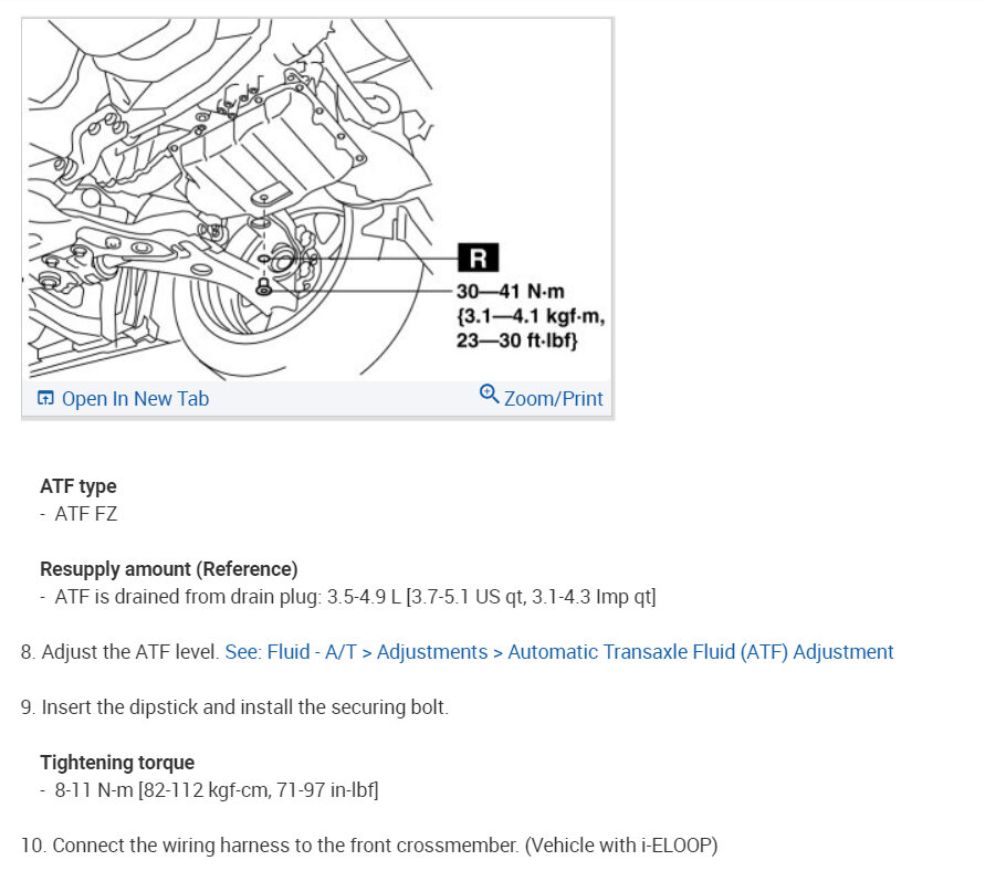

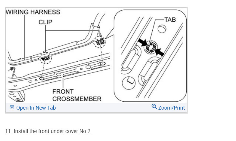

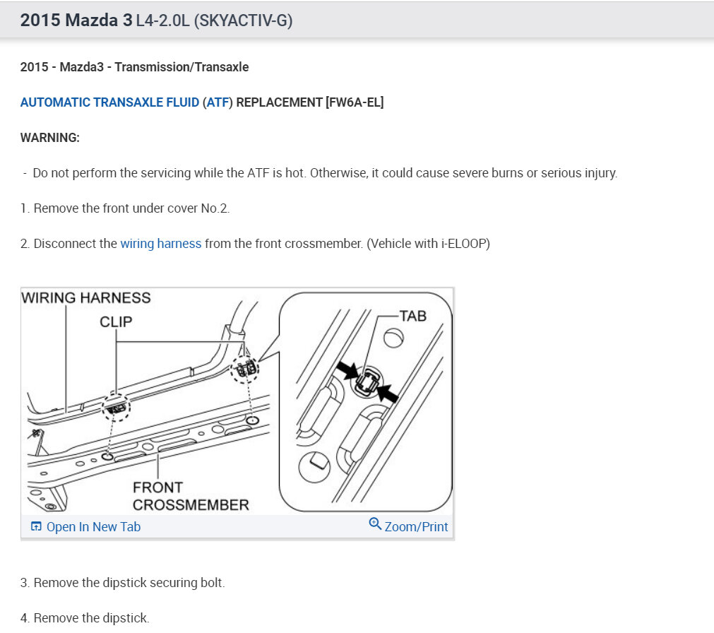

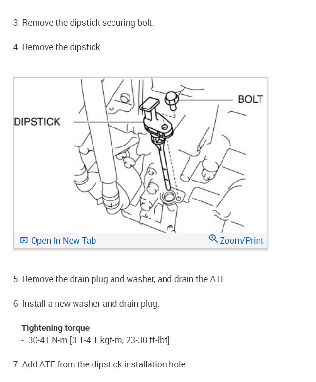

Also, can you check the condition of the transmission fluid please and has it been serviced lately?
Fluid Types
Automatic Transaxle Fluid
Type .................... Mazda Genuine ATF FZ
Capacities
Capacity .................... 8.2 qt (7.8L)
Check out the images (below). Let us know what happens and please upload pictures or videos of the problem.
