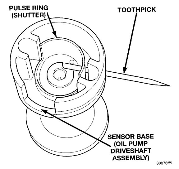

When you replaced the cam sensor, did you just remove the cam sensor itself or did you pull it out with the entire oil pump drive shaft? And when you installed the crank sensor, was there a new paper spacer with the sensor or just the sensor?

First I did the cam it self. Result was same. Then pulled shaft to check teeth looked good to me. Put it TDC and installed shaft pin holes lined up. Yes there was spacer on CPS.

If you turned the engine over before installing the oil pump gear then CMP sensor relationship must be reestablished. Here is the procedure. You will need a scan tool also to see if it is sync or not.
Temporarily install a toothpick or similar tool through access hole at side of oil pump drive housing. Align toothpick into mating hole on pulse ring.
Install oil pump drive into engine while aligning into slot on oil pump. Rotate oil pump drive back to its original position and install hold-down clamp and bolt. Finger tighten bolt. Do not do a final tightening of bolt at this time.

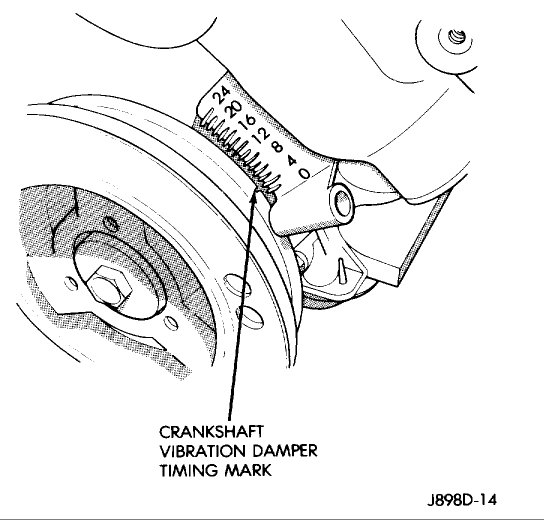

Hold a finger over the open spark plug hole. Rotate engine at vibration dampener bolt until compression (pressure) is felt.
Slowly continue to rotate engine. Do this until timing index mark on vibration damper pulley aligns with top dead center (TDC) mark (0 degree ) on timing degree scale. Always rotate engine in direction of normal rotation. Do not rotate engine backward to align timing marks
Install oil pump drive into engine while aligning into slot on oil pump. If pump drive will not drop down flush to engine block, the oil pump slot is not aligned. Remove oil pump drive and align slot in oil pump to shaft at bottom of drive. Install into engine. Rotate oil pump drive back to its original position and install hold-down clamp and bolt. Finger tighten bolt. Do not do a final tightening of bolt at this time.
Remove toothpick from housing.
Install sensor to oil pump drive. After installation, the CMP sensor should face rear of engine 0°.
Install 2 sensor mounting bolts and tighten to 2 Nm (15 in. Lbs.) Torque.
Connect electrical connector to CMP sensor.
If removed, install spark plug and ignition coil rail.

I cannot zero it due to stalling. But I did TDC before removing it and marked it so it was same place.
