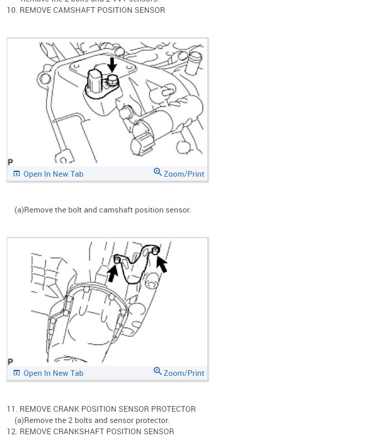

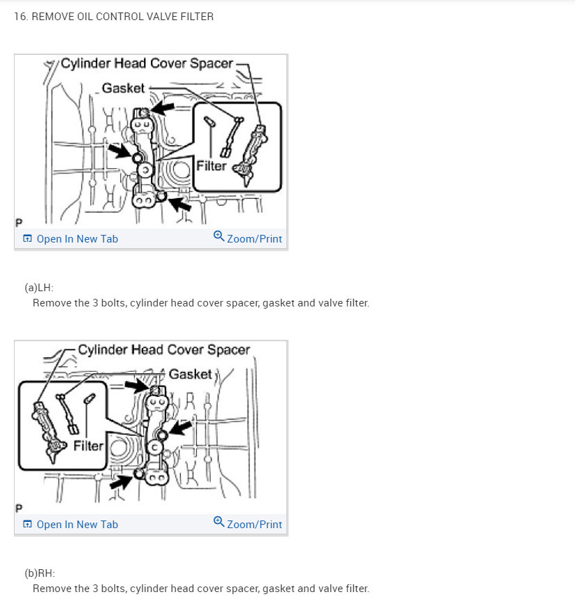

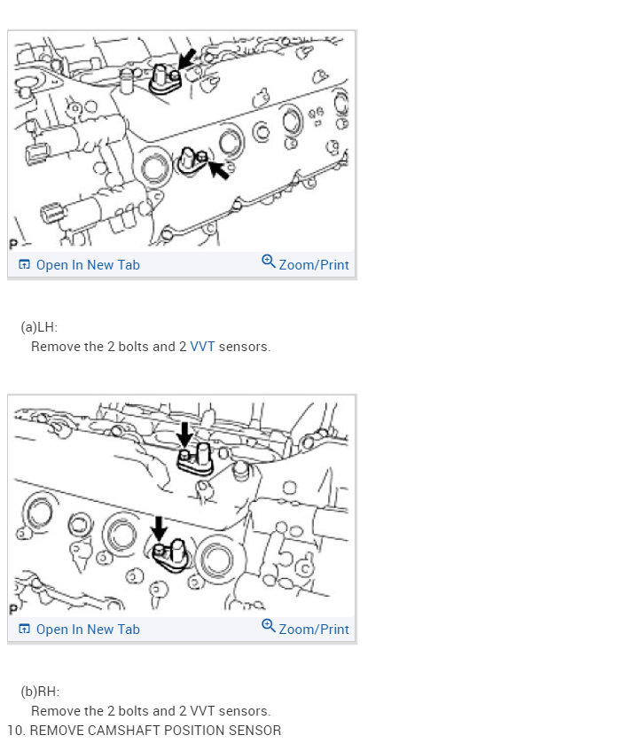

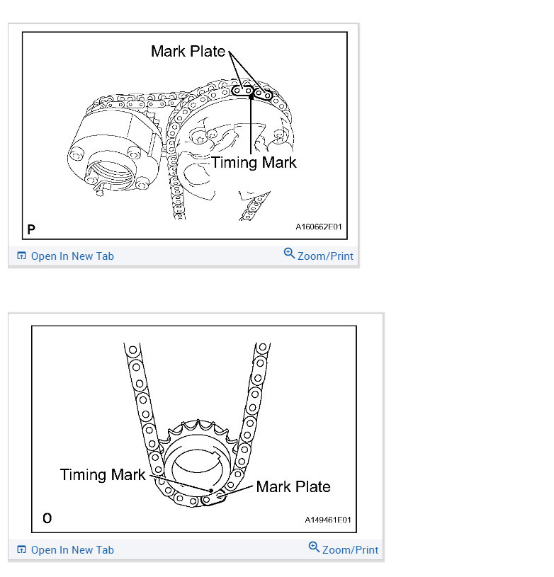

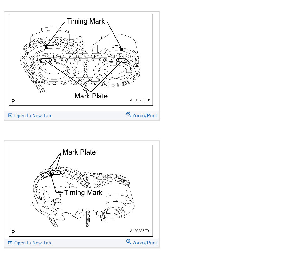

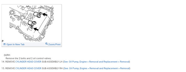

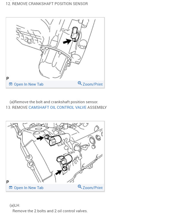

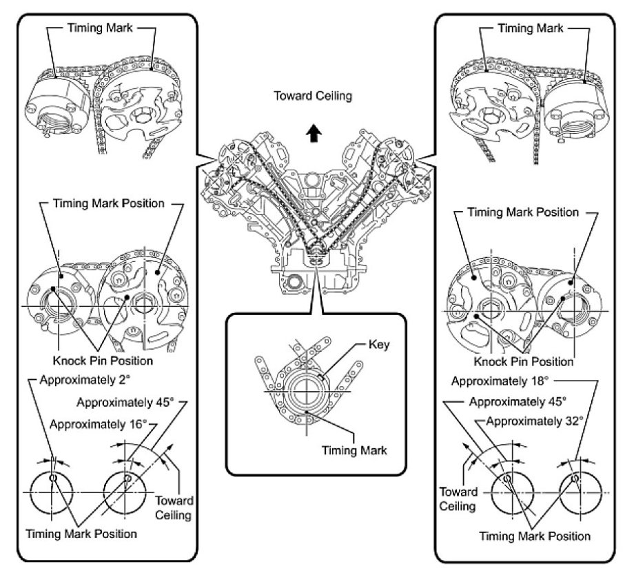

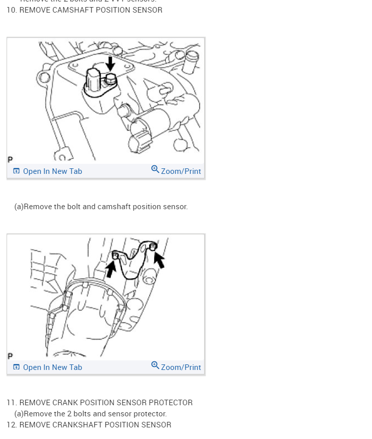

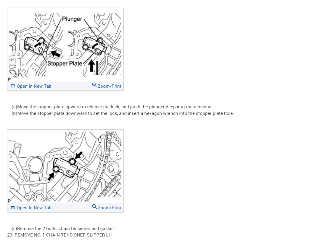

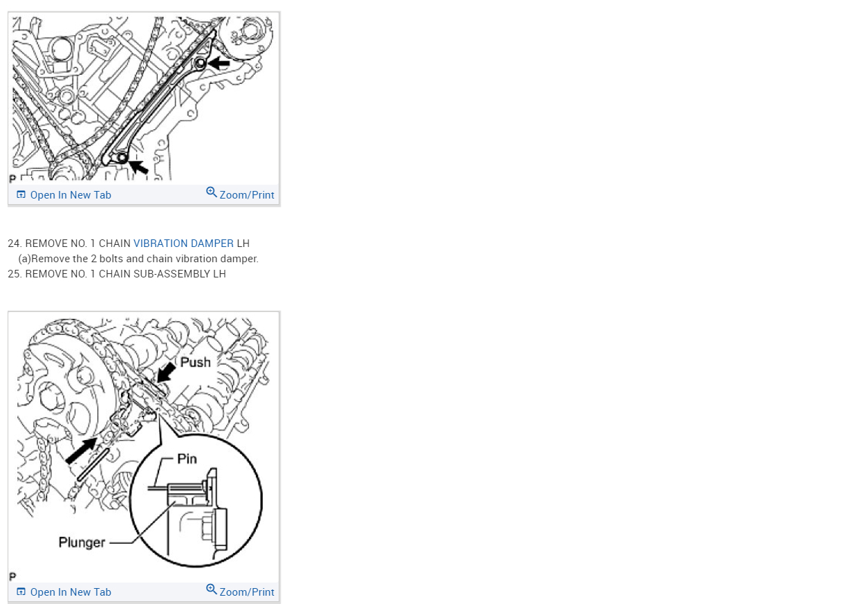

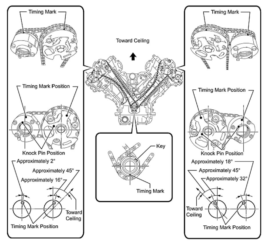

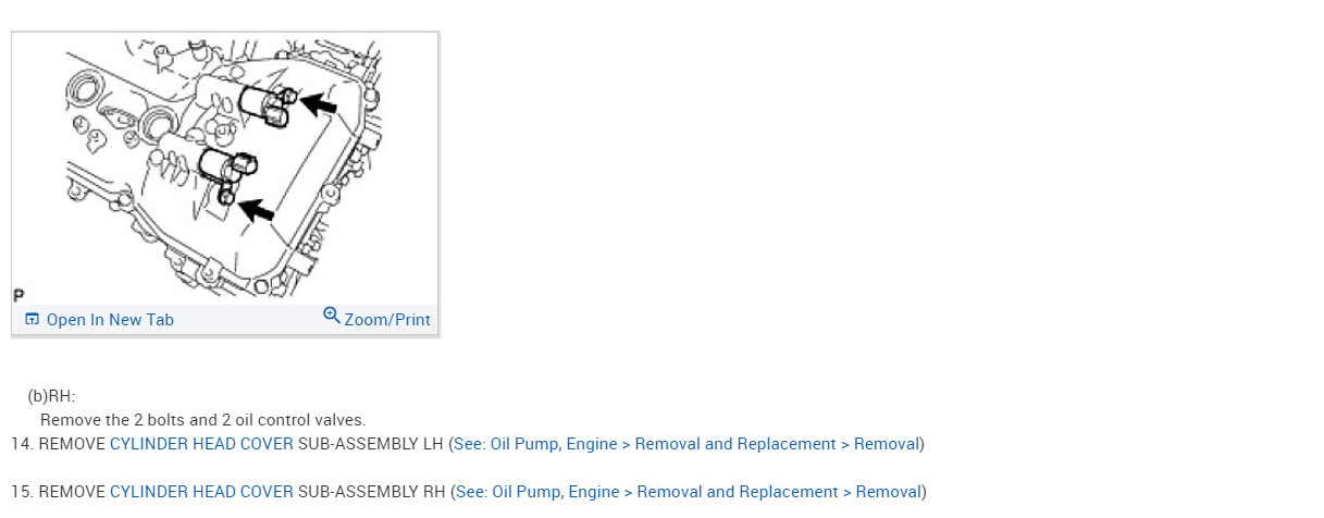

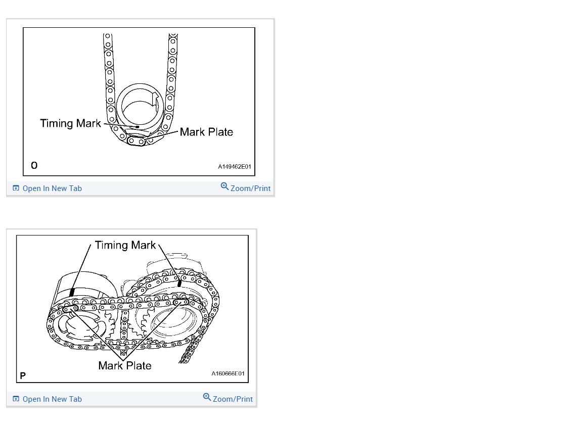

So sorry to hear about that, I would be crying too. I'm looking up info for you right now, I think you're correct if you have plastic in the oil pan, sounds like chain guides to me, same thing as the bigger Ford engines does, but they all do it. This is a huge job for this timing chains, just by the little information I've seen already. It has four timing chains, two long ones that go to each cam and then two short ones that run from cam to cam. Yeah, the valve covers have to come off, but you have to be careful, in each valve cover there are two VVT sensors, a camshaft position sensor, and two oil control valves. I'll post what I have below, but I'm limited on resources this week, it seems the Mitchell database is down. But I'll do my best to find whatever I can. I was told it is an Interference Engine unfortunately. With the valve covers off you will get a better look at things. Do you have a picture of the plastic pieces that came out? I'd be interested to see if it's guides. Honestly I'm kind of surprised. Toyota in my opinion is one of the best brands, Tundra is my favorite truck actually.

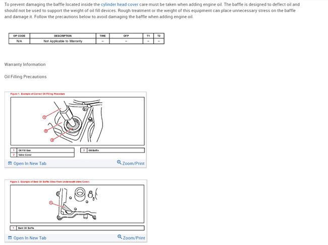

As you can see in the first diagram, it's a crazy chain set up. There is also a TSB on being careful not to damage the baffles inside the valve covers when removing them, I guess they are pretty fragile. Diagram seven shows there are some type of valve cover spacers with a small valve filter.
The bottom (last three diagrams are the timing marks and chain links. Though I'm not sure how this is going to go if you can't turn the engine over by hand. The 10th diagram shows the a view from the back of the valve sprockets and the chain link marks back there.
11 and 12 are the main longer chain tensioners and then the two short cam to cam chains also have tensioners in between the two cam gears. So sorry for all this happening. I understand how frustrating this is.

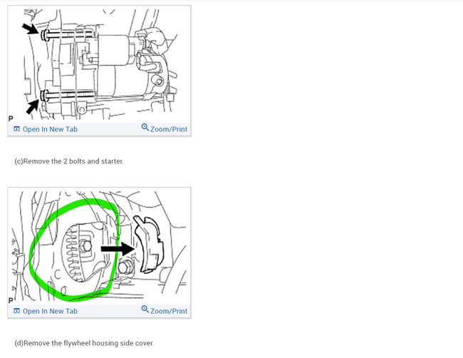

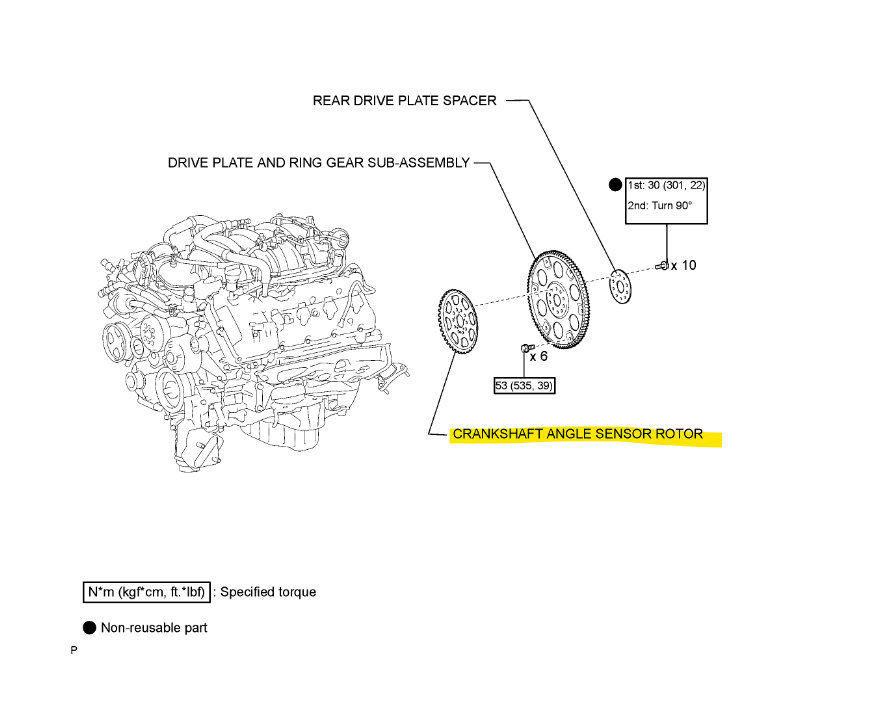

I wouldn't be looking for an engine just yet, because we don't know what really happened here. Is it also possible to get a look at the Flex Plate at the rear of the engine? I believe there is a cover that can come off to get to the Flex Plate and Torque Converter bolts. I wonder if the Flex Plate broke off the end of the crankshaft. I was just going over our first comments, so you did find some kind of plastic chunks in the oil when you drained it correct. As of right now I'm kind of just throwing ideas out there. If you were able to get the oil pan off you might be able to see if a Connecting Rod broke, but since you can't turn the engine over by hand even with the spark plugs out, you'd think it would be an obvious failure. Will the engine rotate backwards just a little bit? And I remember a crankshaft position code. Do you remember what the actual code number was? The diagram below shows the Starter Motor removed and you can see the teeth of the Flex Plate. If you pull the Starter maybe, we can get a look at the Flex Plate. Can you take some pictures of the timing chain setup when you get a minute? I just want to see how far into this you are and if I notice anything. I know you're limited with time, so whenever is okay. I'm here every day, I was really thinking you would have seen a valve stuck in the top of one of the pistons, but since everything seems ok in cylinder, I'm thinking lower end or the flex plate issue. It's very difficult to help when not being at the truck with you. But snap a few pictures of the timing chains and anything else you think is relevant,
One last thing, you have both valve covers off, check up top there. Any of the rocker arms fall off or anything jammed into one of the camshafts? Even with the timing cover removed it still won't turn or have you not tried that yet? The thought of the oil pump seizing up just came to mind, I believe it's part of the timing cover assembly.
This engine just has so many components.
I just came across this diagram too, the Crankshaft Position sensor has its own trigger plate attached to the Flex Plate, I've never seen a design like that before.
