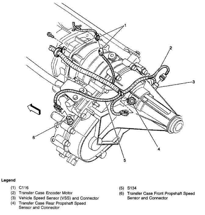

Few days ago went through car wash then vacuum. I started my car put in reverse and it would not move. I noticed my four wheel and two wheel and four auto lights blinking. I put it in neutral and then reverse and car finally moved, but the lights were still flashing. I drove it eight blocks home, it was very hard to turn wheels making turns. parked in garage let sit for three days. I tried starting it letting it warm up and then after warmed up light on two wheel drive was back on like it should be so took for a test drive seemed everything was fine but to afraid to try four wheel or auto four just was glad it was in two wheel drive again. I take very good care of car had computer replaced, transmission replaced, oil lines, brakes all the way around. also, shocks all in last two to three years. I do not know anything about cars. I drive and have serviced when needed.

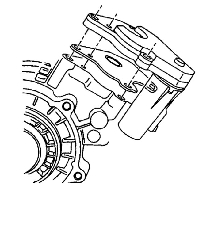

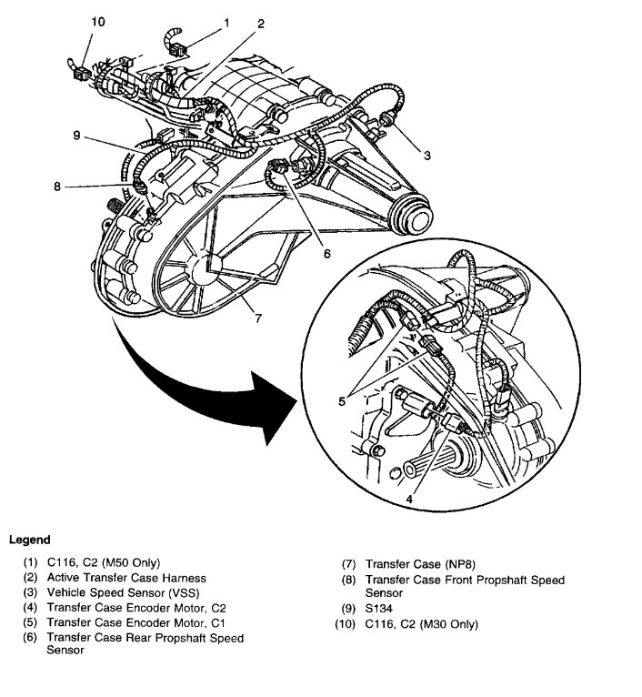

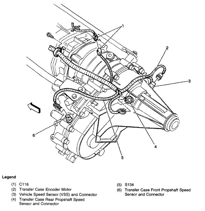

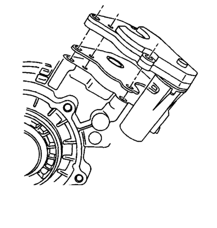

It sounds like you have a gear selector actuator or an encoder that is out on the transfer case. Here is a diagram on where you can find them. Try to move the switch and see if you can hear them working.
Here is a diagram
Also I have heard that the switches go out in these as well.
Please run some tests and get back to us so we can continue helping you.
