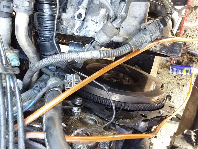

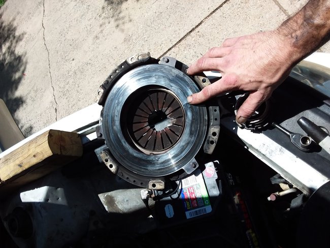

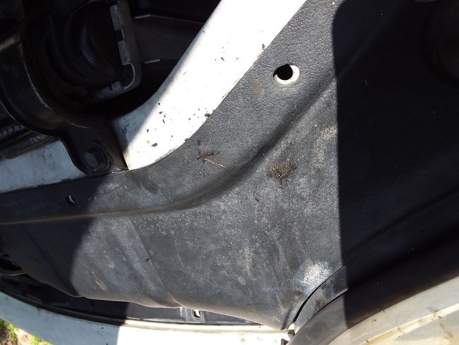

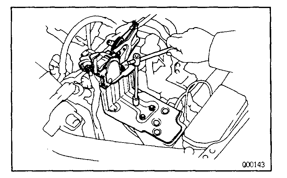

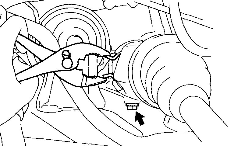

Clutch slips under even light load
1993 LEXUS ES 300
272,600 MILES • 3.0L • V6 • 2WD • MANUAL
BENJAMINTHERERRIBLE
  • 58 POSTS
It will not begin to engage until the pedal is almost fully released. No problems getting in or out of gears, and no loss of fluids. Pedal feels rather soft but still returns from disengaging.
May 26, 2019 at 2:56 PM
  • 110,194 POSTS
Welcome to 2CarPros.

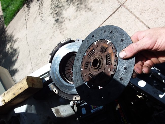

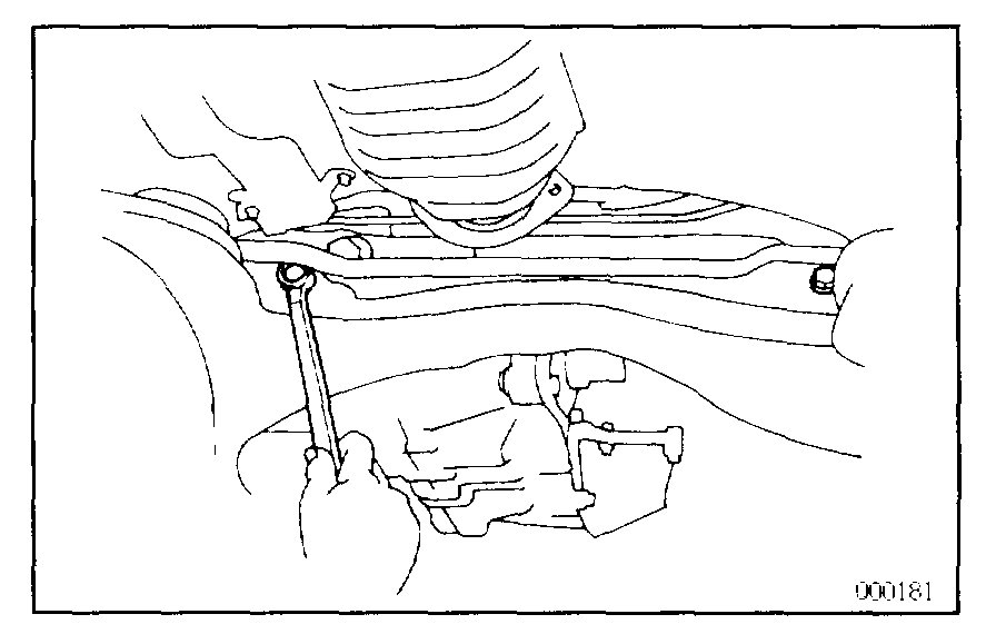

It does sound like the clutch is bad. Don't laugh, but when I question one, I take the car to a safe area and simply stop, put it in fifth gear, and let out the clutch not touching the throttle.. If it stalls, it may not be the clutch. If it keeps running but you notice a load on the engine, replace the clutch.
___________________________________
If you determine the clutch needs replaced, here are the directions for removing the transmission, the clutch assembly and reinstalling everything. The attached pictures correlate with the directions.
_____________________________________

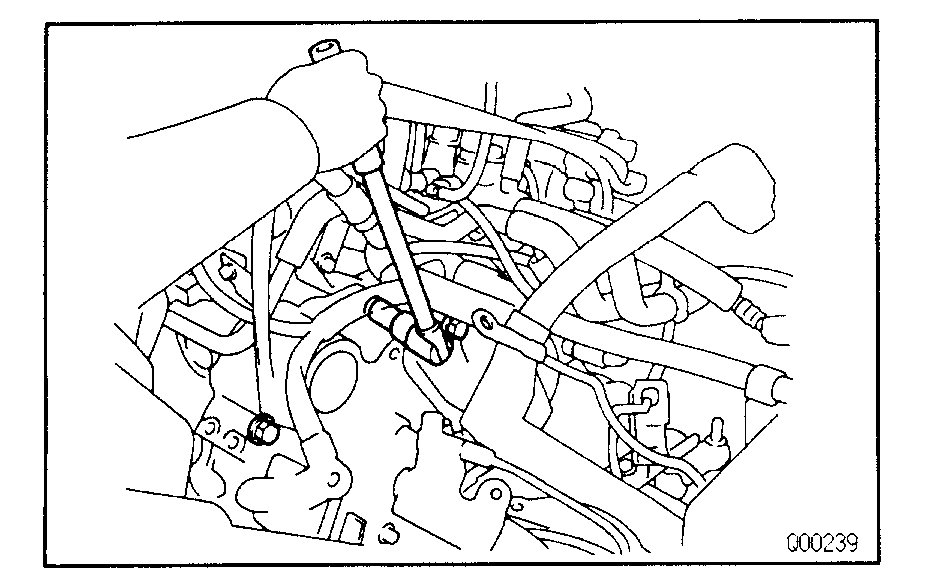

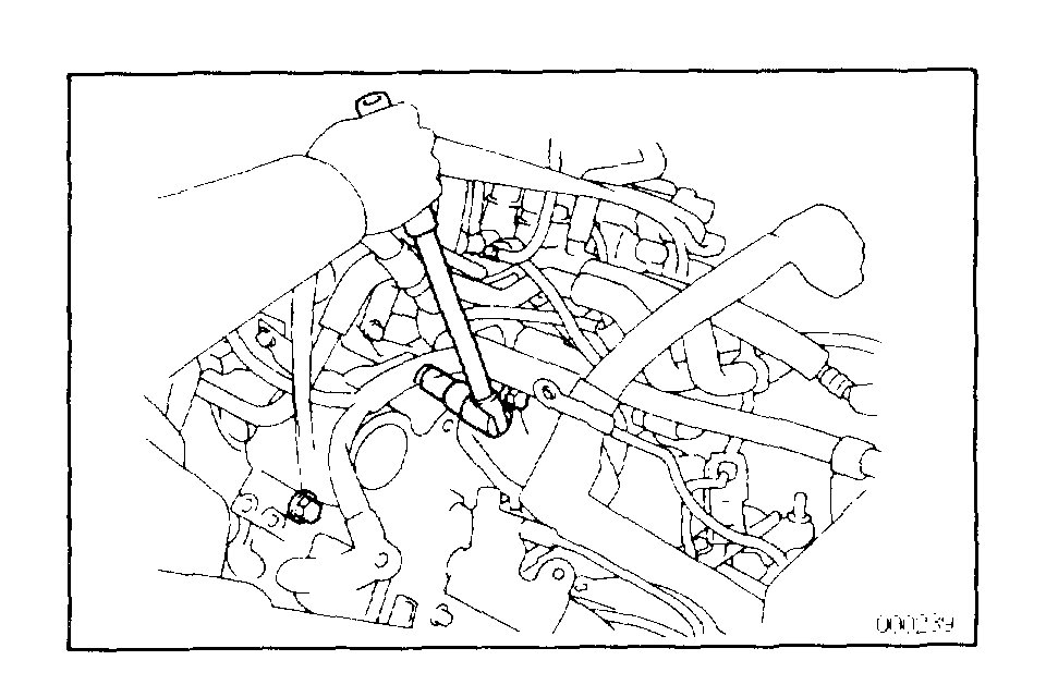

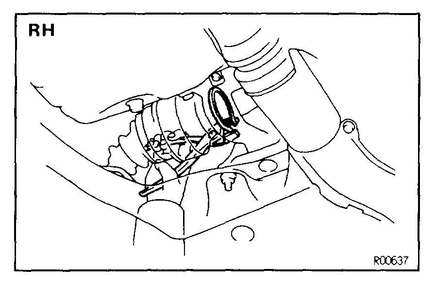

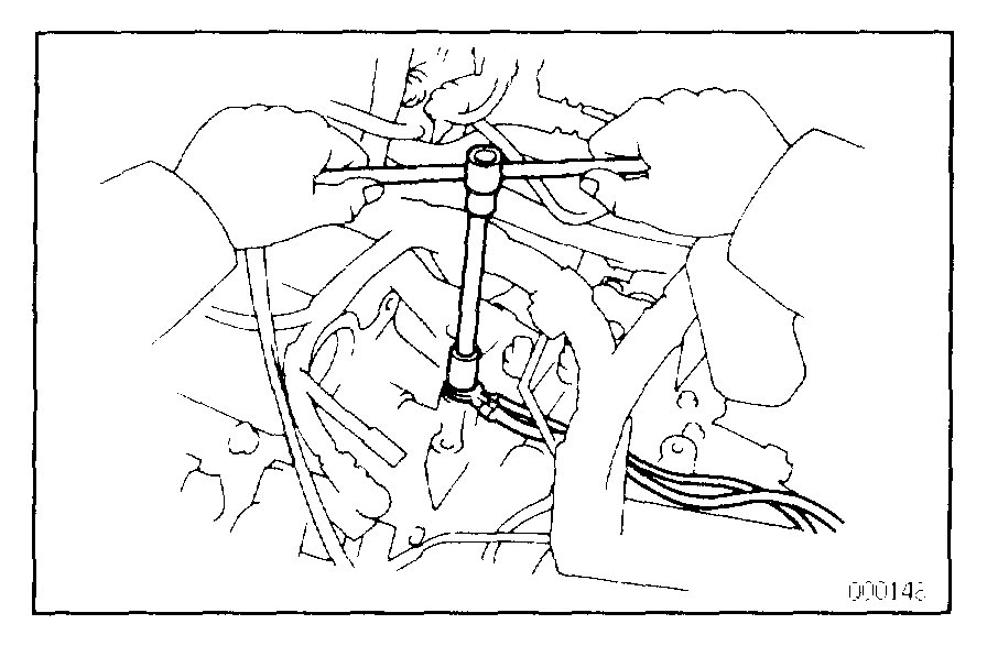

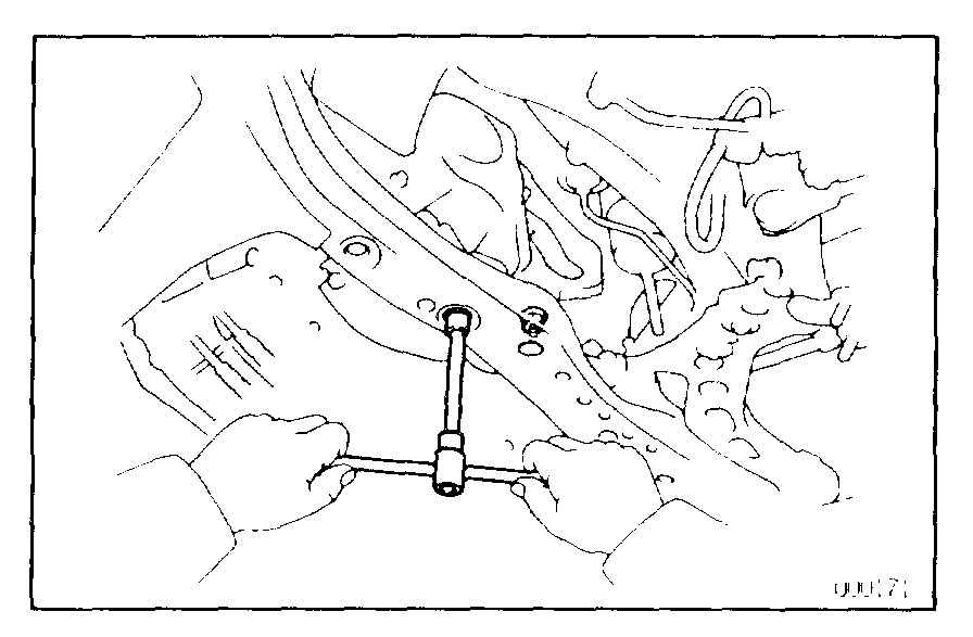

Removal and replacement
REMOVAL AND INSTALLATION
Part 1
pic 1
Part 2

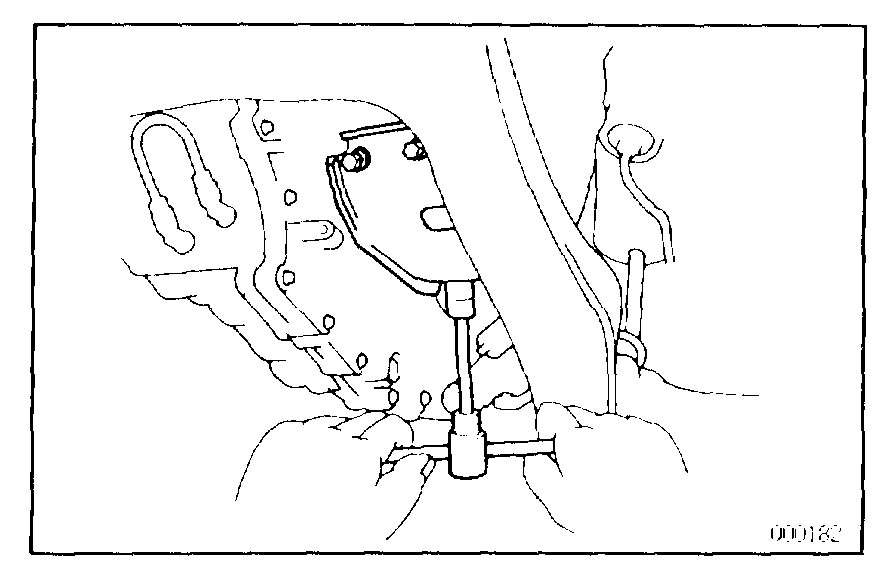

pic 2

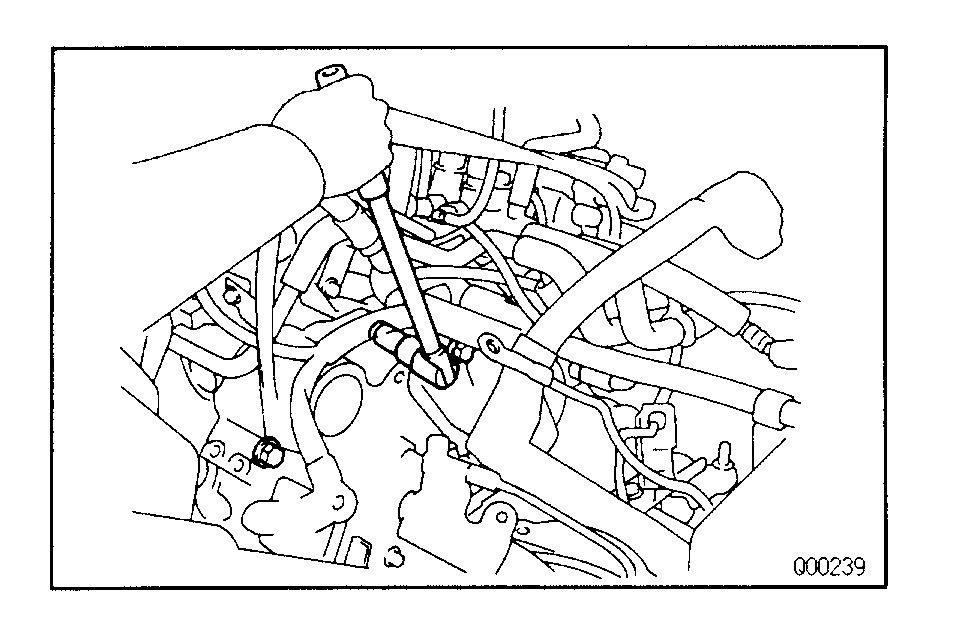

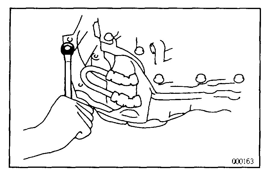

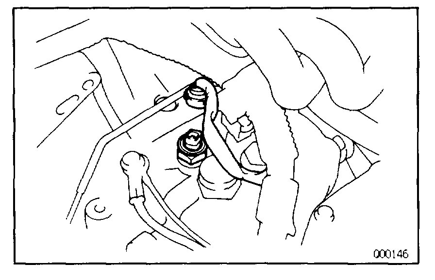

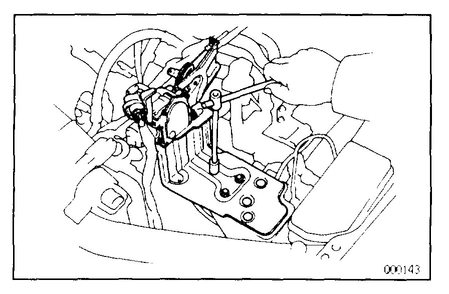

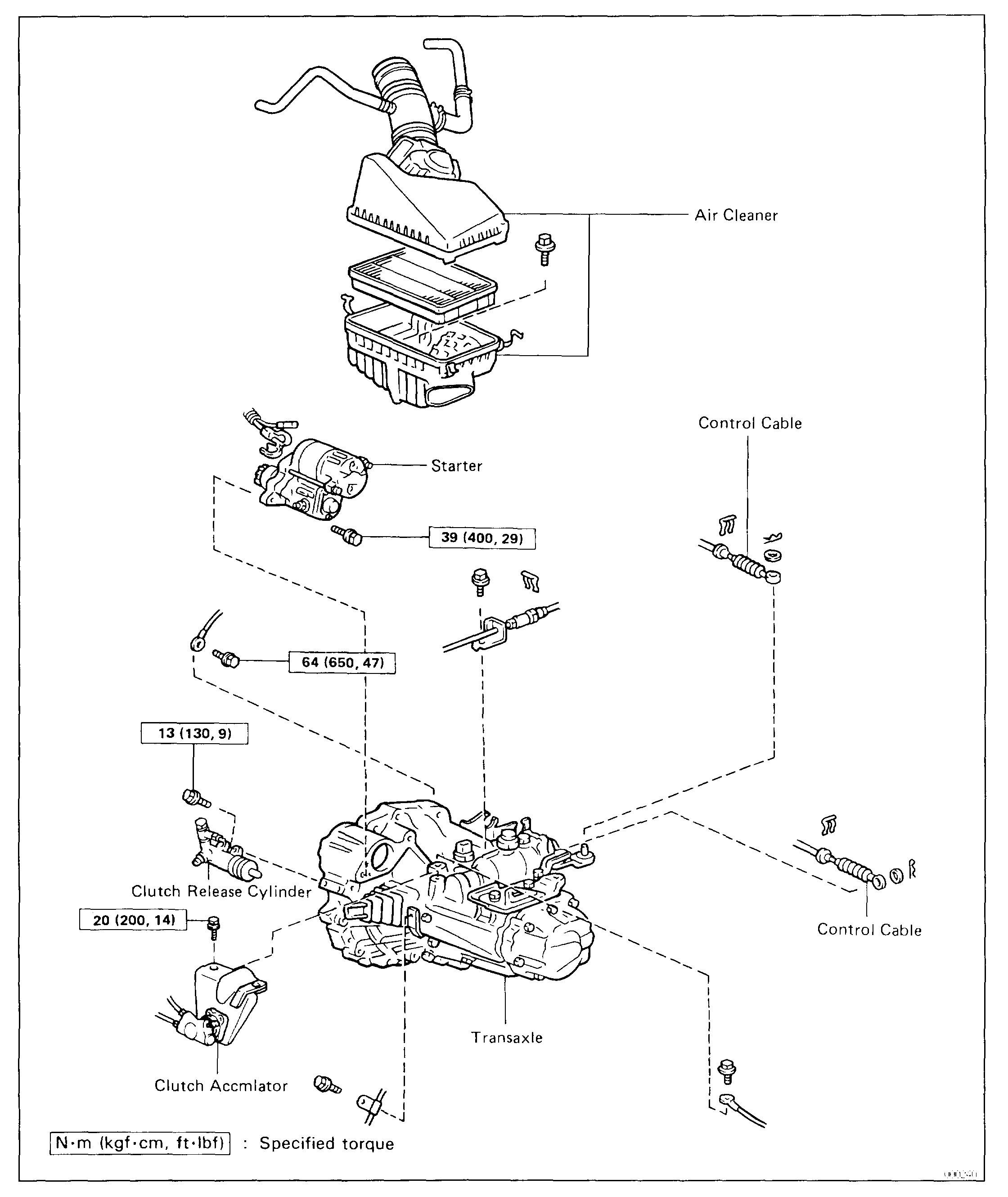

TRANSAXLE REMOVAL

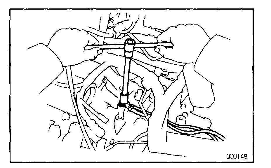

pic 3

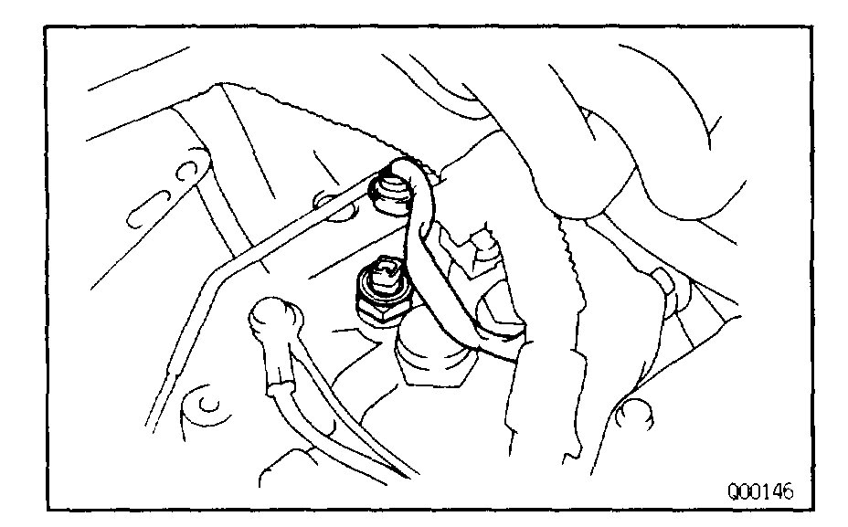

pic 4
1. REMOVE NEGATIVE BATTERY CABLE
CAUTION: Work must be started after 90 seconds from the "LOCK" position and the negative (-) terminal cable is disconnected from the battery.
2. REMOVE AIR CLEANER CASE ASSEMBLY WITH AIR HOSE
3. REMOVE CRUISE CONTROL ACTUATOR
a. Remove the cruise control actuator cover.
b. Disconnect the connector.
c. Remove the three bolts and cruise control actuator with bracket.

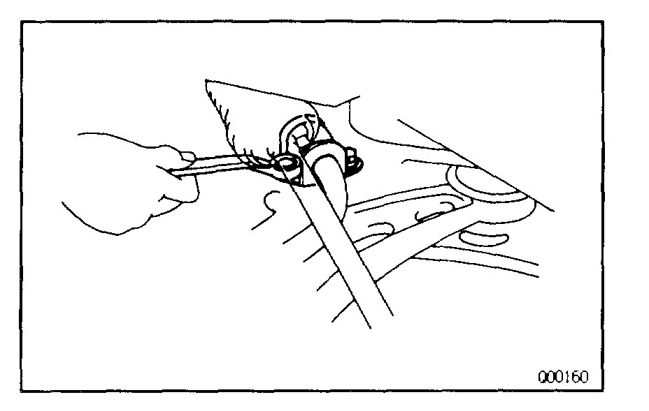

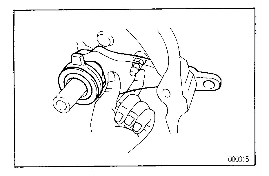

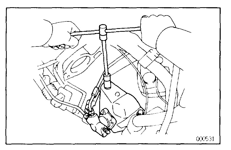

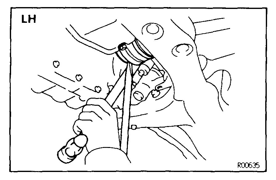

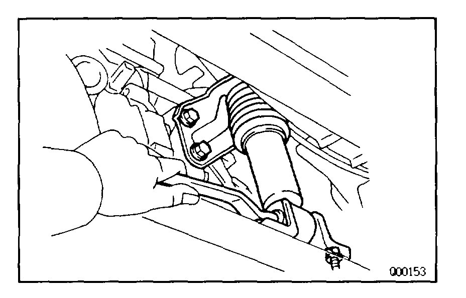

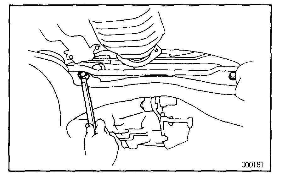

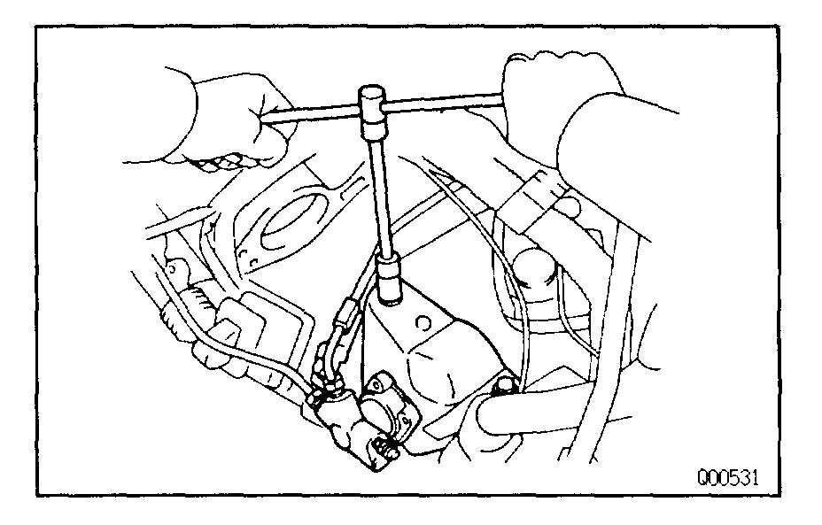

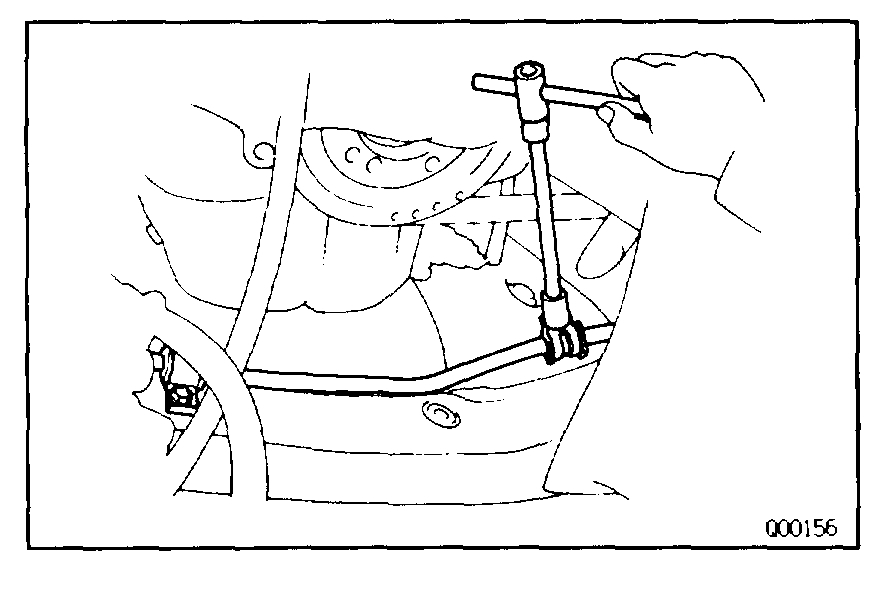

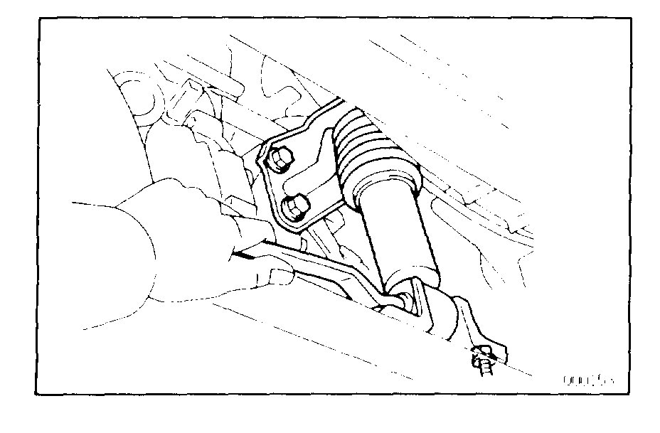

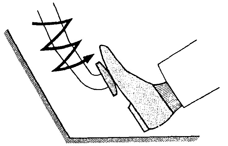

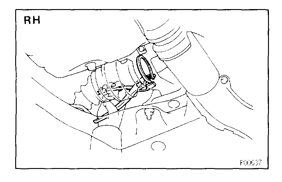

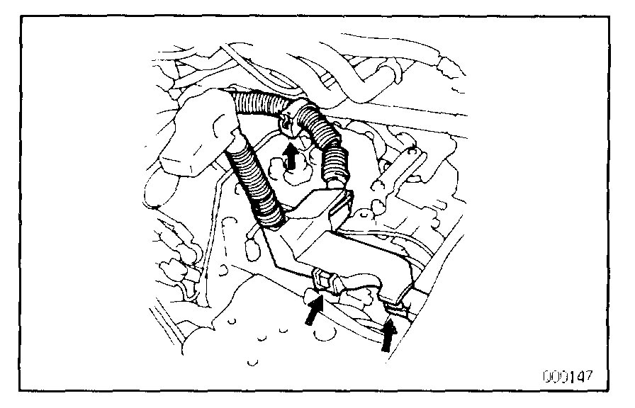

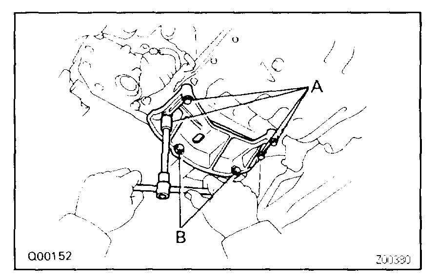

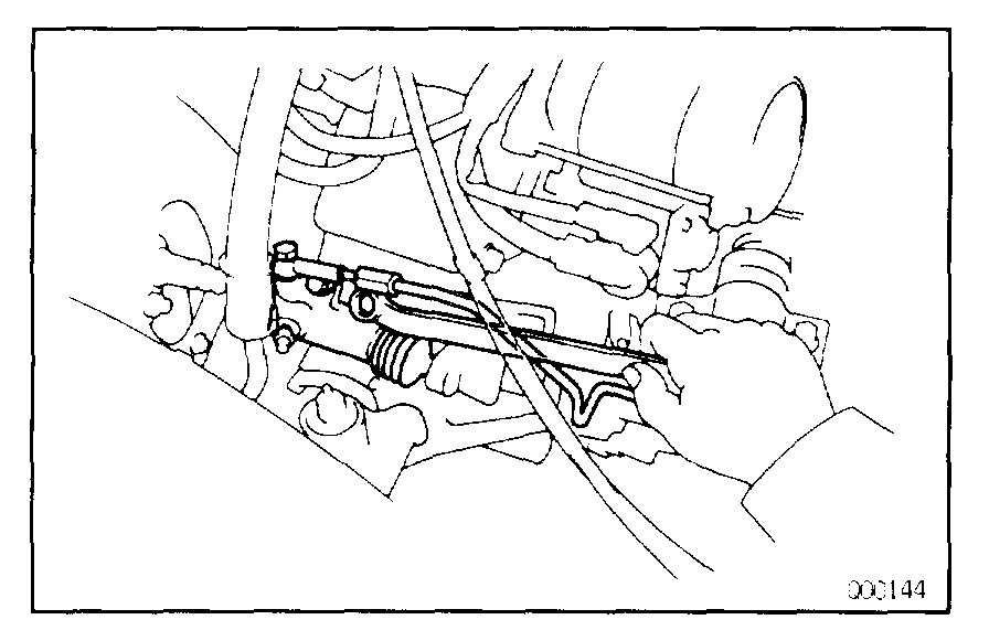

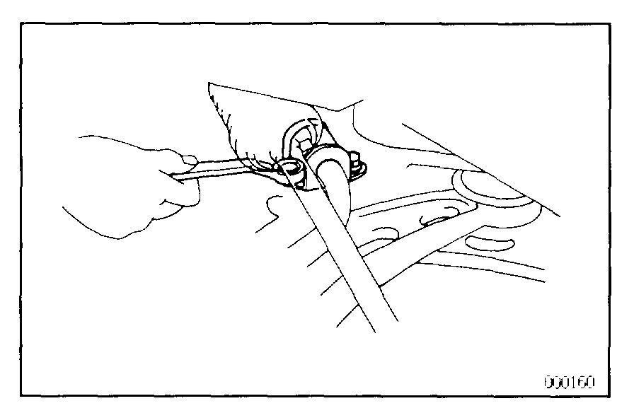

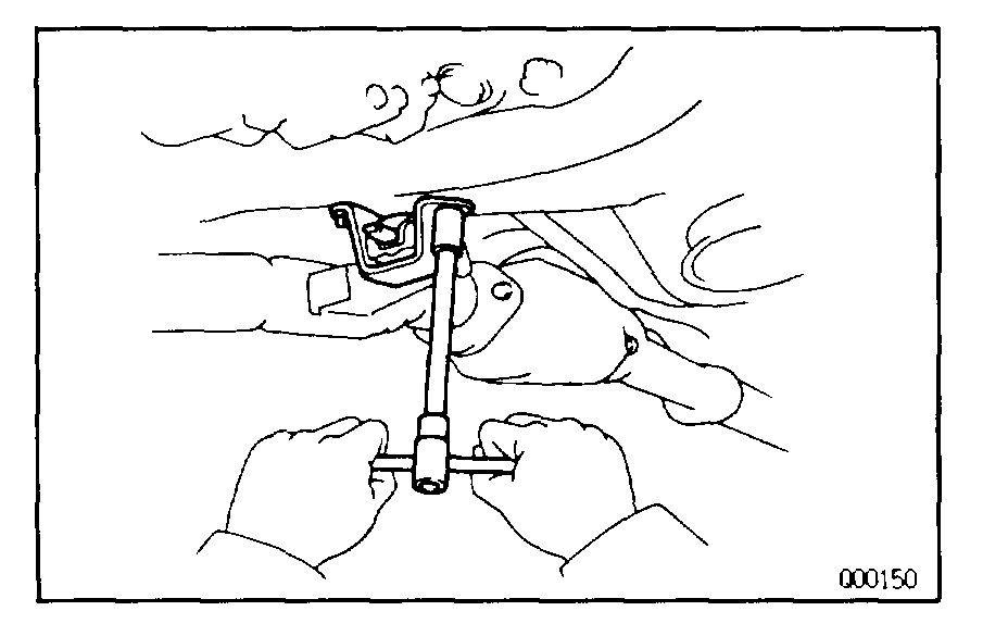

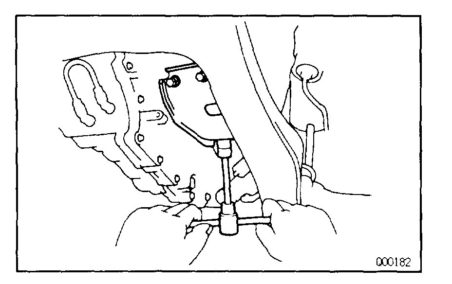

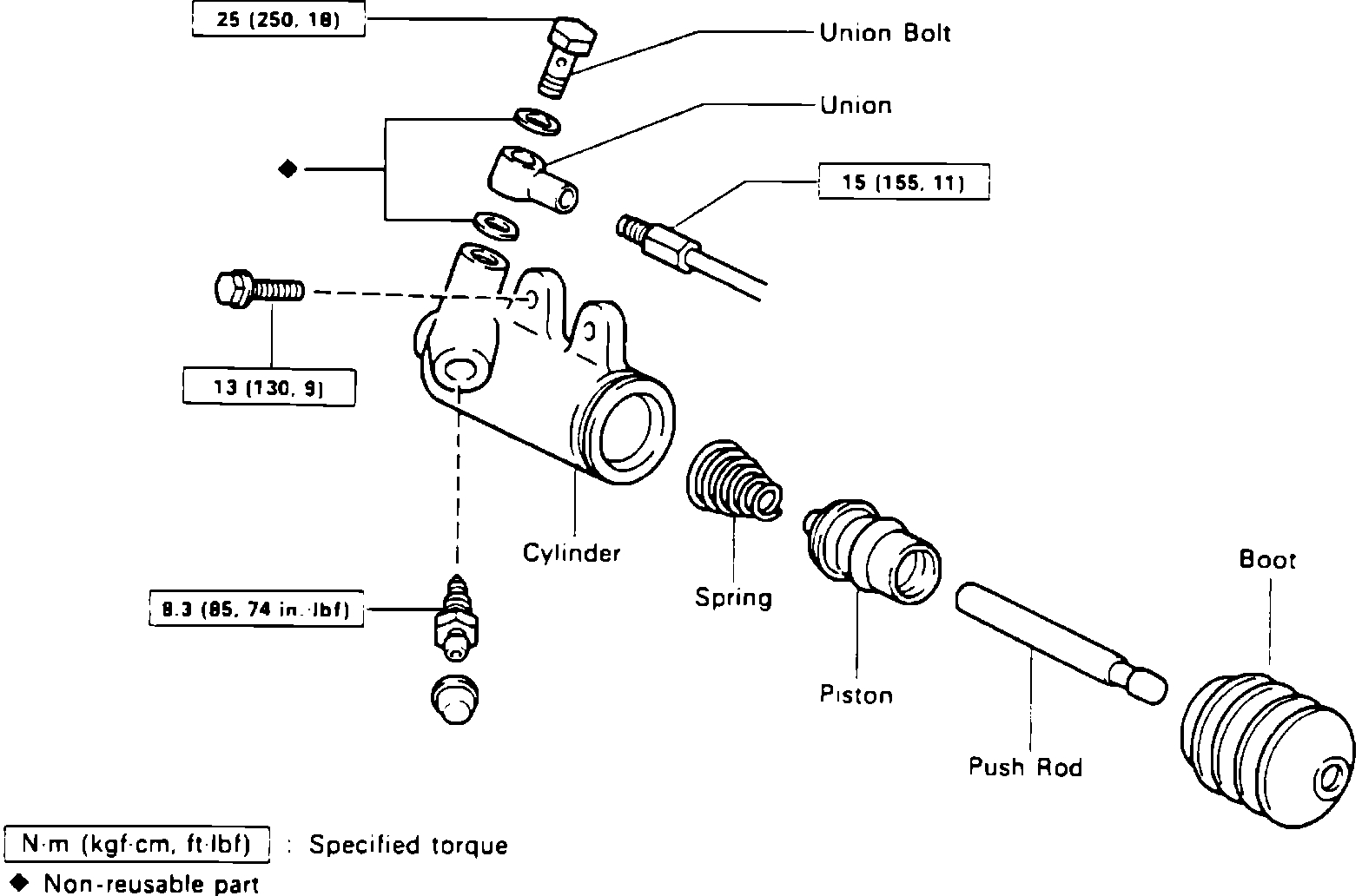

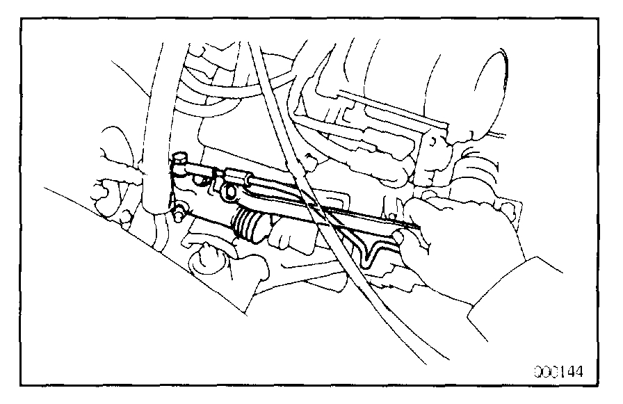

4. REMOVE CLUTCH RELEASE CYLINDER
pic 5

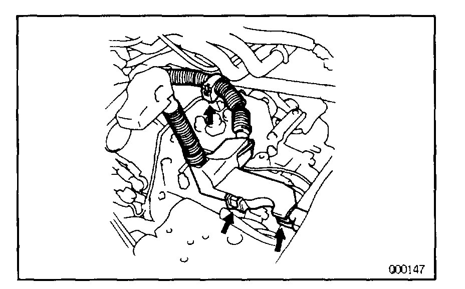

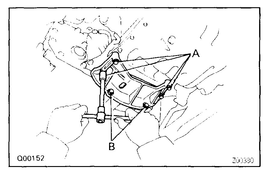

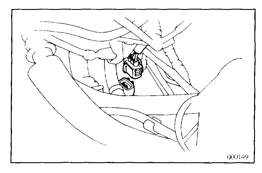

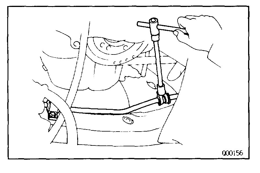

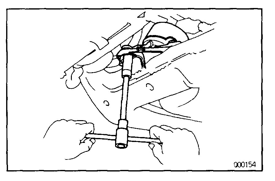

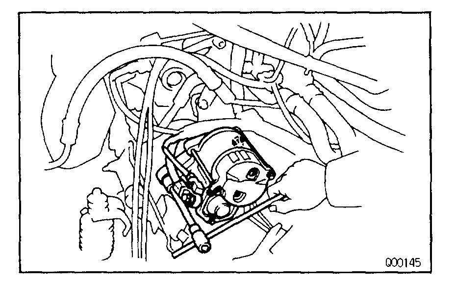

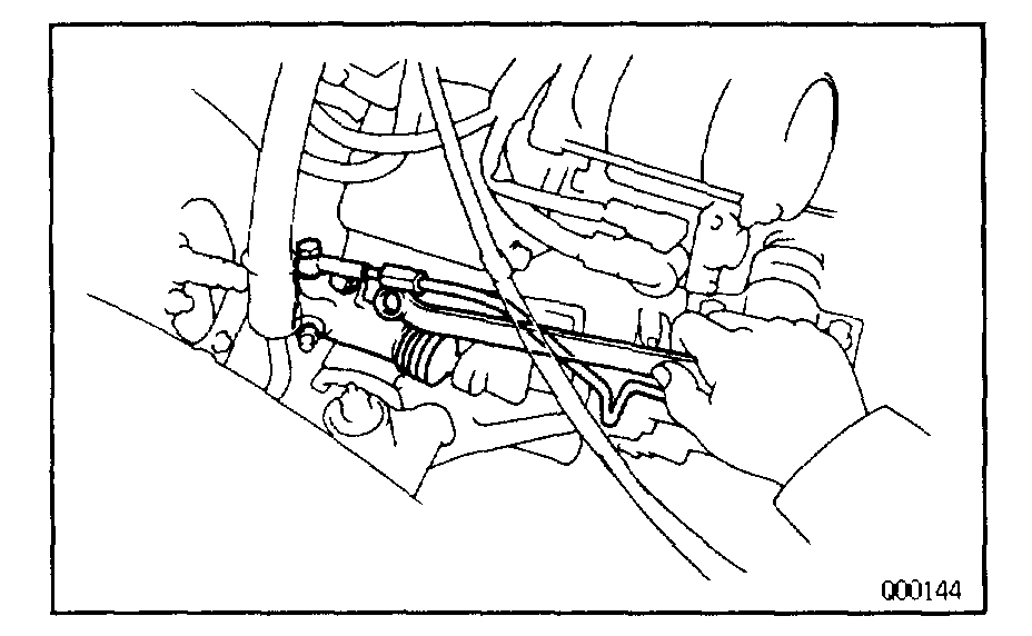

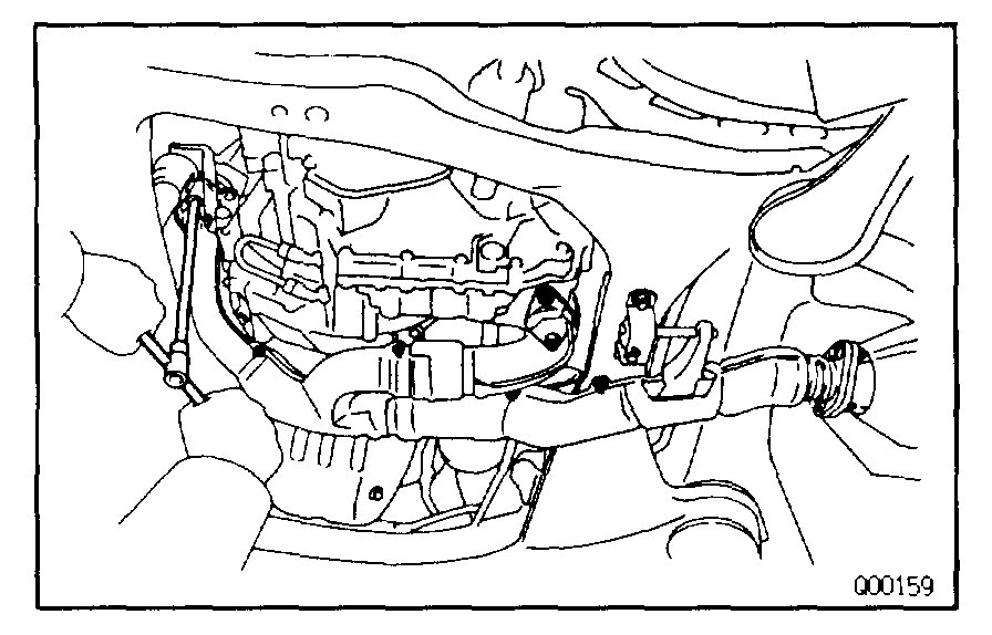

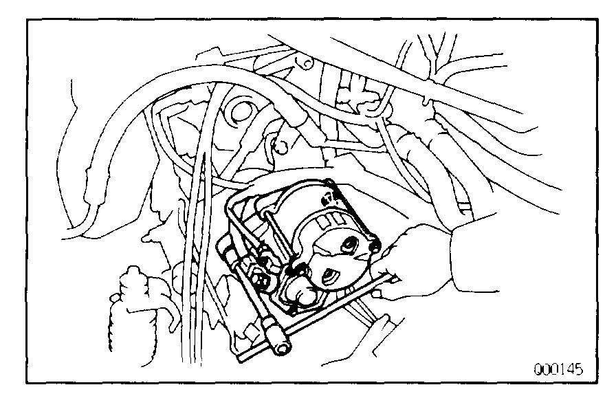

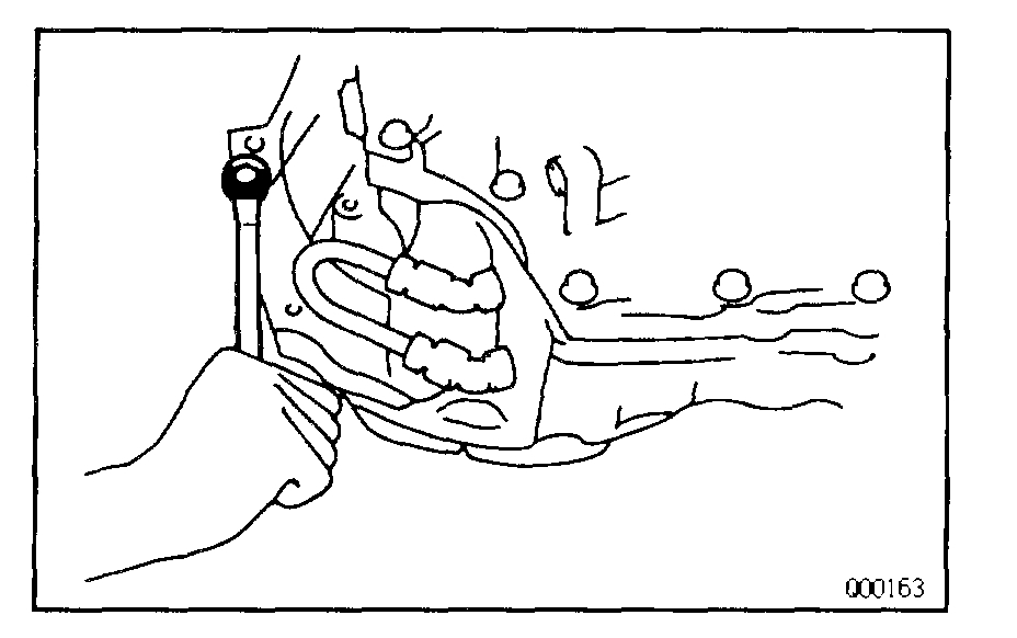

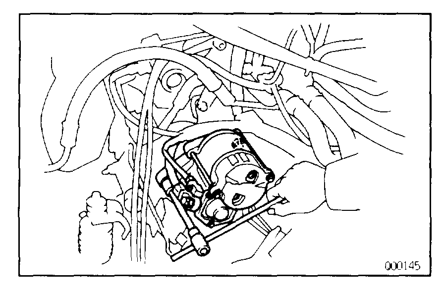

5. REMOVE STARTER
a. Disconnect the connector and wire from the starter.
b. Remove the two bolts and starter.
pic 6

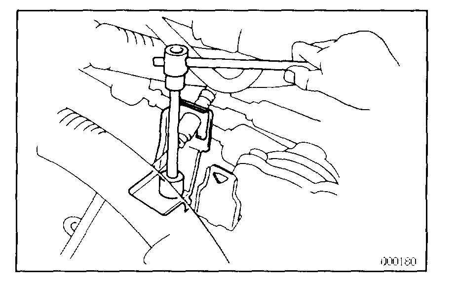

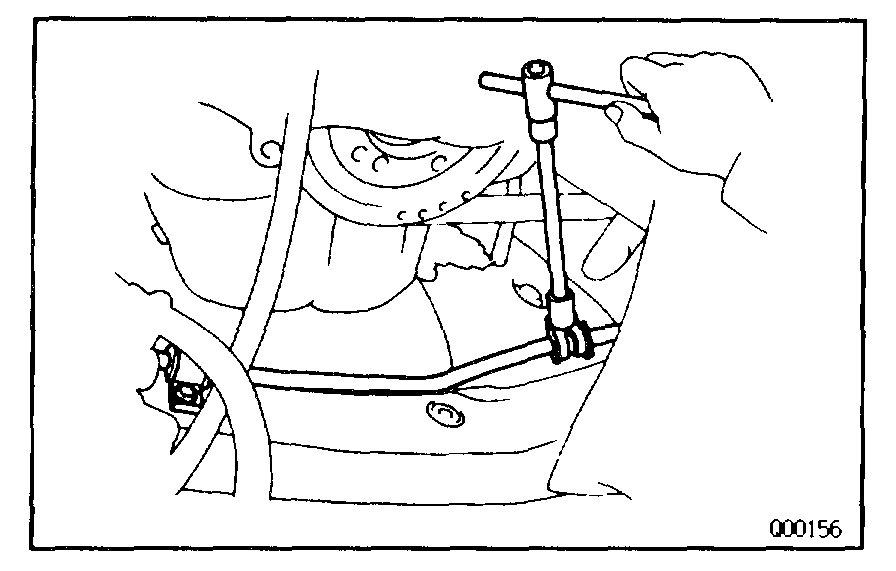

6. REMOVE CLUTCH ACCUMULATOR AND TUBE CLAMP
a. Remove the two bolts and clutch accumulator with bracket.
b. Remove the bolt and clutch tube clamp.
pic 7
7. DISCONNECT BACK-UP LIGHT SWITCH CONNECTOR
pic 8
8. DISCONNECT WIRES CLAMPS
pic 9

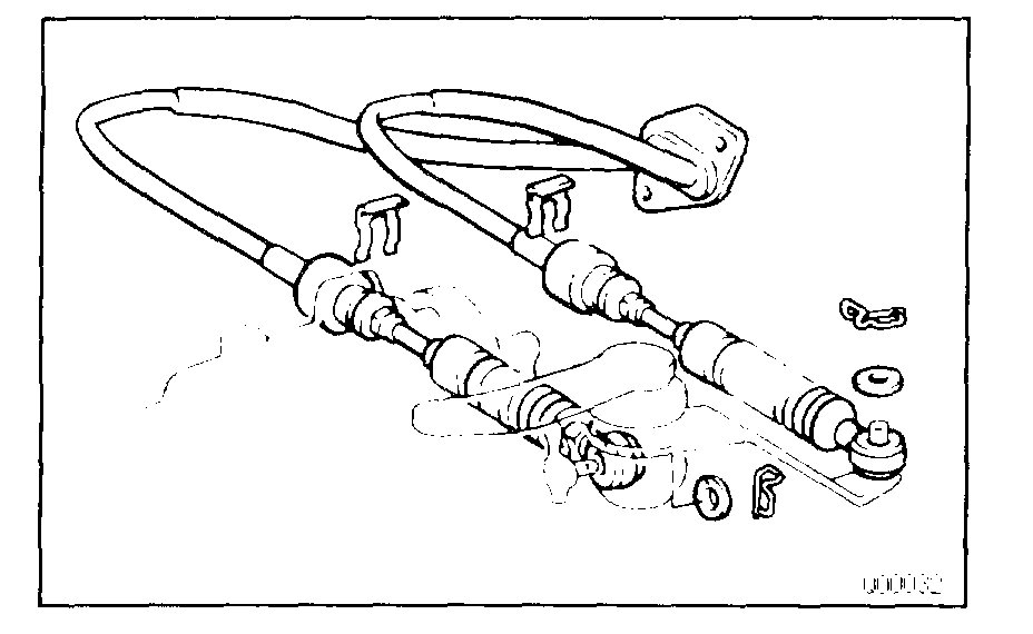

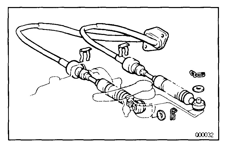

11. DISCONNECT CONTROL CABLES
a. Remove the clips and washers.
b. Remove the retainer from the cables.
pic 12

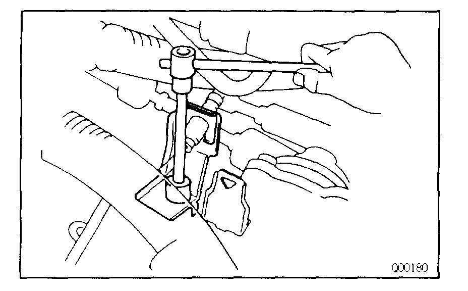

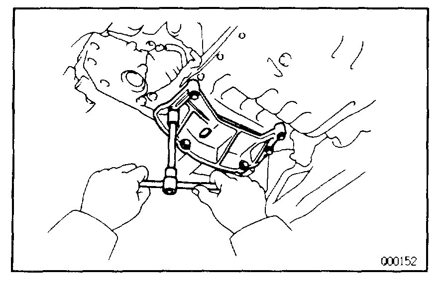

12. REMOVE TRANSAXLE MOUNTING THREE BOLTS OF TRANSAXLE CASE UPPER SIDE
pic 13

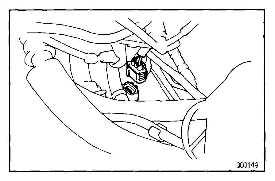

13. DISCONNECT SPEED SENSOR CONNECTOR
pic 14

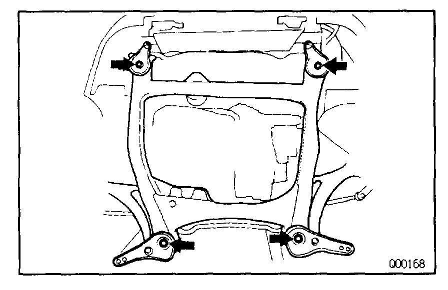

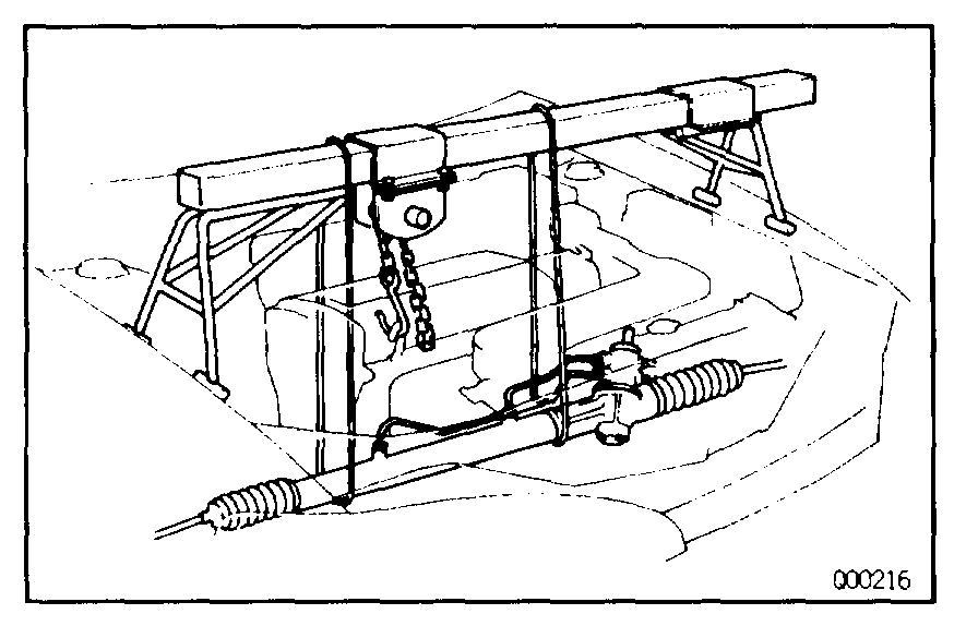

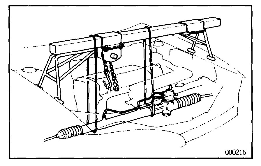

14. INSTALL ENGINE SUPPORT FIXTURE
15. TIE STEERING GEAR HOUSING TO ENGINE SUPPORT FIXTURE BY CORD OR EQUIVALENT

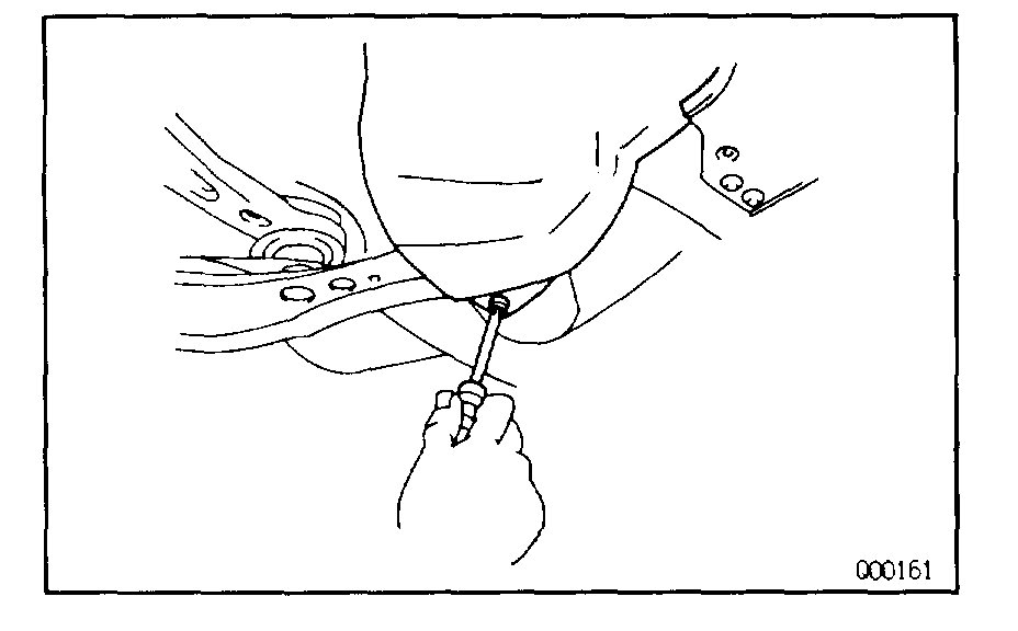

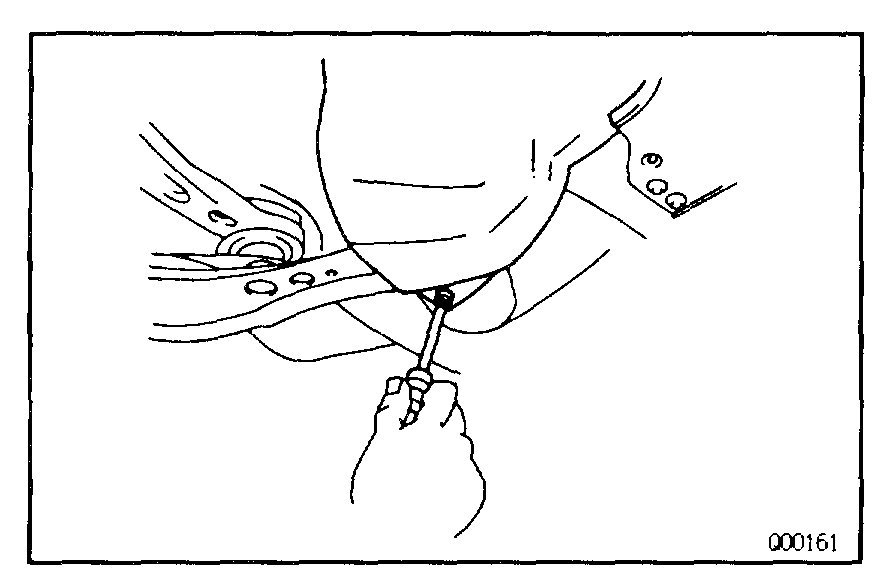

19. DRAIN TRANSAXLE OIL

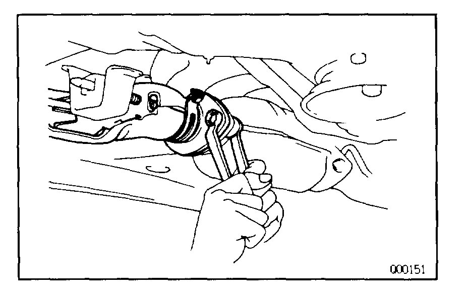

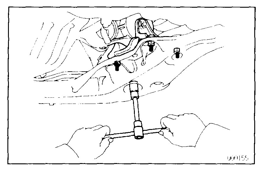

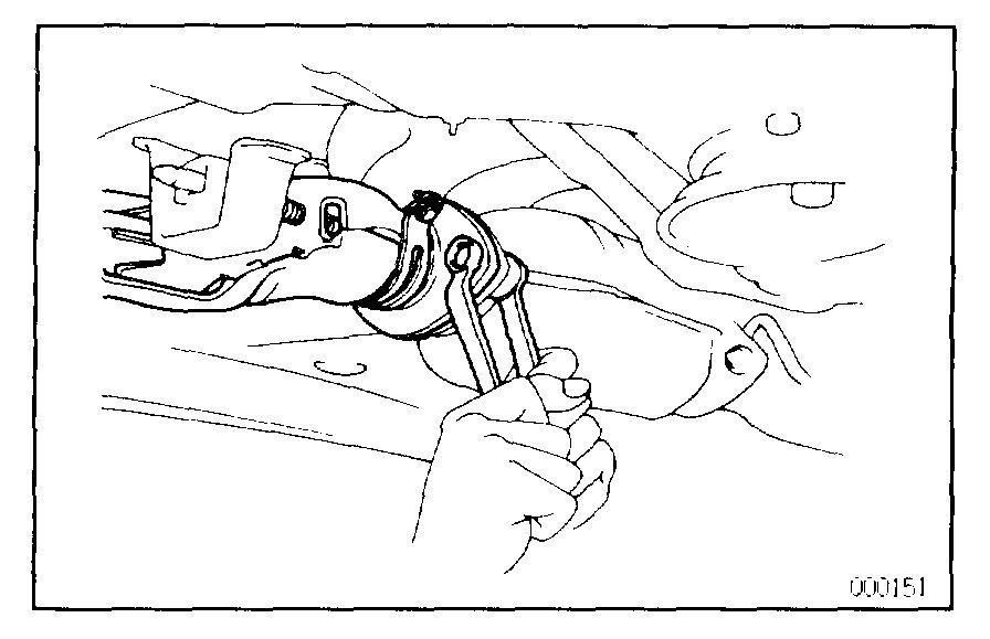

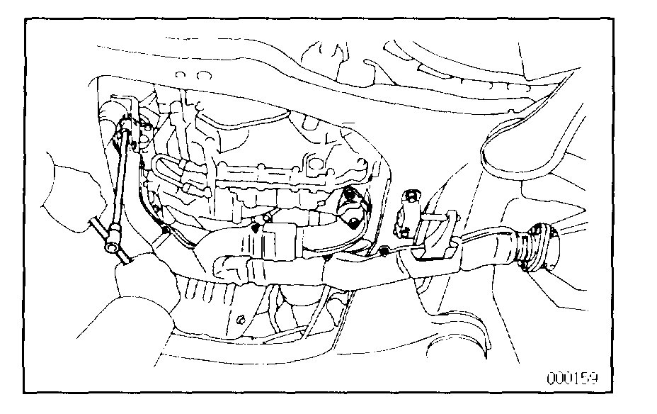

20. REMOVE EXHAUST FRONT PIPE
a. Remove the four nuts.
pic 16

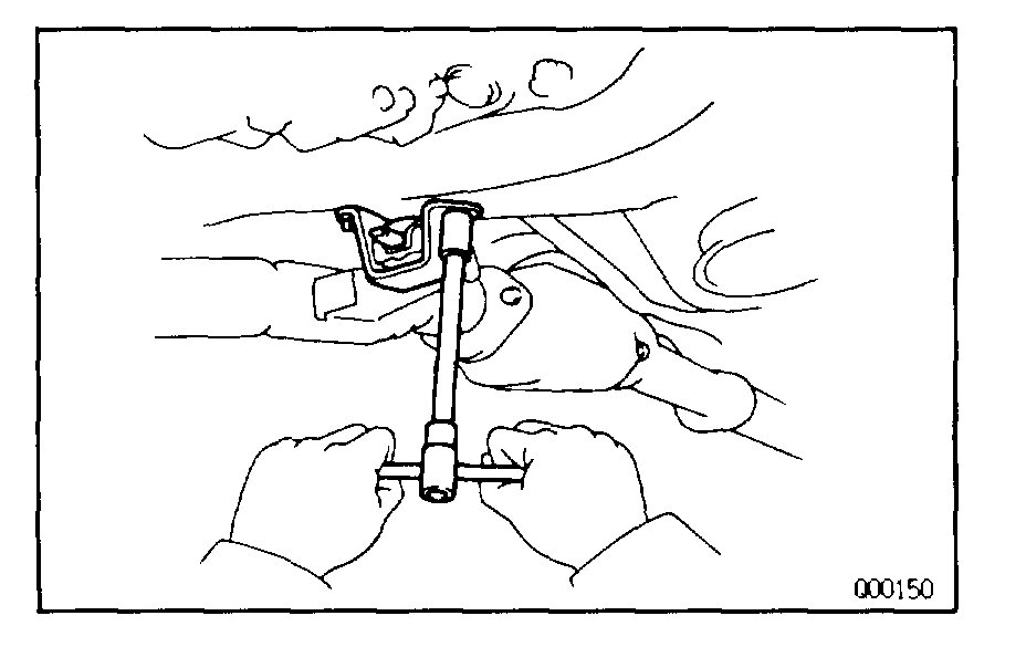

b. Remove the two bolts and front pipe support.
pic 17
c. Remove the two bolts and nuts.
d. Remove the front pipe.
pic 18
pic 19

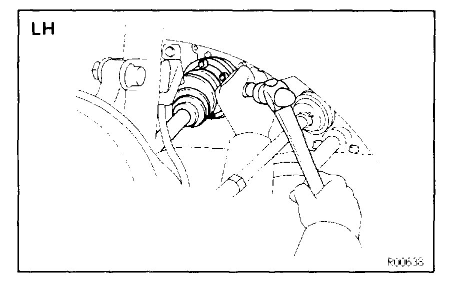

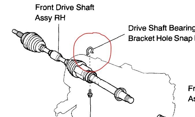

21. REMOVE DRIVE SHAFT See: Axle Shaft > Procedures

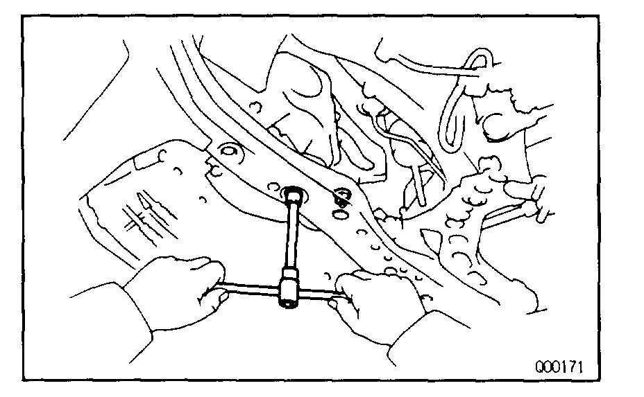

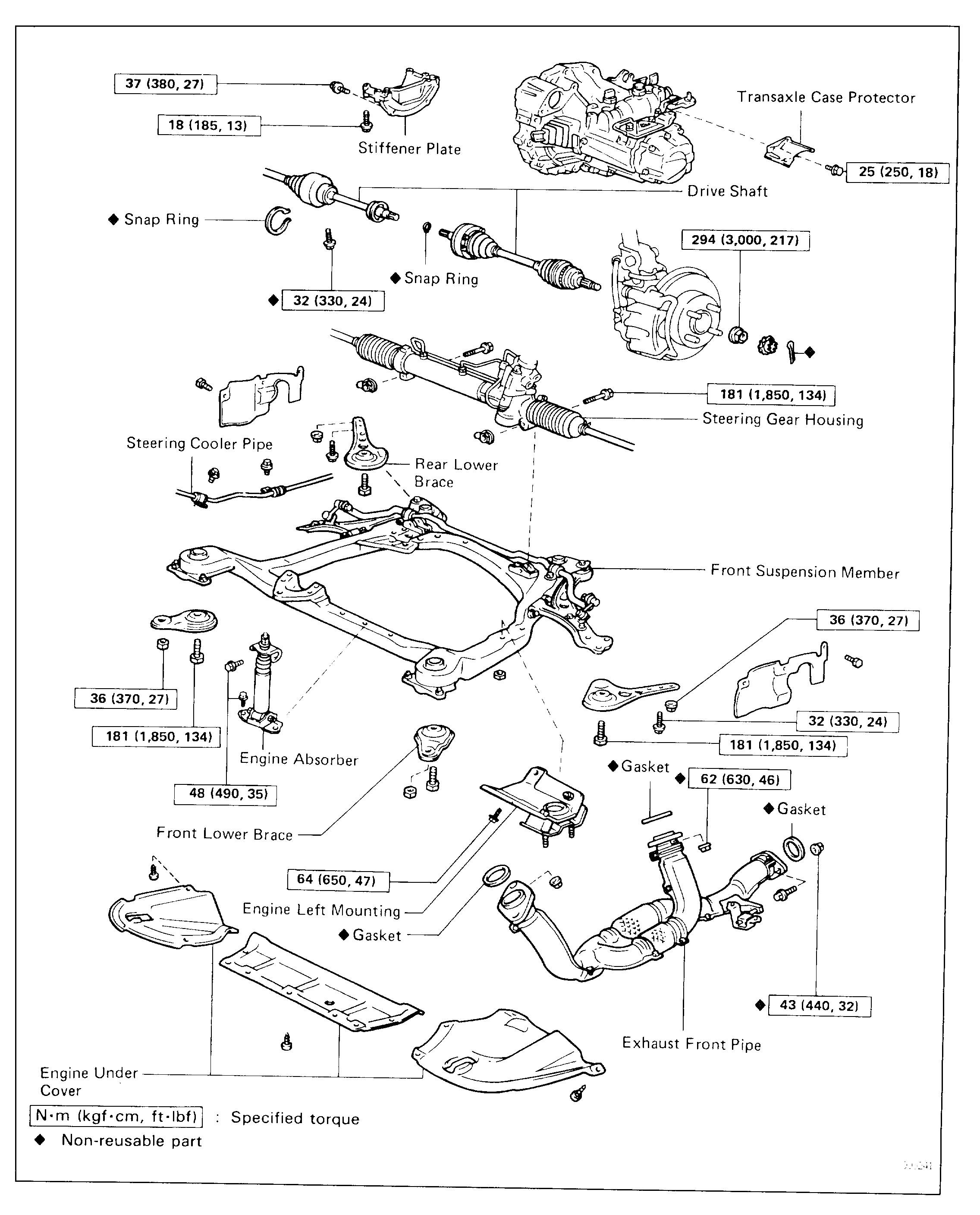

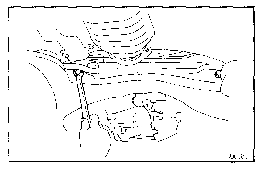

23. REMOVE STIFFENER PLATE
pic 23
24. REMOVE ENGINE ABSORBER
Remove the four bolts and engine absorber.
pic 24

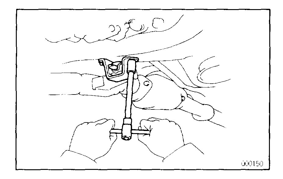

25. REMOVE ENGINE FRONT MOUNTING SET BOLTS AND NUT
Remove the two bolts and a nut.
pic 25
26. REMOVE ENGINE REAR MOUNTING SET NUTS
a. Remove the two hole plugs.
b. Remove the four nuts.
pic 26

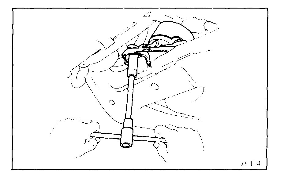

27. REMOVE ENGINE LEFT MOUNTING
a. Raise the transaxle and engine slightly with a jack and wooden block in between.
b. Remove the two hole plugs and nuts.
pic 27
c. Remove the three bolts and engine left mounting.
pic 28

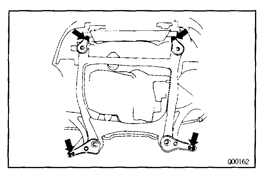

28. REMOVE STEERING COOLER PIPE SET BOLTS

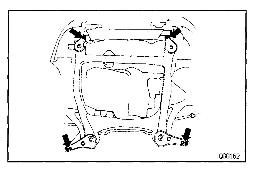

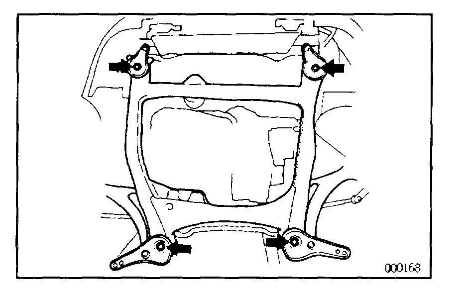

29. REMOVE FRONT SUSPENSION MEMBER
pic 29
a. Remove the left and right fender liner set screws.
pic 30

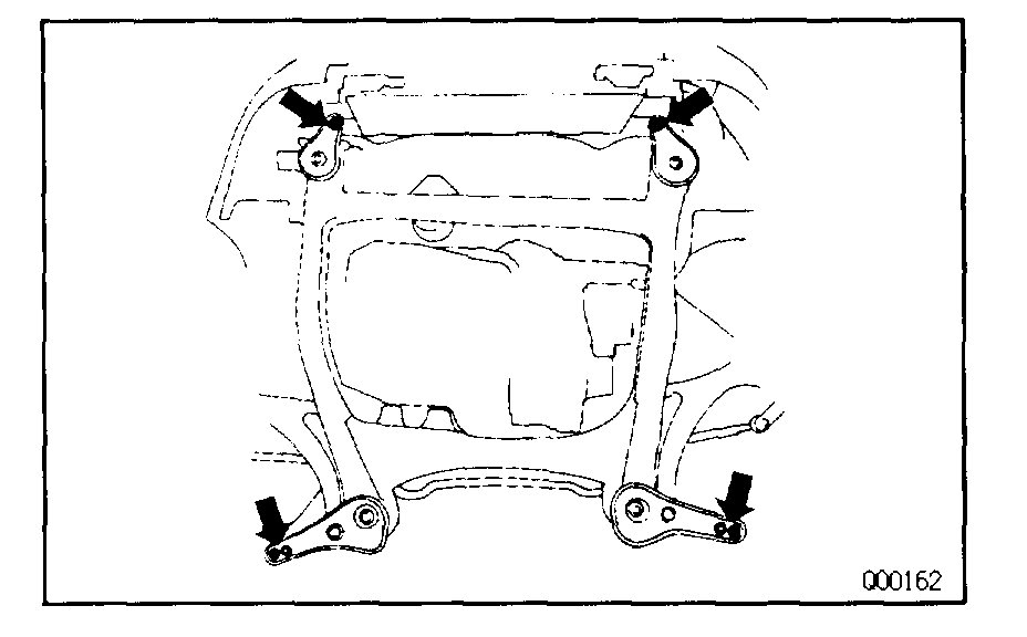

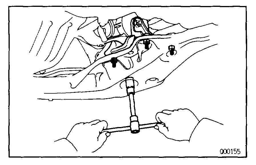

b. Remove the two bolts and four nuts.
pic 31
c. Remove the four bolts.
d. Remove the two front lower braces, rear lower braces and front suspension member.
pic 32
30. REMOVE TRANSAXLE
a. Remove the transaxle mounting bolts from the engine.
b. Lower the engine left side and remove the transaxle from the engine.

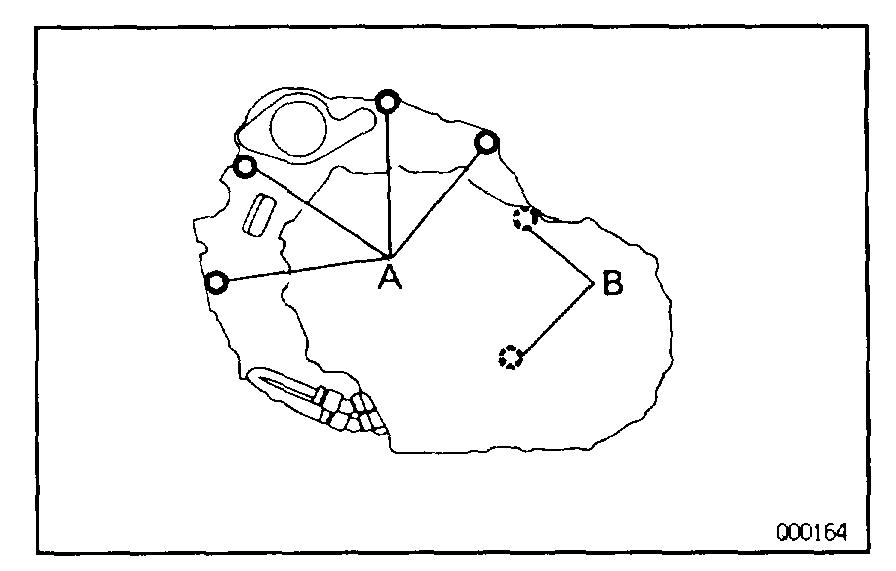

1. INSTALL TRANSAXLE TO ENGINE
a. Align the input shaft spline with the clutch disc and install the transaxle to the engine.
b. Torque the bolts.
Bolt A
Torque: 64 N.m (650 kgf-cm, 47 ft-lbf)
Bolt B
Torque: 46 N.m (470 kgf-cm, 34 ft-lbf)

25. INSTALL CLUTCH RELEASE CYLINDER AND TUBE CLAMP
pic 60
a. Place the release cylinder and torque the two bolts.
Torque: 13 N.m (130 kgf-cm, 9 ft-lbf)

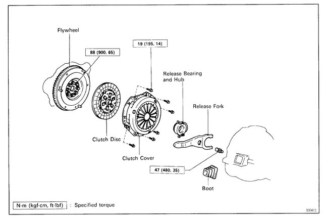

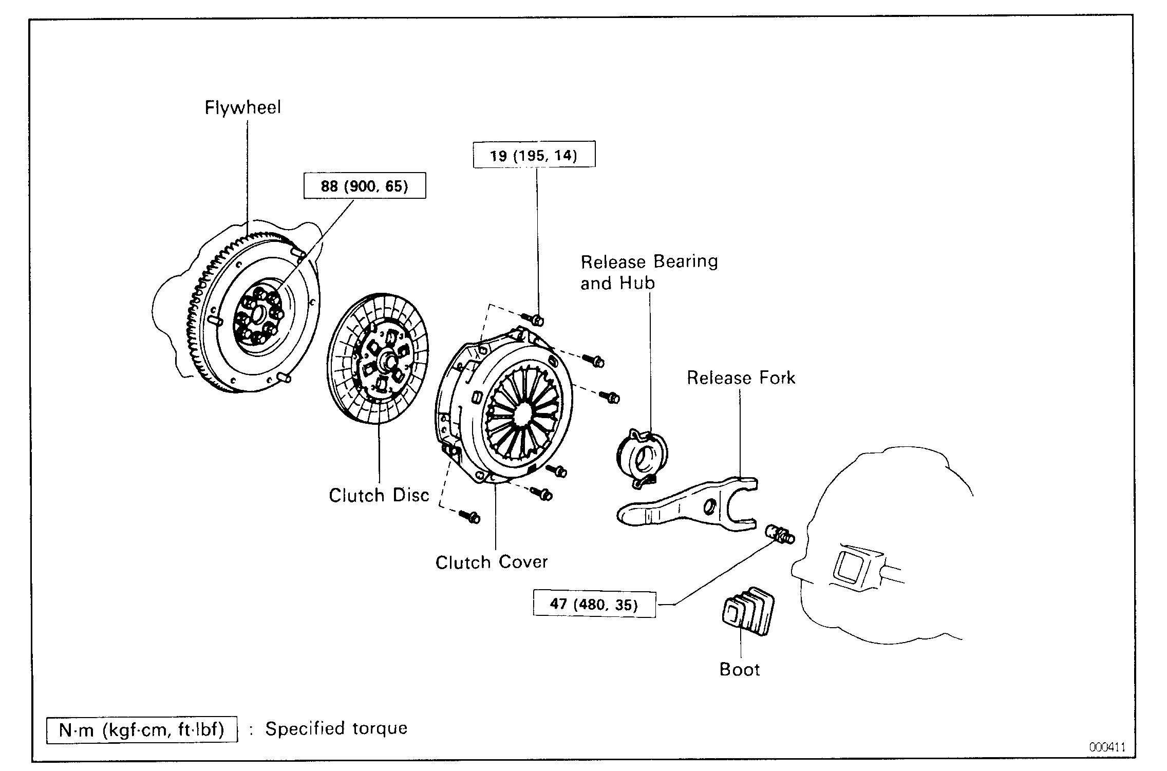

Clutch removal
CLUTCH UNIT REMOVAL
pic 62
CLUTCH UNIT REMOVAL
pic 63
1. REMOVE TRANSAXLE FROM ENGINE
pic 64

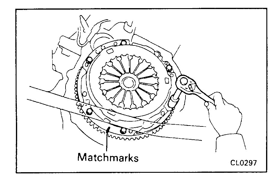

2. REMOVE CLUTCH COVER AND DISC
(a)Place matchmarks on the flywheel and clutch cover.
(b)Loosen each set bolt one turn at a time until spring tension is released.
(c)Remove the set bolts, and pull off the clutch cover with the clutch disc.
NOTICE: Do not drop the clutch disc.
pic 65

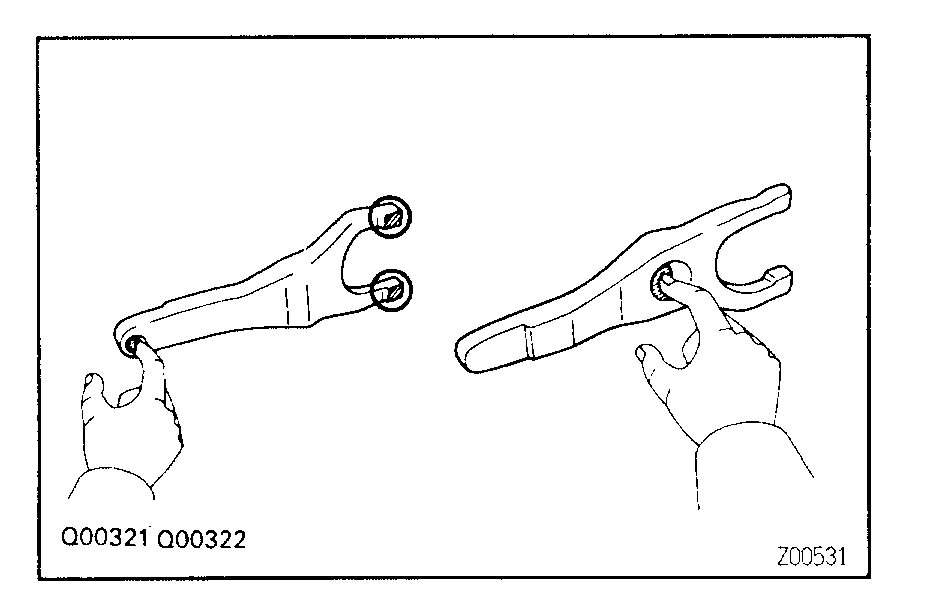

3. REMOVE RELEASE BEARING AND FORK FROM TRANSAXLE
(a)Remove the release bearing together with the fork and then separate them.
(b)Remove the boot.

CLUTCH UNIT INSTALLATION
pic 66

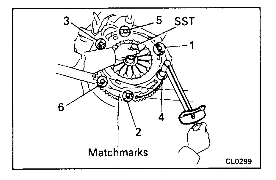

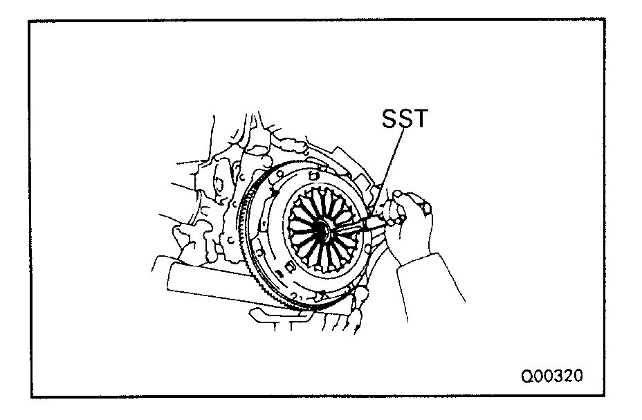

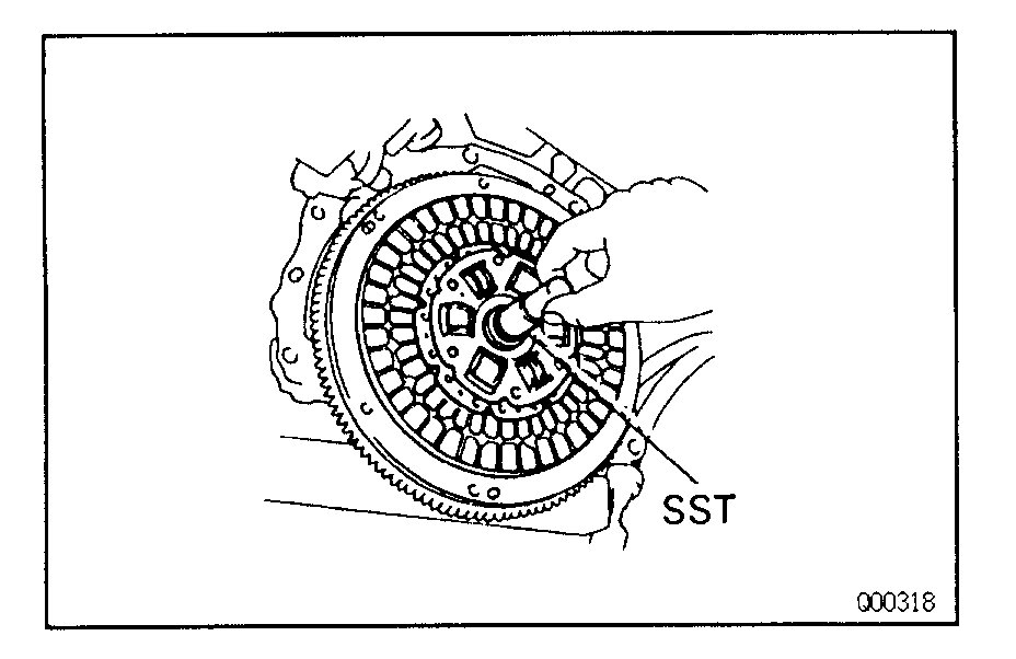

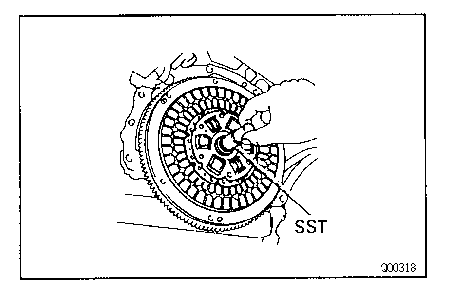

1. INSTALL CLUTCH DISC AND CLUTCH COVER ON FLYWHEEL
(a)Insert the SST in the clutch disc, and then set them and the clutch cover in position.
SST 09301-00220
pic 67
(b)Align the matchmarks on the clutch cover and flywheel.
(c)Temporarily tighten the topmost bolt from the three near the knock pins.
HINT: Temporarily tighten the No.3 bolt.
(d)Torque the bolts on the clutch cover in the order shown.
Torque: 19 N.m (195 kgf.cm, 14 ft.lbf)
pic 68

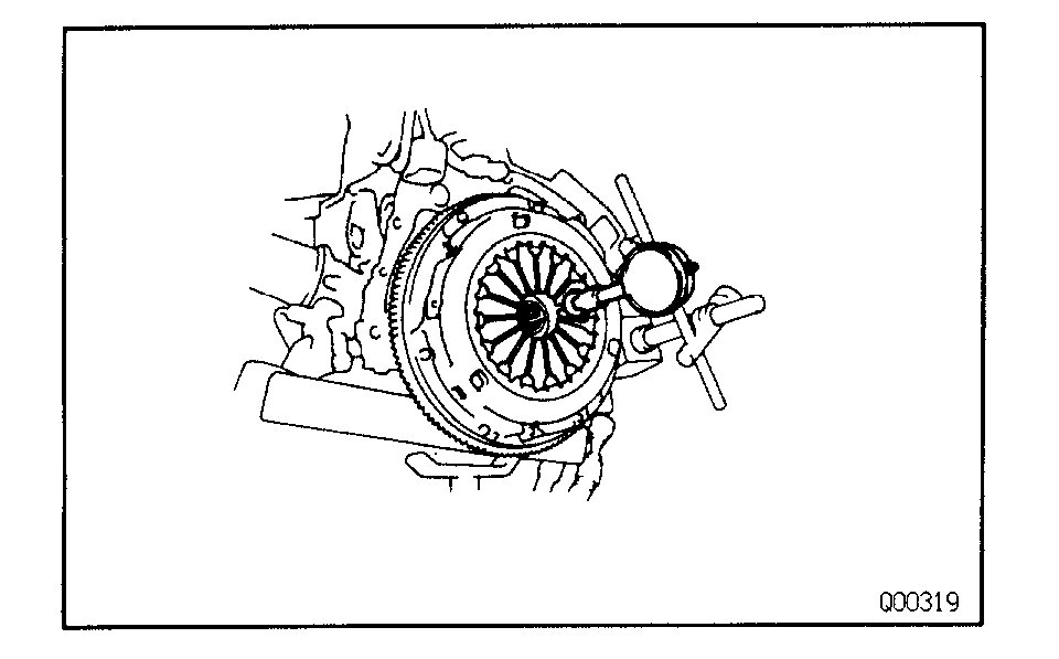

2. CHECK DIAPHRAGM SPRING TIP ALIGNMENT
Using a dial indicator with roller instrument, check the diaphragm spring tip alignment.
Maximum non-alignment:
0.5 mm (0.020 in.)
pic 69
If alignment is not as specified, using SST, adjust the diaphragm spring tip alignment.
SST 09333-00013
pic 70
3. APPLY MOLYBDENUM DISULPHIDE LITHIUM BASE GREASE (NLGI NO.2) TO FOLLOWING PARTS
^ Release fork and hub contact point
^ Release fork and push rod contact point
^ Release fork pivot point
^ Clutch disc spline
pic 71
4. INSTALL RELEASE BEARING AND FORK TO TRANSAXLE
Install the bearing to the release fork, and then install them to the transaxle.
pic 72

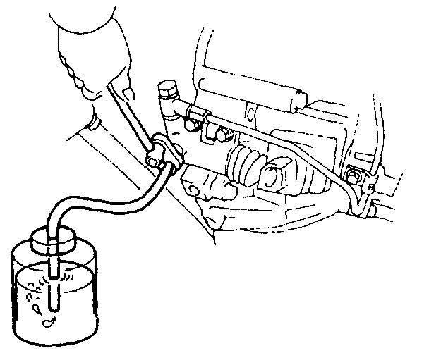

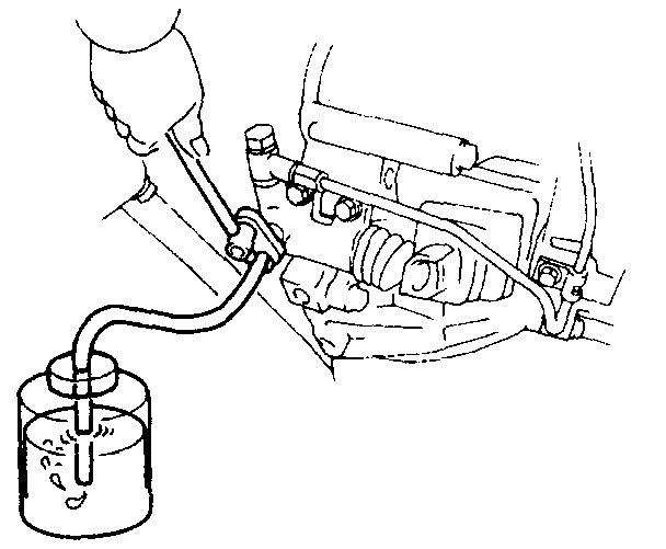

CLUTCH SYSTEM BLEEDING
HINT: If any work is done on the clutch system or if air is suspected in the clutch lines, bleed the system of air.
NOTICE: Do not let brake fluid remain on a painted surface. Wash it off immediately.
1. FILL CLUTCH RESERVOIR WITH BRAKE FLUID Check the reservoir frequently. Add fluid if necessary.
2. CONNECT VINYL TUBE TO BLEEDER PLUG Insert the other end of the tube in a half-full container of brake fluid.
3. BLEED CLUTCH LINE
pic 73
- Slowly pump the clutch pedal several times.
- While pressing on the pedal, loosen the bleeder plug until the fluid starts to run out. Then close the bleeder plug.

BENJAMINTHERERRIBLE
  • 58 POSTS
Here are those pictures.
In #3, what is that stuff? It's like a hair like fiber and is everywhere. Tell me that's not asbestos..
Jul 15, 2019 at 11:36 AM
  • 110,194 POSTS
Welcome back:
I bet that was a nightmare. The clutch disc seems worn a good bit. What I suggest is to replace everything and have the flywheel resurfaced. As far as picture 3, I can't be sure, but I really don't feel it is asbestos.
Let me know how the job goes for you, and let me know if you have other questions or need help.

So turns out the passenger side inner cv had popped out.
Almost completely. Pushed it back in, and now it engages fine. Although, I can't seem to get it seated in all the way or something.. It just slides out no problem when I pull it by hand. Is this something the snap ring on the intermediate bearing prevents?
Sep 20, 2019 at 12:22 AM
  • 110,194 POSTS
Welcome back:
There should be a snap ring that secures it. See the attached pics. It shouldn't just come out like that. Most likely it will happen again.
Let me know if this helps.
