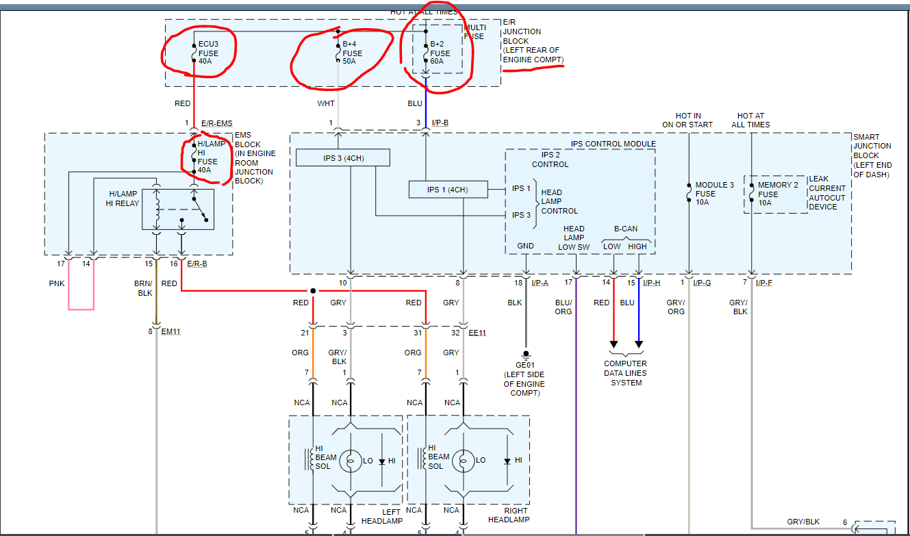

Changing out my LED's. When I plugged in the new one the LED was kinda hanging down and it sparked. now nothing it wont work. How do i fix?

Do any of the headlamps work?
I attached a pic below. I need you to check the fuses I indicated on the picture. Here are a few links you may find helpful:
