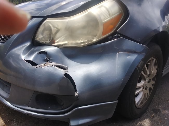

1. About 12 days ago my car overheated. I had to replace the radiator.

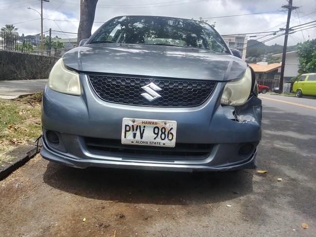

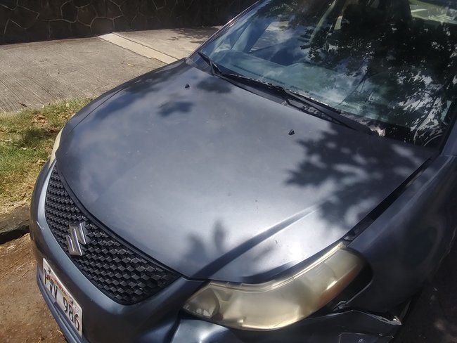

2. About 1 week ago someone hit my front end. He made a left turn into my car. Damage is bad, but I don't think the engine was damaged. Of course, I don't know. Mostly it looks like the bumper, headlight and hood damaged.(see pics)

As for the issues that you are having today, they could definitely be related to the accident. When a front end collision occurs, all sorts of things can be pinched or damaged. Clearly we will need the car inspected by a body shop or insurance adjuster to get the full scope of damage. That is not something we will be very effective diagnosing via the internet because most likely we are not dealing with just a failed component.
Then add in the fact that the vehicle overheated and required a radiator, that brings in the possibility of engine damage like a warped head or head gasket issue.

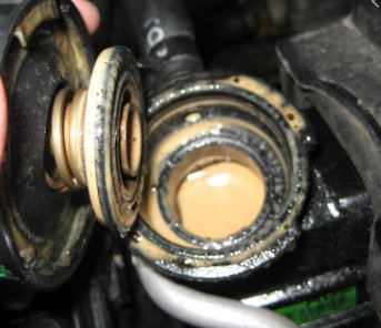

Thanks for your response. When you refer to "milky" looking oil, do you mean it will be sort of white in color? What does milky looking oil indicate?
May 4, 2020 at 6:45 AM

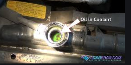

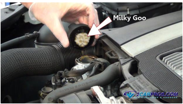

Correct. It can be anywhere from milk color to chocolate milk. I attached some examples. However, the more coolant that is in there, there whiter it will be.
Milky oil indicates the engine oil and coolant are mixing. This guides gives more detail:
https://www.2carpros.com/articles/coolantantifreeze-in-the-engine-oil
However, the most common cause is a blown head gasket. Let me know what other questions you have. Thanks
