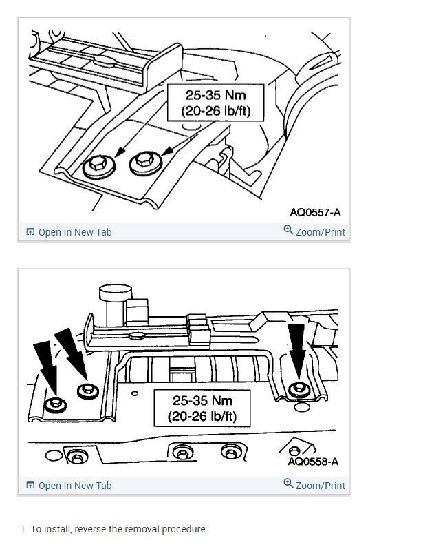

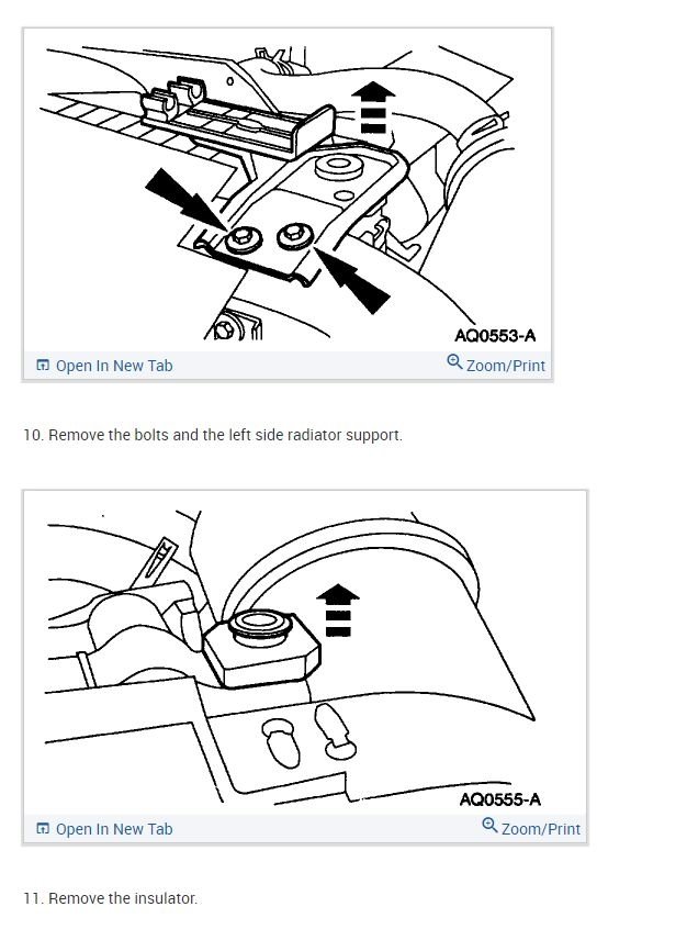

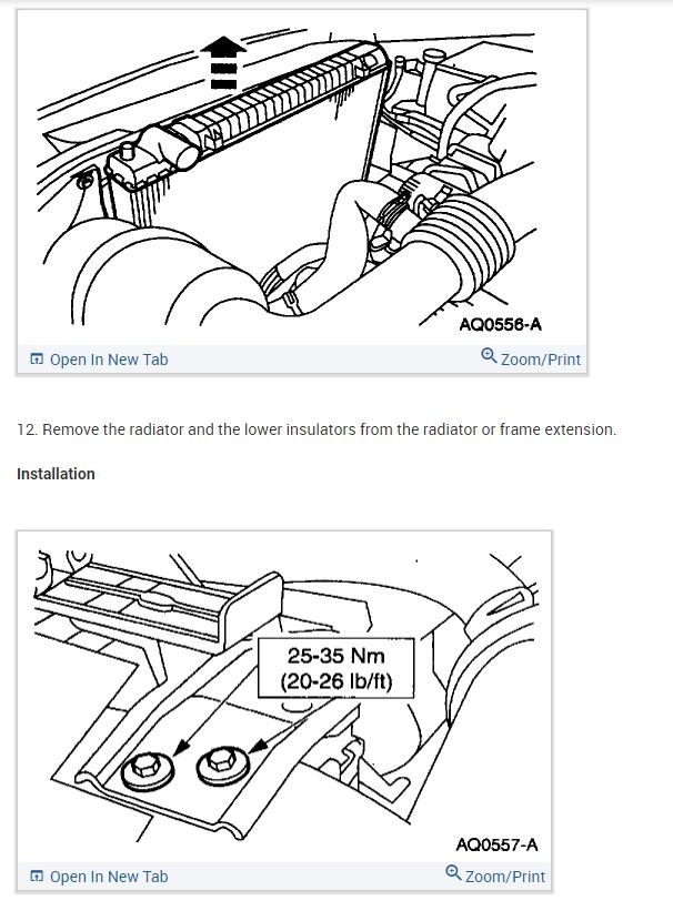

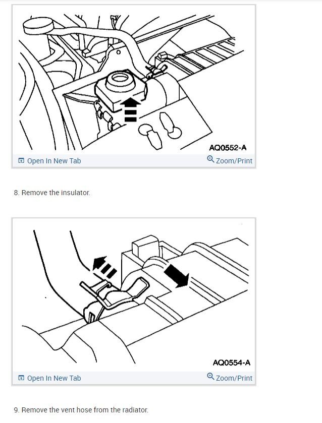

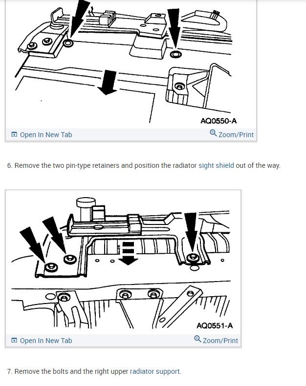

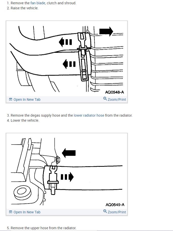

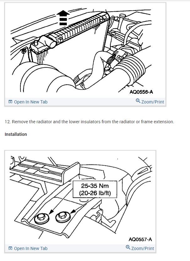

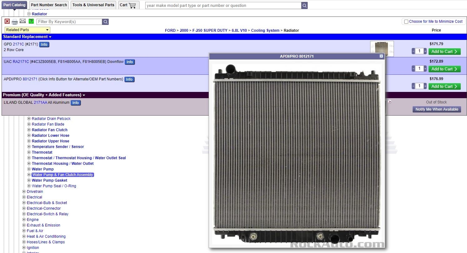

The only repair is to replace the radiator. It is the correct repair and it will last without the fear of it failing. I attached the procedure and also a radiator from rock auto for you to view.
https://www.2carpros.com/articles/how-to-replace-a-car-radiator
https://www.2carpros.com/articles/coolant-flush-and-refill-all-cars
