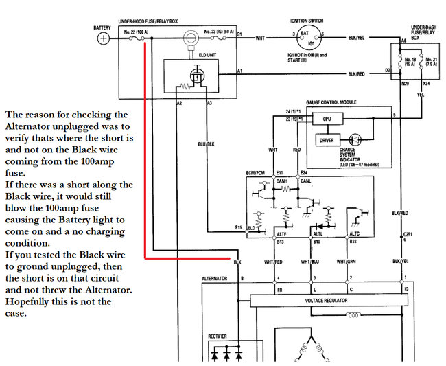

Hello, it sounds like you have a bad alternator, the 100-amp fuse is in series with the alternator. Not sure why you disconnected the negative to check battery voltage. You were reading 12.6 with the negative cable disconnected because you were reading voltage drop through the battery. Your alternator probably shorted out and blew the 100amp fuse. See if the Black wire on the alternator has continuity to ground (alternator case) with the 100 amp fuse out. Set your meter on Ohms, (resistance). It will probably read 0 ohms, meaning the alternator shorted out, and stopped charging, then the vehicle stalled out.
Here is a charging system wiring diagram, it shows the 100amp fuse in series with the Alternator:

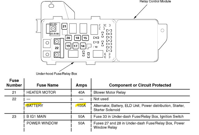

Was the 100-amp fuse actually blown? You stated your battery voltage dropped off when you pulled that fuse, did that fuse have a small plastic clear cover over it and that's how you checked the middle of it (central blade)?
these are the components powered by that fuse.

I checked 100-amp fuse with multimeter, side tab to central had continuity, other side tab to central did not! Looking through the clear plastic it was not very obvious.

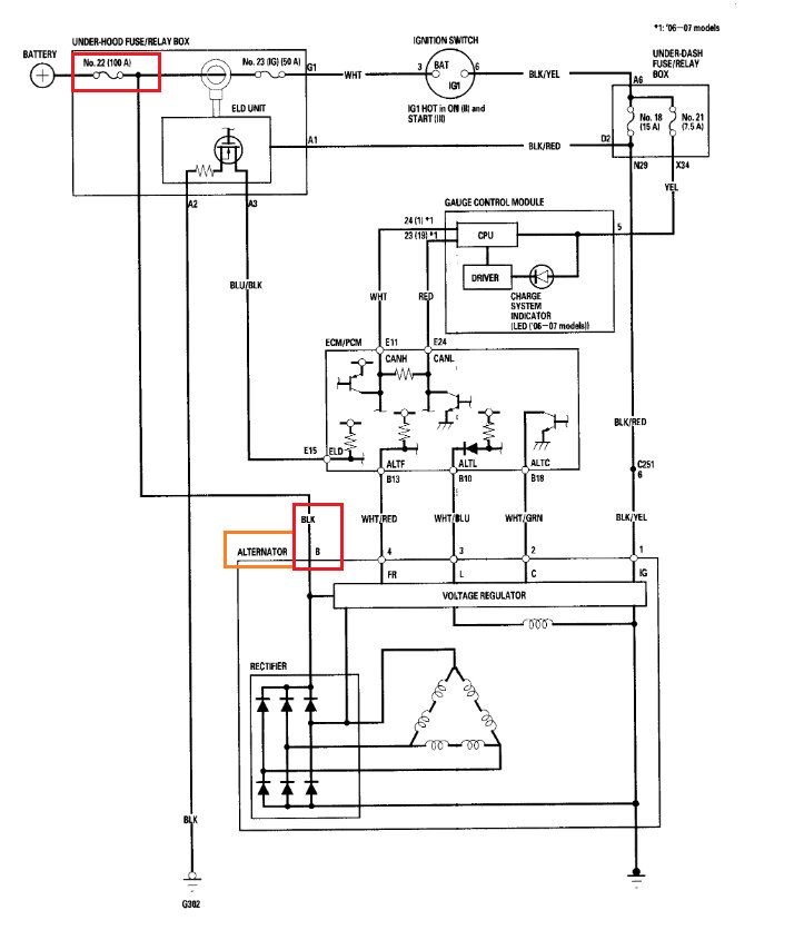

Okay, that's a really large fuse, so I would suspect the alternator. Also, since you had a battery light and then it stalled out. You can unplug that connector from the alternator and check each pin for continuity to ground through the alternator to its case and see if either the regulator shorted out or the diode trio. You can see the 6 diodes on the lower left side there. There shouldn't be a direct continuity to ground.

Oh dear, I did the previous test you suggested and have ordered an alternator, it did drop to zero on the Ohms test between black wire and ground! I am hoping this will arrive by the 29th of December. Services are not as good here in the UK. On another note, I have been slightly worried that my Euro spec. Accord is not the same as the US version (I know the Haynes manual was not the same). Time will tell.

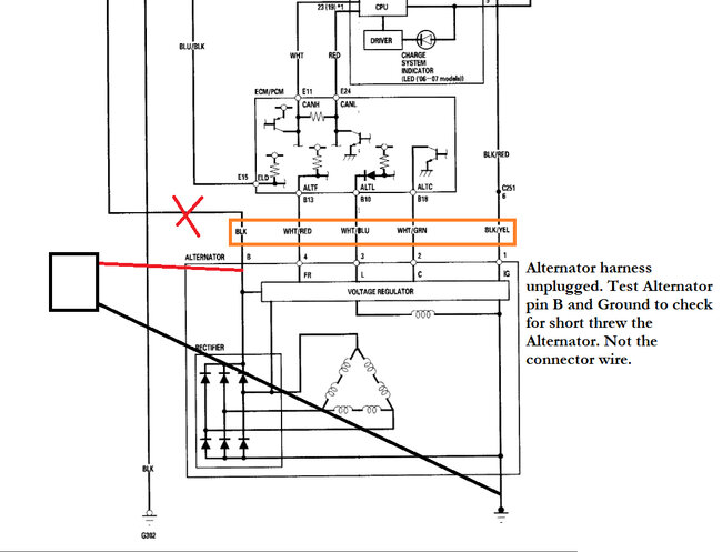

Did you test the pin that the black wire plugs into the alternator with the connector unplugged from the alternator? So that you were only checking the alternator for a short to ground? That 100-amp fuse (black wire) feeds other components as well.

Just to verify what you tested was not the black harness wire that is in the Alternator connector?

All sorted, it was the Alternator that was shorting out. New alternator fitted along with new 100 amp fuse, so far so good! Have run the engine for a few minutes, which is more than it has done for two weeks.
