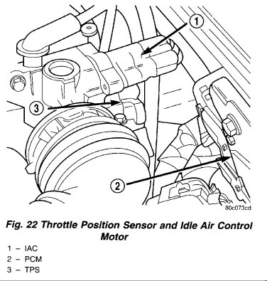

When I start my car the idle revs up to between 3,000 and 4,000 rpm's. Then it idles down to between 1,000 and 2,000 rpm's. The idle is very rough almost as if it is going to stall but it does not. If I push on the gas peddle it revs up and stays for a couple of seconds then idles back down to a very rough idle. Every time I started it the rpm's rev up to increases. What could be causing this?

Hello and thanks for using 2carpros.com. Since the problem deals with the idle, I would recommend starting with a component called the idle air control valve (IAC). The IAC meters the air into the engine which maintains the idle.

And finally, I attached a picture that will help you identify the part on your vehicle. The picture is specific to your vehicle.
