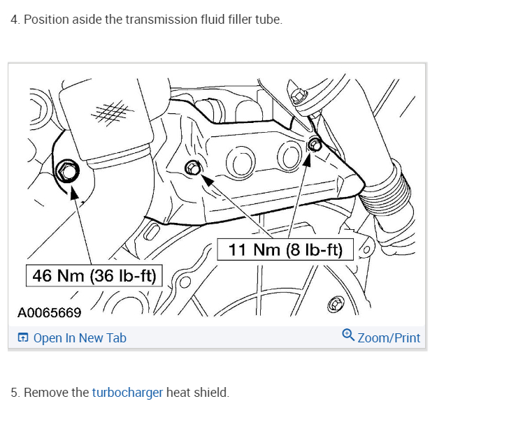

The truck has a no start condition unless I ground the yellow and red wire coming into the IPR then it will start.
Feb 19, 2023 at 10:23 AM
  • 55,721 POSTS

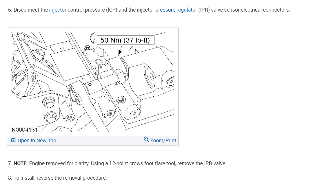

It sounds like the Injection Pressure Regulator went bad, but can I ask if you have run the codes? This guide can help, also how did you come to find this problem of grounding the wire to make it start?

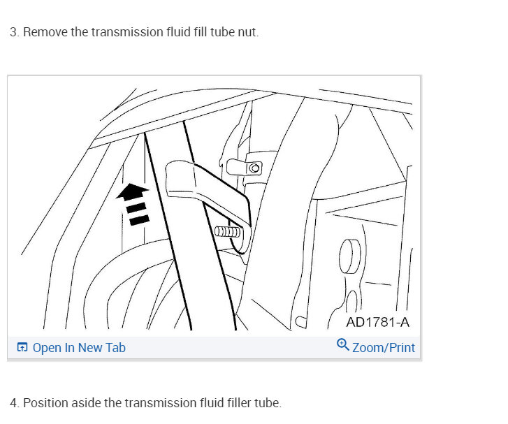

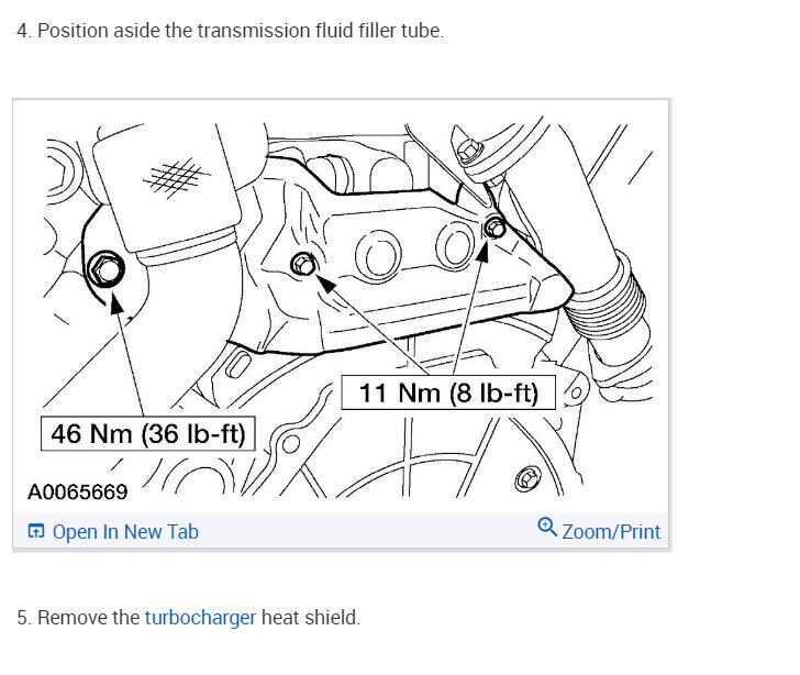

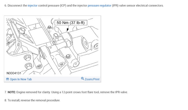

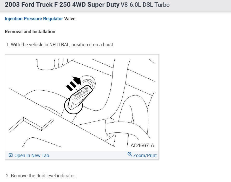

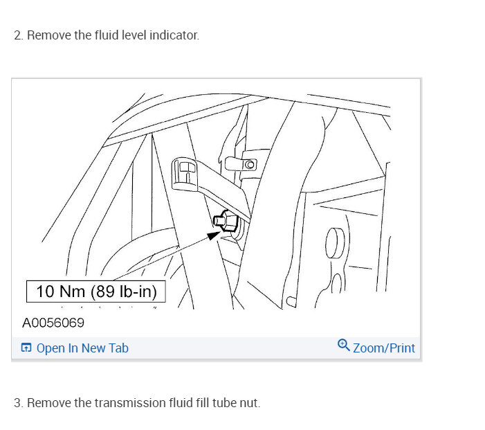

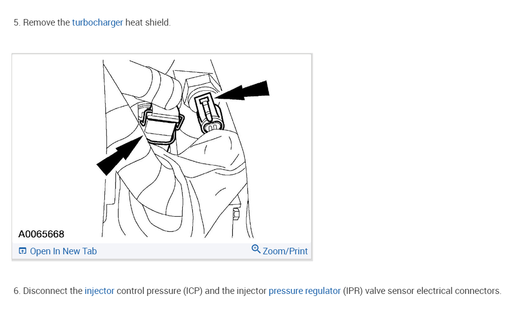

If no codes are present here is how to change the valve out for a new one in the images below. You can find a new unit on Amazon for $49.00.

Sorry, I haven't had much time I replaced the IPR yesterday. Is still doing the same thing.
