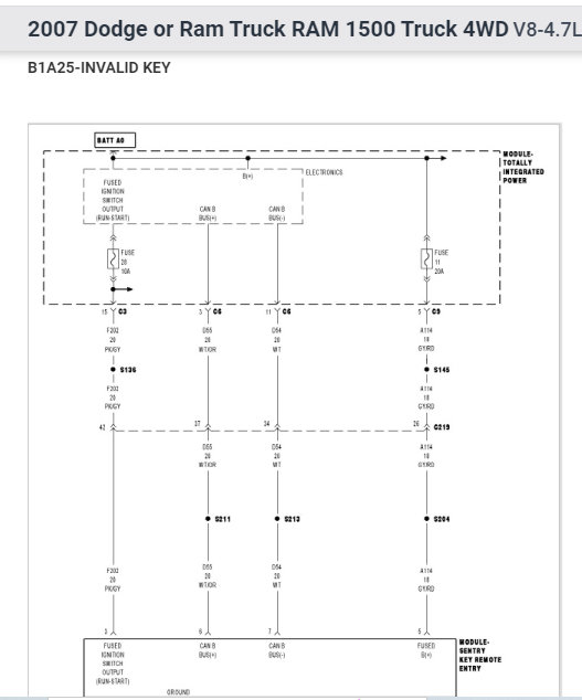

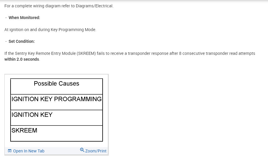

As far as the issue, it should have set a B1A25 code. It could need programmed, but that shouldn't be the case. Do you have a spare key to try? When you replaced the engine, could there have been grounds damaged or anything left disconnected?

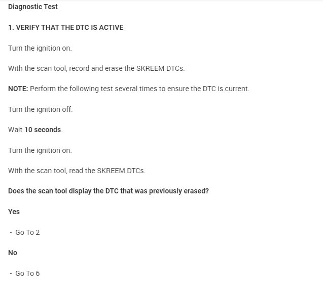

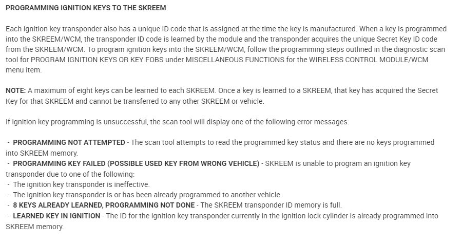

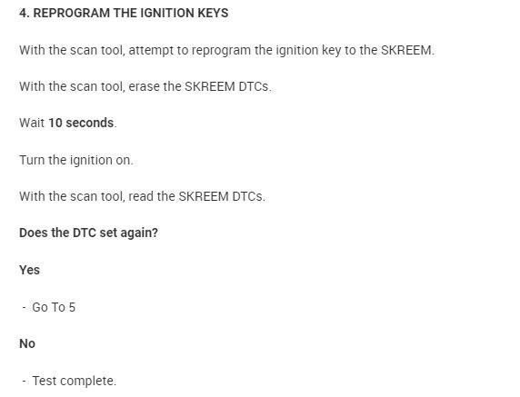

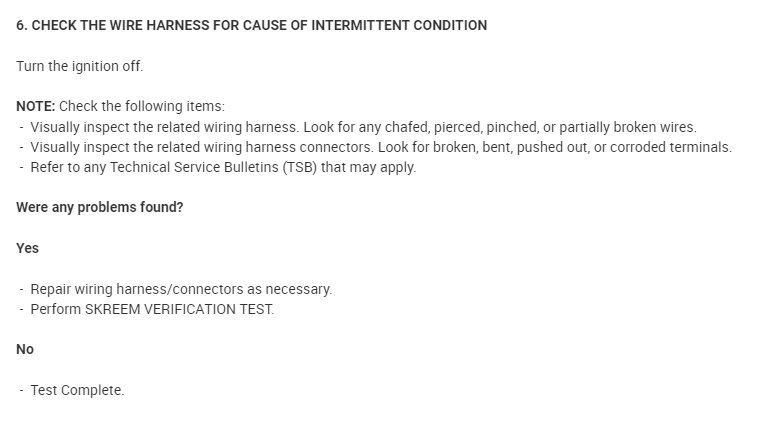

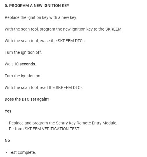

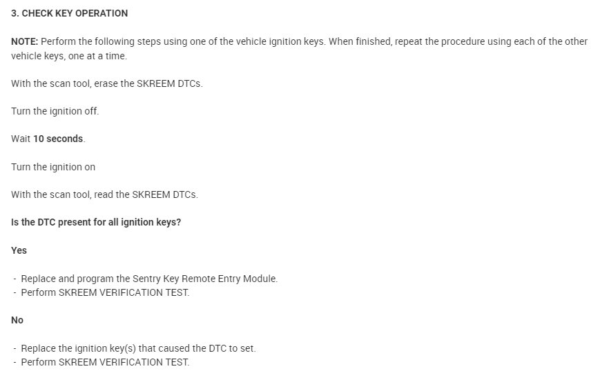

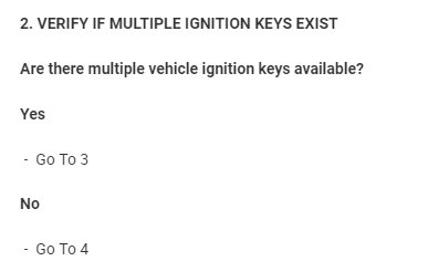

Here is what I suggest. I attached the diagnostics below for the aforementioned codes. Part of the diagnostics includes reprogramming the key/skreem. I am not familiar with the scan tool you have, but pics 7 and 8 are the procedure for reprogramming the skreem. The last pic explains how to program a key.
I hope this helps. Let me know.

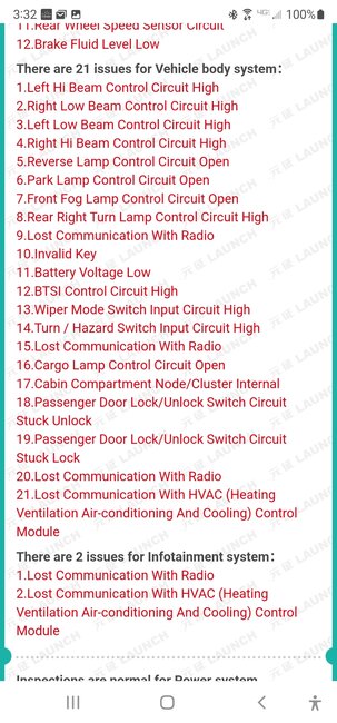

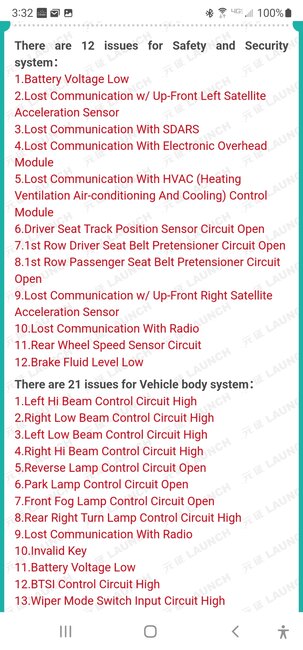

Here are the codes I got. And no, I do not have a spare key for it.

Wow! That is a long list. Does anything listed work correctly? Based on what I see, I question if the key is the issue. Have you checked connectors at different modules? For example, the body control module.
Oct 8, 2022 at 2:21 PM
MICHAEL RAINEY JR
No, I have I don't have any of the lights like the headlight or taillights plugged in nor do I have the o2 sensors plugged in the only sensors plugged in are the ones to the engine and transmission.
Oct 8, 2022 at 2:52 PM
  • 110,240 POSTS
Interestingly, there are so many, I'm not sure where to start. I can't be certain, but it appears the PCM may have failed.
