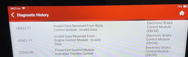

The traction control will come on once in a while car shakes when driving at higher speeds. Invalid data?

Ya, I got a few codes did it not post? I will try add the image again.

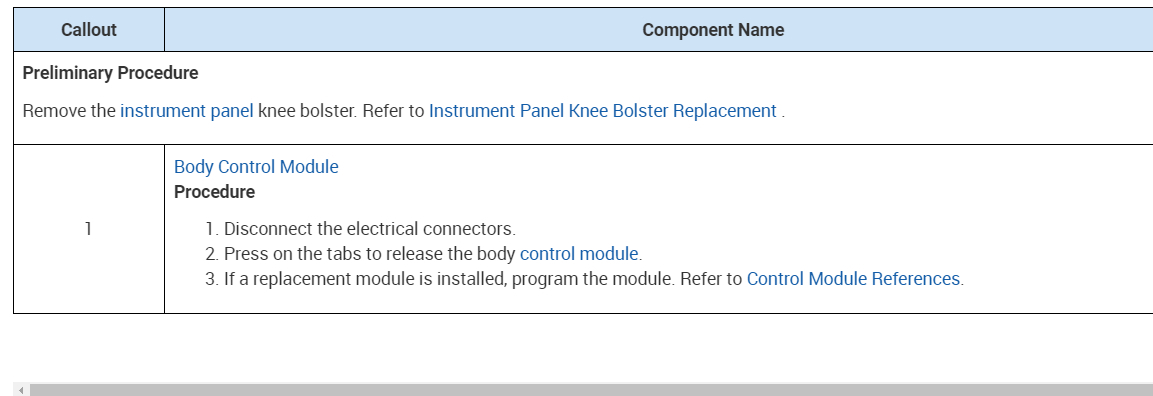

Was this truck in a flood or an accident? It looks like the BCM has gone out, but I would start by checking all fuses with the systems on. This guide can help:
The U0422 code in a 2017 GMC Sierra indicates a problem with the "Invalid Data Received from Body Control Module" or BCP (Body Control Module "B").
The U0401 code is a generic diagnostic trouble code (DTC) that indicates a communication problem between the Engine Control Module (ECM) and the Transmission Control Module (TCM)

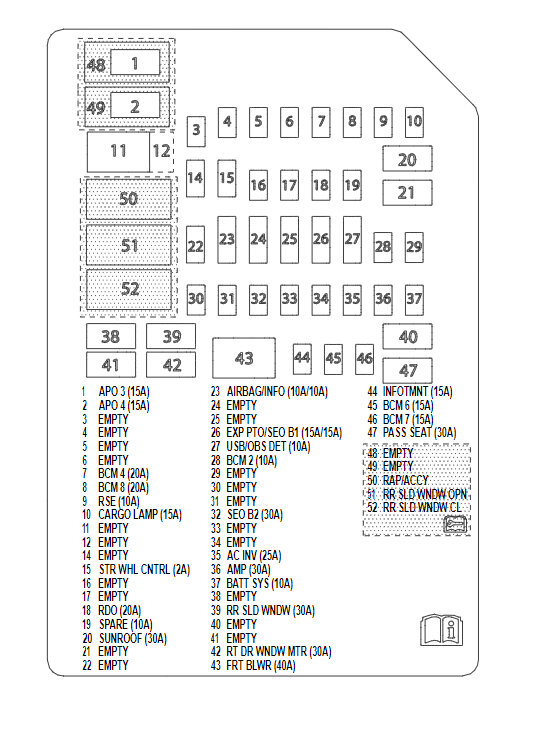

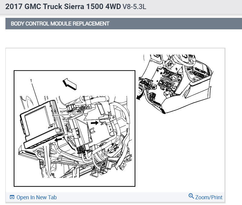

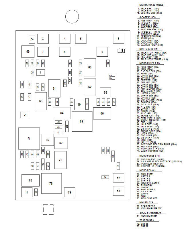

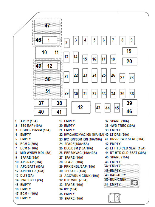

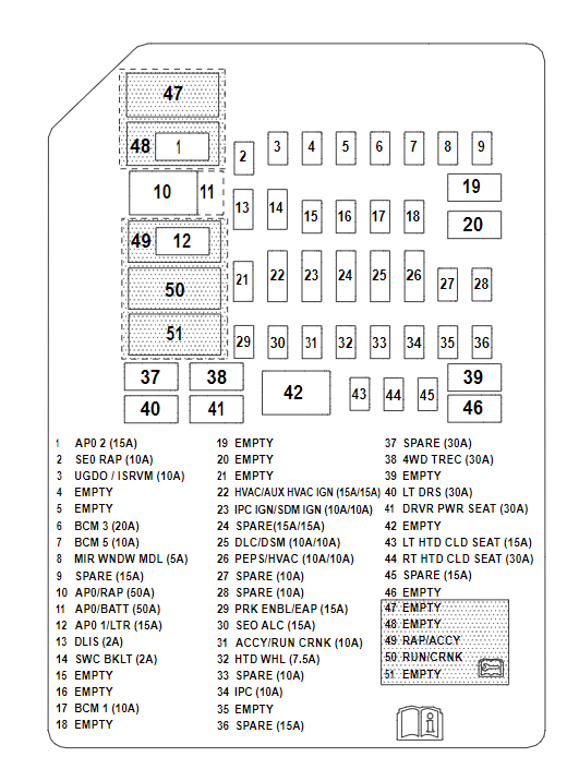

Here are the fuse locations so you check run the test and I have included how to change the BCM out as well, you can get a preprogrammed unit by searching Google or Ebay. Check out the images (below). Please let us know how it goes.

Also, is there a reason that all those codes are coming from the EBCM?

Okay, it looks like the EBCM has gone out, please follow the steps above to fix the problem. Please let us know how it goes.
