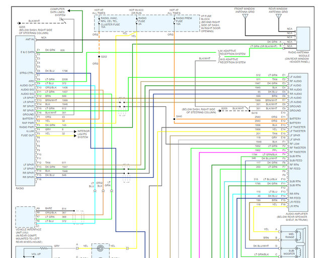

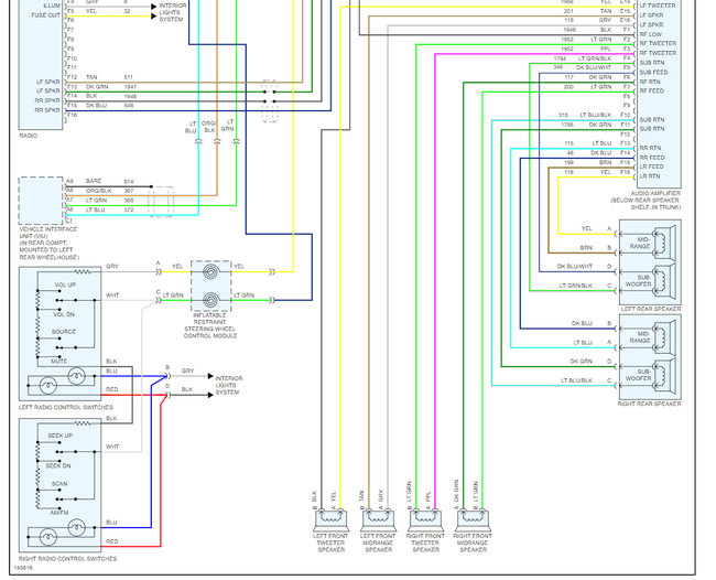

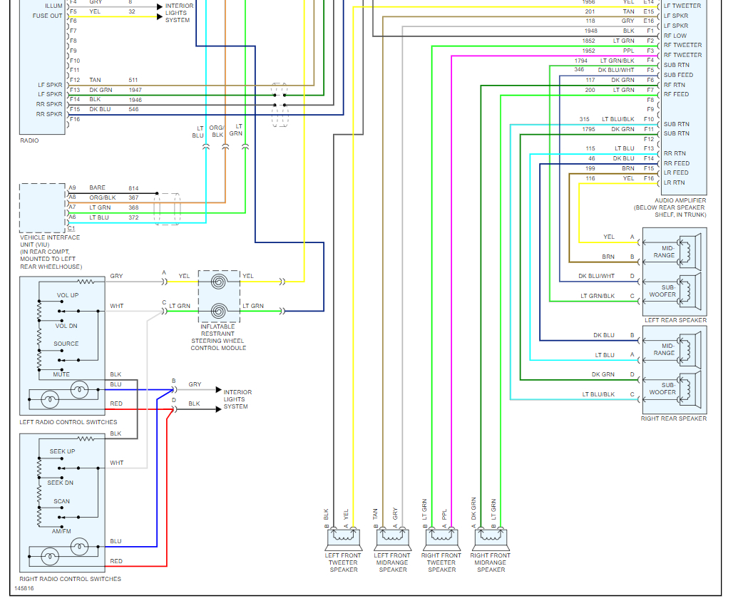

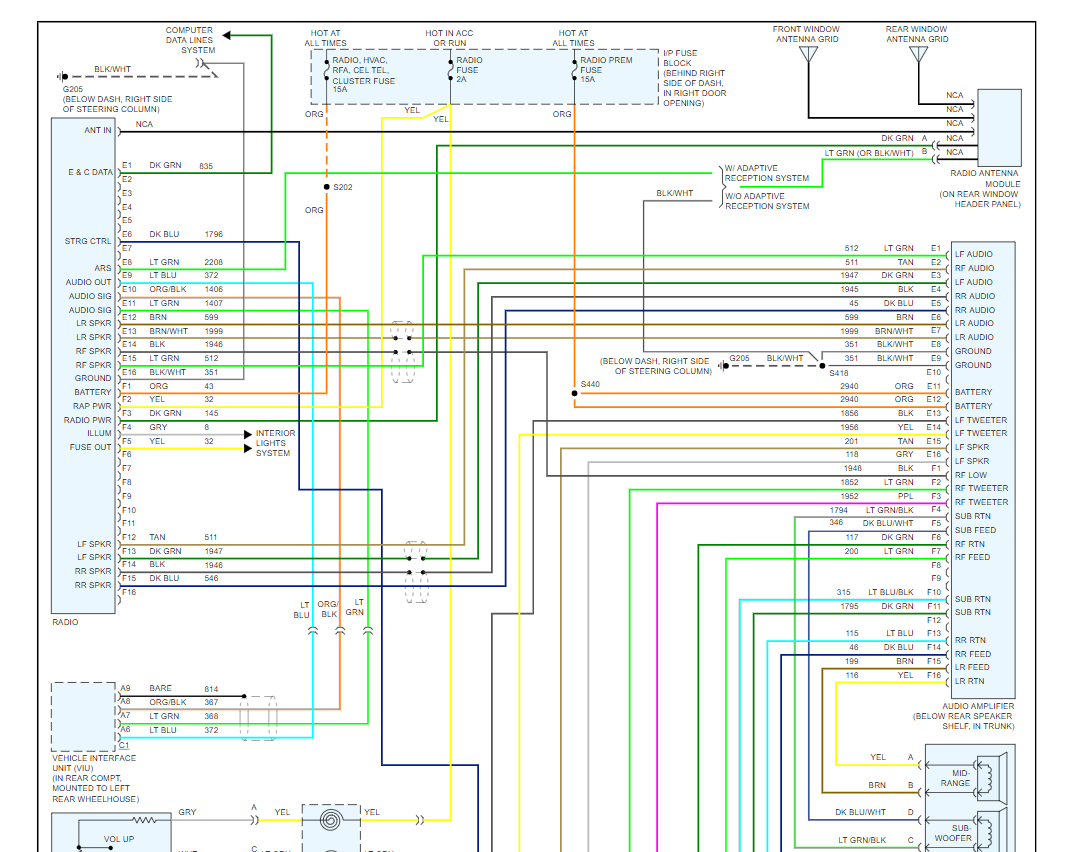

here are the radio wiring diagrams and a guides to help you do some testing. please create another post to get the info on the instrument cluster there is only one subject per thread.
