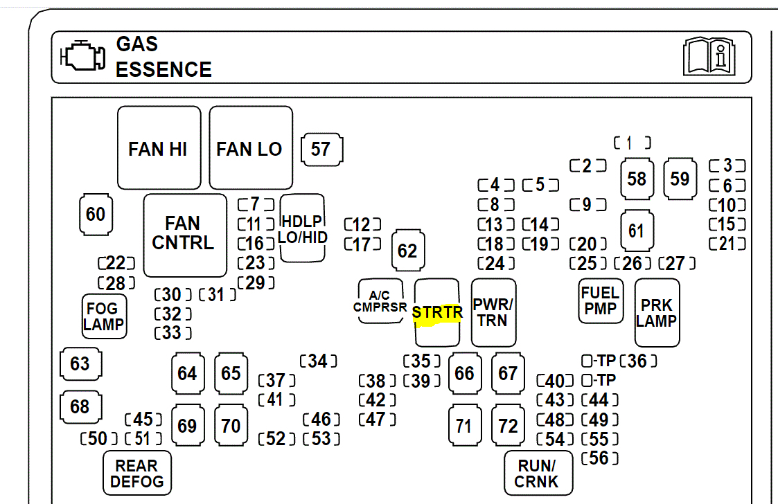

intermittent no crank no start issue
2008 GMC YUKON
199,000 MILES • 6.2L • V8 • 4WD
GREGG SWAN
but starts when i connect battery to starter fuse. has gotten progressively worse over time. once it starts it seems to run fine. When the truck stalls out after it sits an hour or se then it usually will start.

I need some verification. Do you mean the engine stalls and won't restart until it cools off or is this a starter problem?
If the starter itself is the issue, there could be a few causes. The starter itself could be going bad, the starter relay could be bad, and so on.
If the problem is it stalls and won't restart until it cools, that sounds like a typical faulty crankshaft position sensor.
Do me a favor. Take a look through these links. The first one covers common symptoms of a failing crankshaft position sensor. The second explains how to diagnose a bad starter.
Let me know if the symptoms seem to mirror what you experience or if checking the starter helps.
Also, check the starter relay itself. If there is another one in the box having the same part number, switch them to see if it makes a difference. If there isn't, here is a link that shows how to test a relay:
Let me know what you find and what I can do to help.
See pic below of relay location. (under hood)

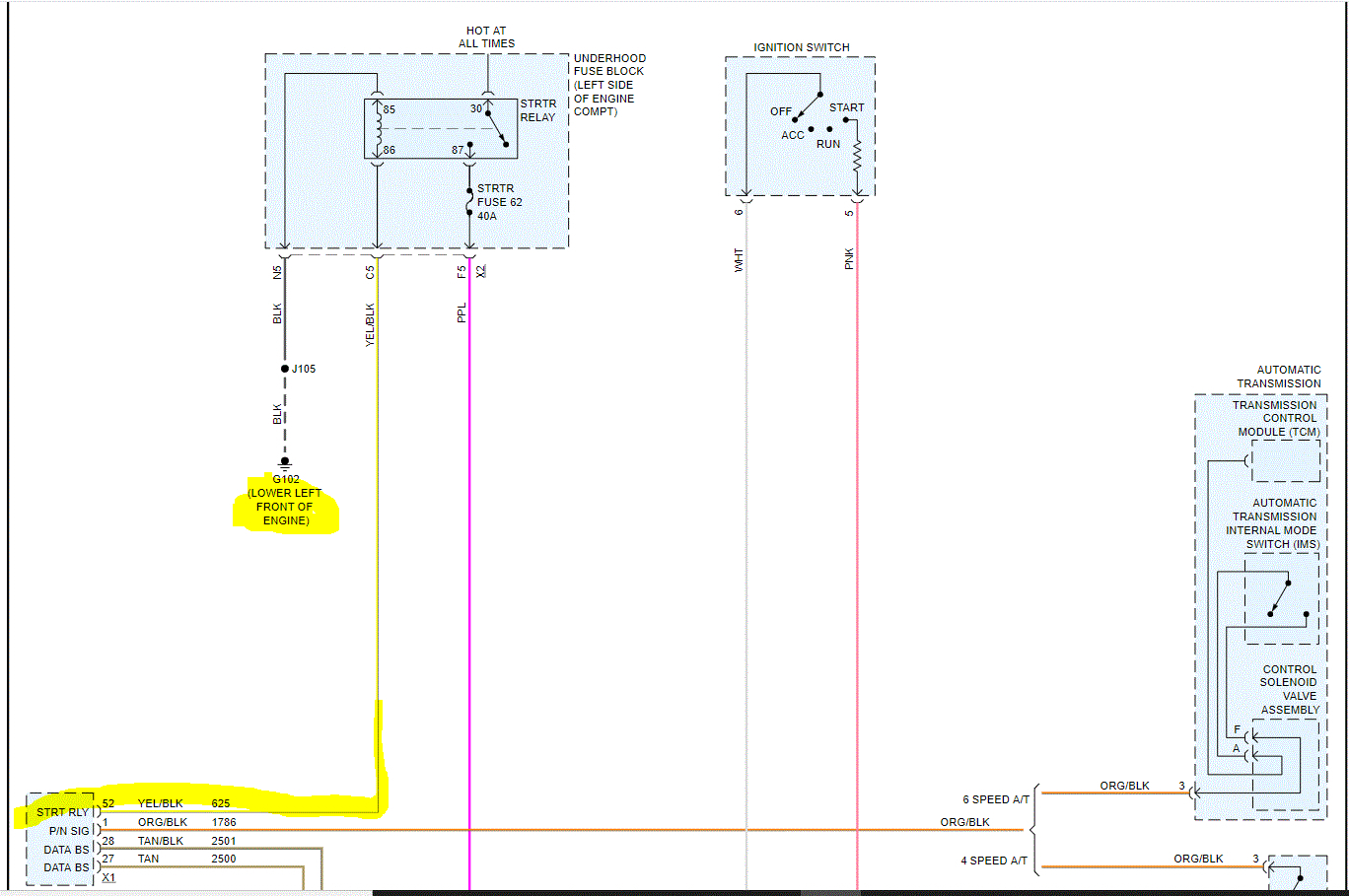

Just to clarify, the truck runs normally with no symptoms until I go to restart it!
It either won’t do anything when I turn the key or it’ll turn for about 3 seconds then stop.
When I jump a hot wire directly to the starter fuse it turns and starts normally every time.
I swapped out the starter and crank relays with the defogger relay with no change
It seems when I move my shifter back and forth a couple times it seems to help it start, not sure though.

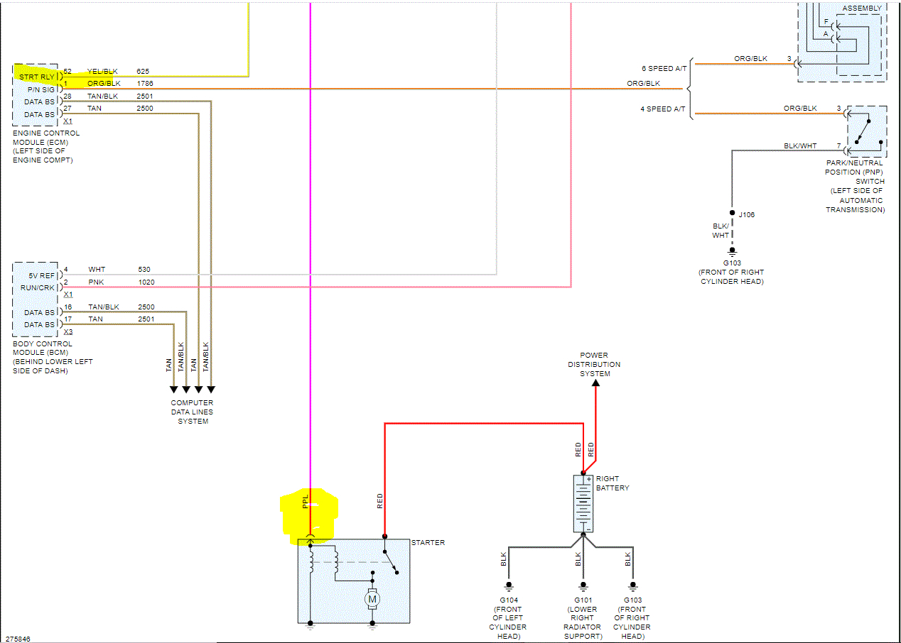

I attached the wiring schematic for the starting system below. Tell me which pin you power to make it work. Or, do you jump it right at the starter?
If it isn't the relay, we are going to need to work backwards to see where power is lost. It could be the powertrain control module or the BCM as well.
If you haven't already, make sure the ground for the relay is in good condition and make sure the fuse after is tight and not corroded.
Let me know what you find.
