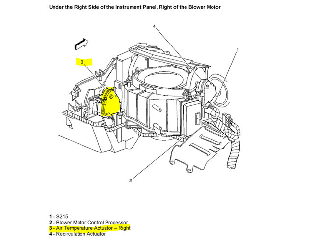

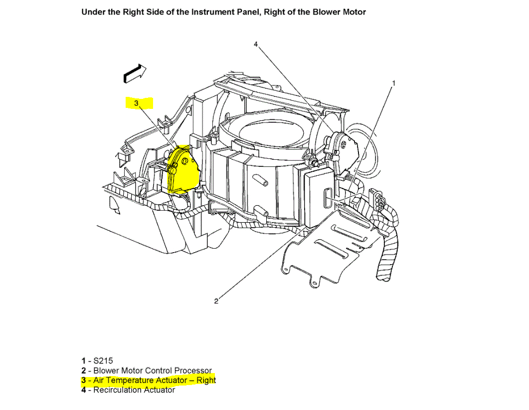

The driver side works fine. This problem only involves the passenger side. Turning the car off and back on sometimes clears the issue. I determined it was the blend door actuator and ordered the part. I'm trying to install it now but don't see the part after removing the under panel. Do I need to remove the glove box?

They can be a bit difficult to find. If you look at the first pic below, I highlighted the actuator for the right side.
To get you started, here is a link that shows in general how it's done. You can use this to help guide you.

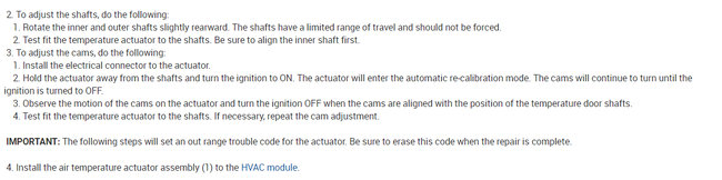

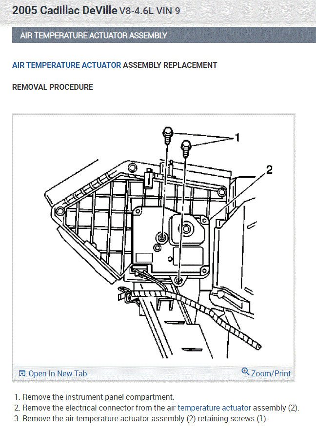

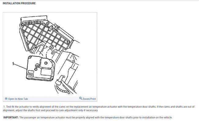

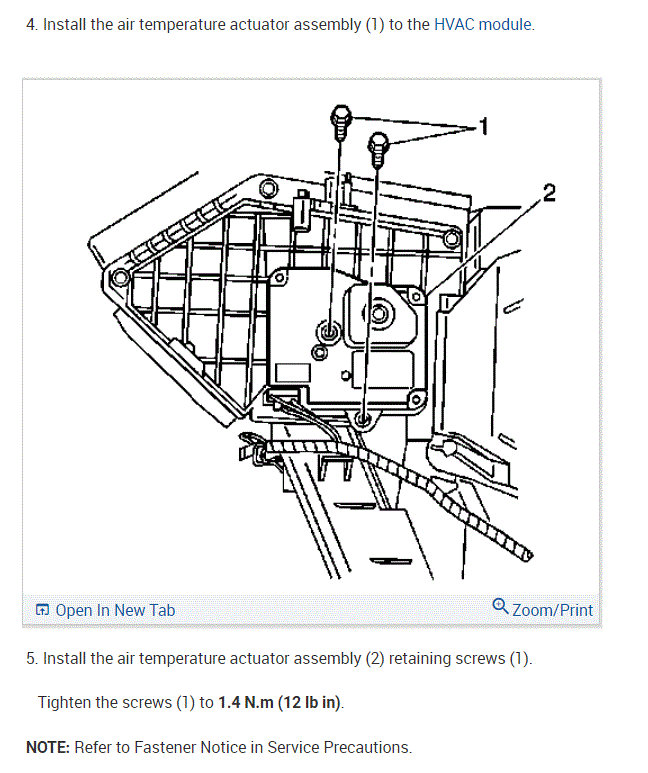

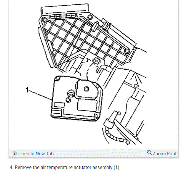

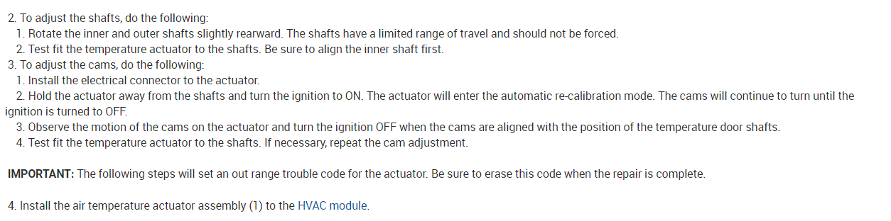

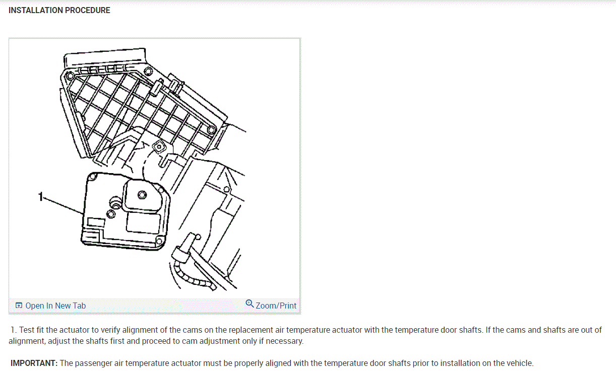

If you look at the remaining pictures below, they include the directions for removal and replacement specific to your vehicle.
