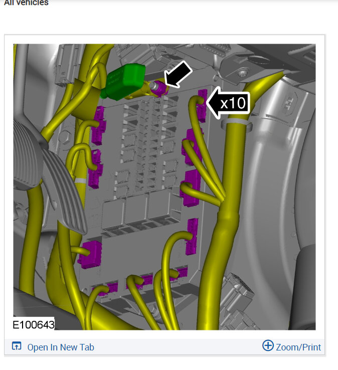

The intermittent wiper function doesn't work on the stalk, all other wiper functions do.
Apr 24, 2024 at 1:00 AM
  • 54,832 POSTS

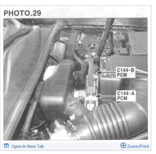

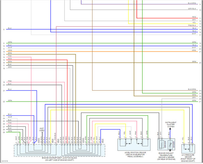

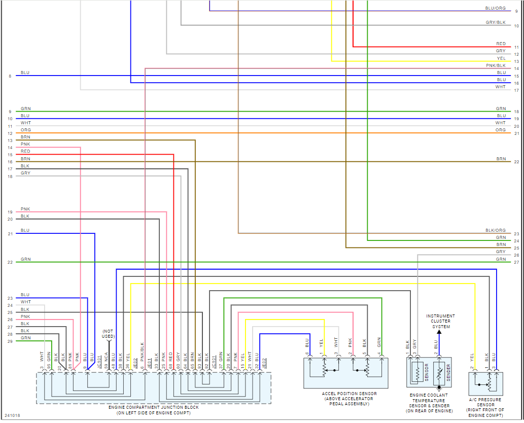

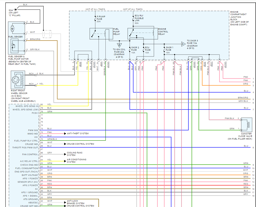

It sounds like the central junction box has gone out, but we should check the fuses and grounds for the system, here is a guide that can help:

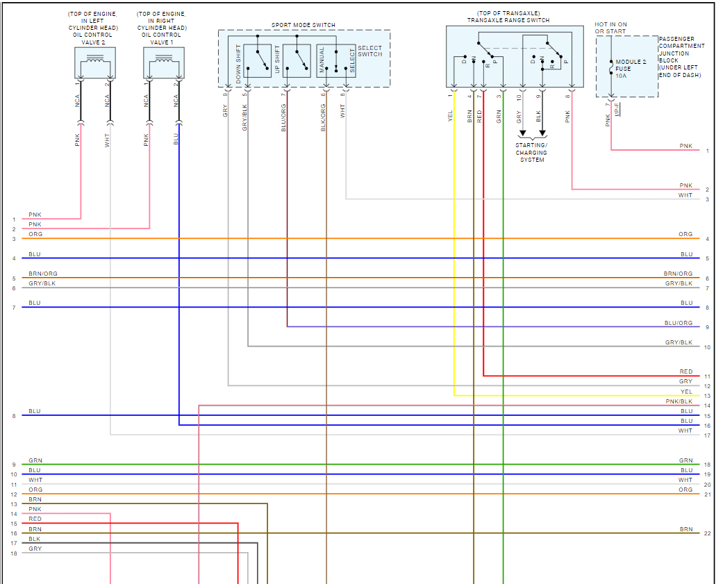

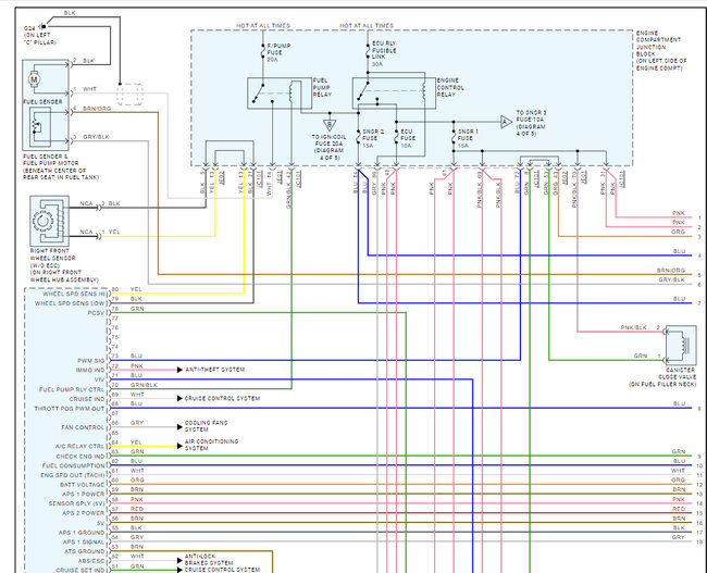

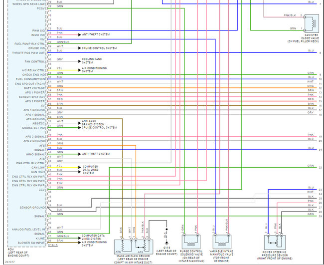

Here are the wiper wiring diagrams so you can see how the system works and which fuses to check with the ground locations. Also, you may be able to do a CAN scan to see if any codes come up for the central junction box. You can get a CAN scanner (Controller Area Network) which will work on most cars from Amazon.
https://youtu.be/u-4syLc-ifQ
and

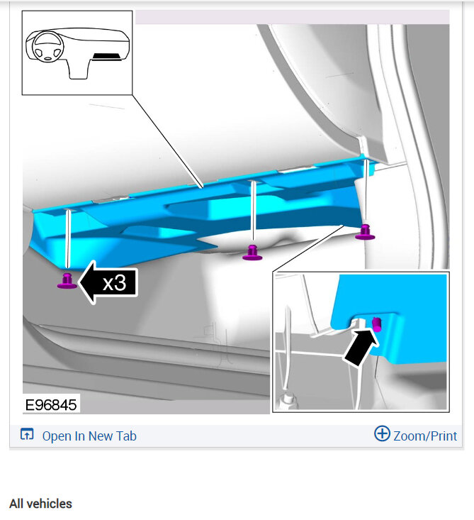

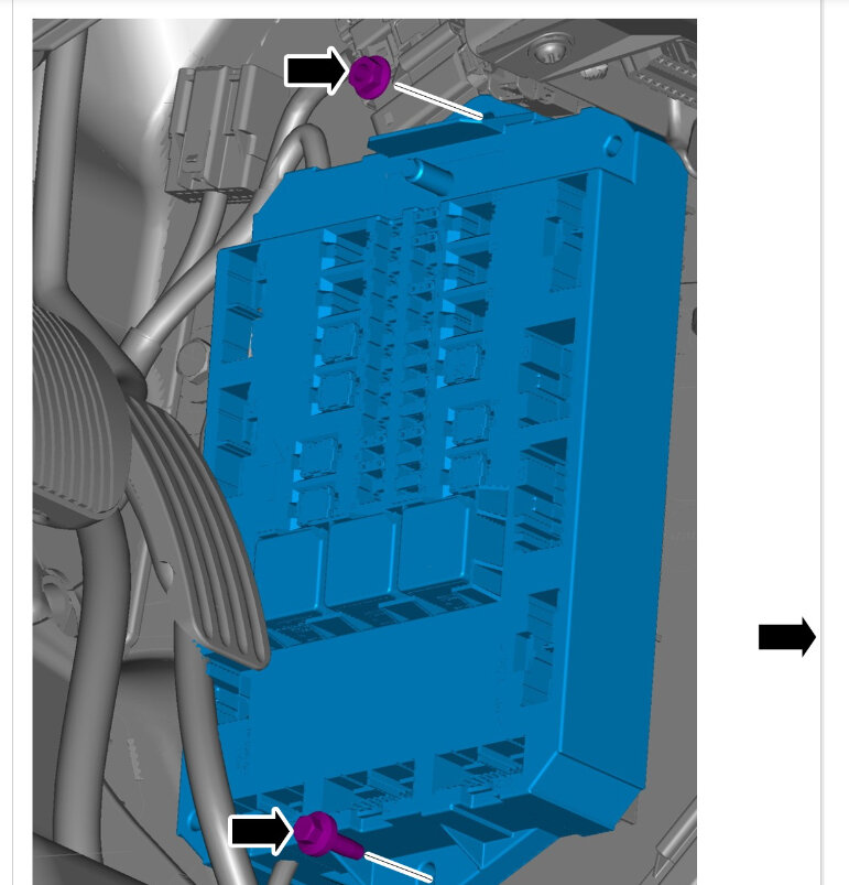

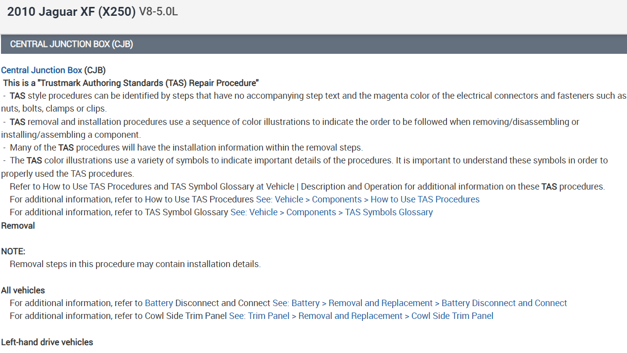

Here is how to change the CJB out in case you need it. Check out the images (below). Please let us know what happens.
