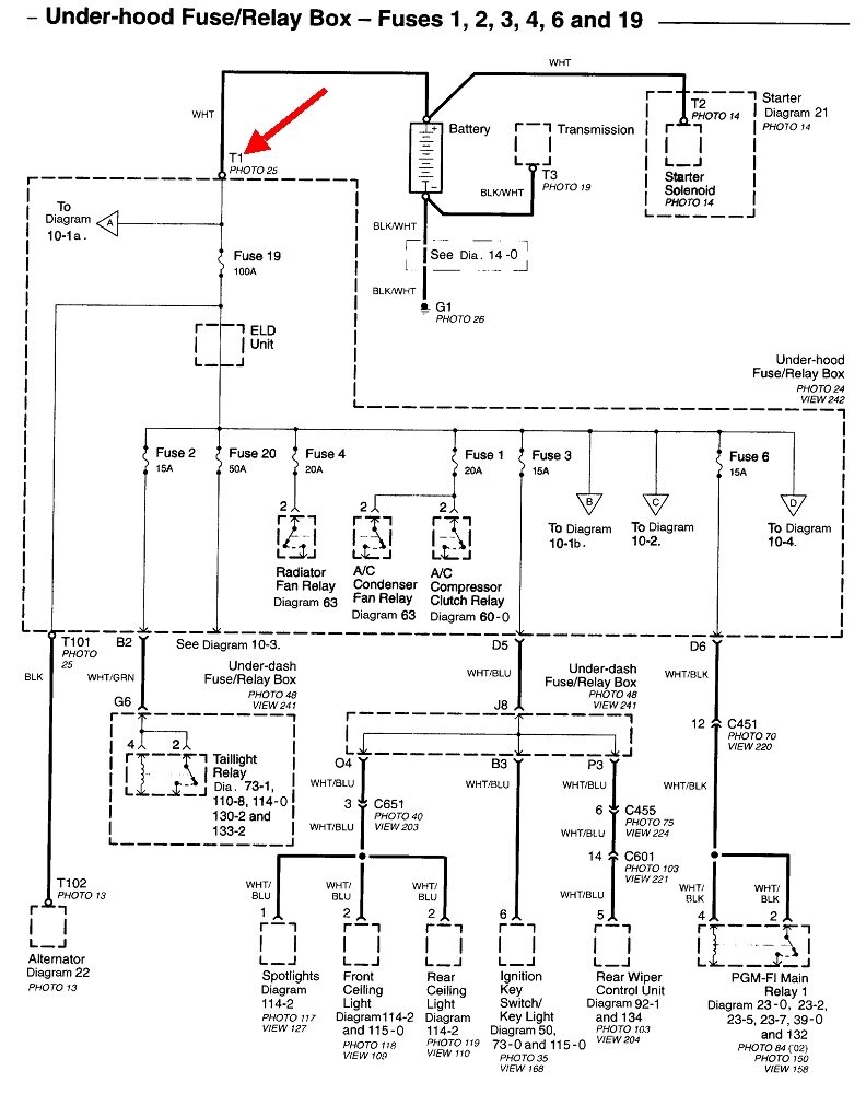

intermittent starts for approximately three months, eventually starts, have not been stranded:
Turn the key all the way on, dash lights come on for a couple of seconds then turn off, and nothing...no sound (dead silence). Turn the key back to off, green key light on dash flashes 10 times or so, turns off; do this a few times and it begins to turn over on the 3rd or 4th try and will start.
And now after 3 months of that scenario, I now have to push the gas pedal for it to catch a start when it does turn over (turn over is usually slow).
OBD reads only O2 sensor issue, but have had that for 2 years (yes, need to change).
Added new spark plugs 2 weeks ago, got about 10 no problem starts, and the issue began again. Found oil in one spark plug well, replacing valve cover/o-ring (top) gaskets & ignition coils next week.
Read everything it could be, checked symptoms of those items, and of the issues listed, the car doesn't have symptoms of those failing parts.
What could possibly cause a completely dead reaction with key in on position, (as mentioned above) until the third try, and then the engine begins to turn over and I give it gas and it starts?
Thank you for any input, no matter what ideas you may have...please tell me.

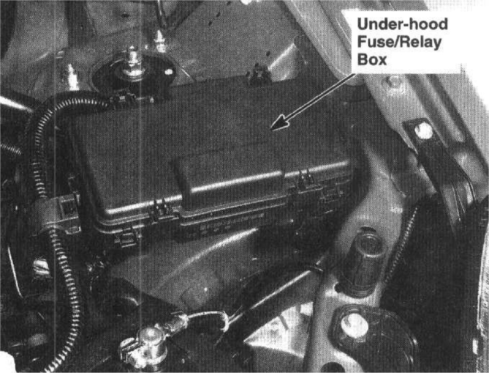

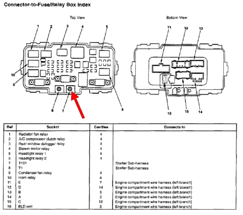

A common cause of this is a loose or corroded battery cable clamp, but even more common on all brands and models for many years is a loose bolt that connects the smaller battery positive wire to the under-hood fuse box. I added the red arrows to these drawings to show what to look for. Tighten that bolt.
Be careful when using metal tools on that bolt. It must not touch that bolt, (or nut) and any metal part on the body or engine at the same time. That would cause a huge shower of sparks and can even weld the tool in place and turn it red hot. The danger potential is only there when someone isn't aware of that possibility. Just be careful and it will take longer to open the hood than it does to tighten the bolt.
Let me know if that solves the problem.

Hey, thanks for such a quick reply! ...sorry it took a while to get back...after checking and re-checking the devil was in the starter after all, it's too bad that's a part that has to be bench tested causing it to be a more expensive fix. Your suggestion was a great tip to tuck in my pocket for any future issues, those wires do look great on that fuse box...no corrosion or looseness. You were awesome in your response, very grateful for your input!!
