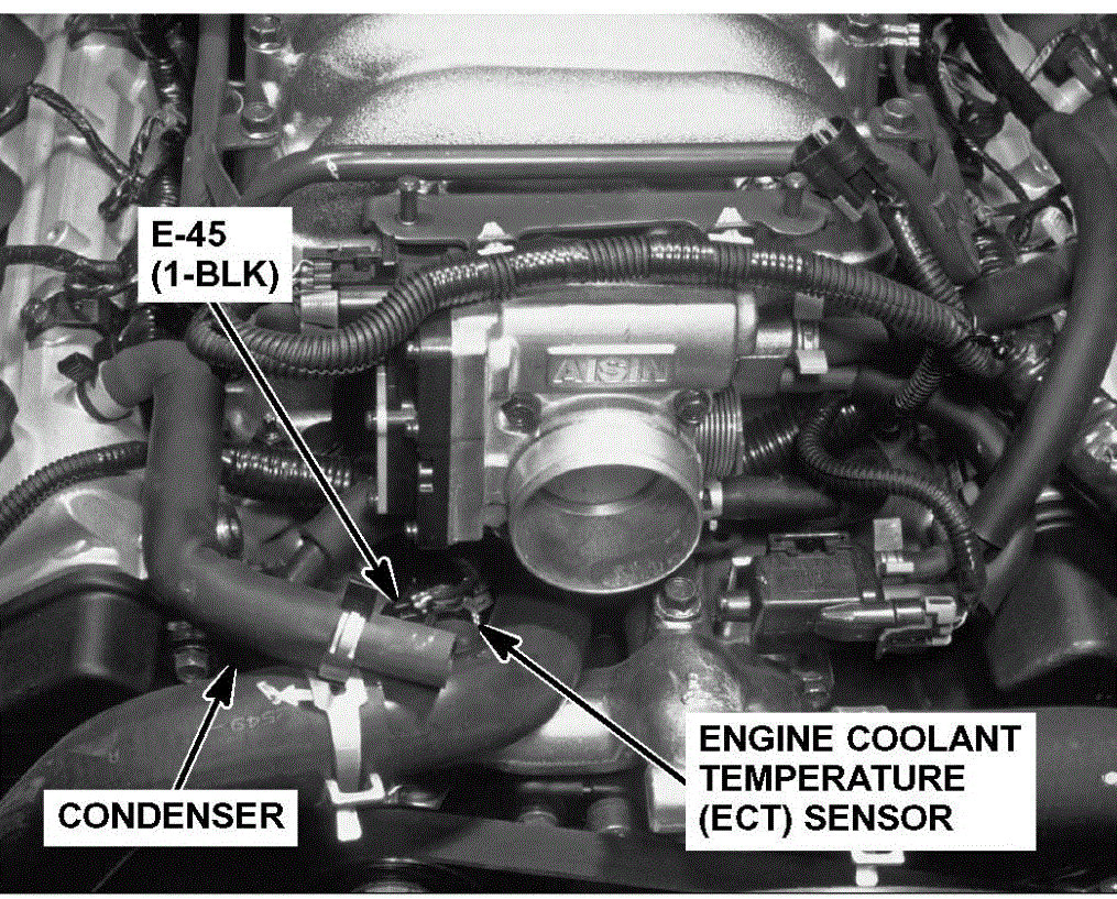

intermittent starting problem, locations of ECT sender/sensor needed
2003 ISUZU RODEO
90,000 MILES • V6 • 2WD • AUTOMATIC
TOM1963
Please show the locations of ECT sender/sensor for the vehicle listed above for replacement. picture and/or diagram would be great help. thanks.

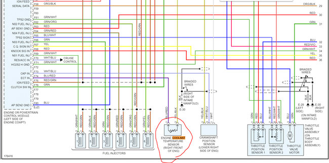

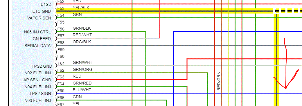

The first pic below shows the location of the ECT. Pictures 2 and 3 are portions of the wiring schematics. Pic 3 shows ECT ground and the arrow I drew goes to the sensor. Pic 2 shows signal in.
Let me know if this is what you needed or if you have other questions.
Jul 8, 2020 at 11:13 AM
TOM1963
Thank you, Joe. this is what I need. I did search for this for several days and couldn't find anywhere for my SUV. Thanks again.
