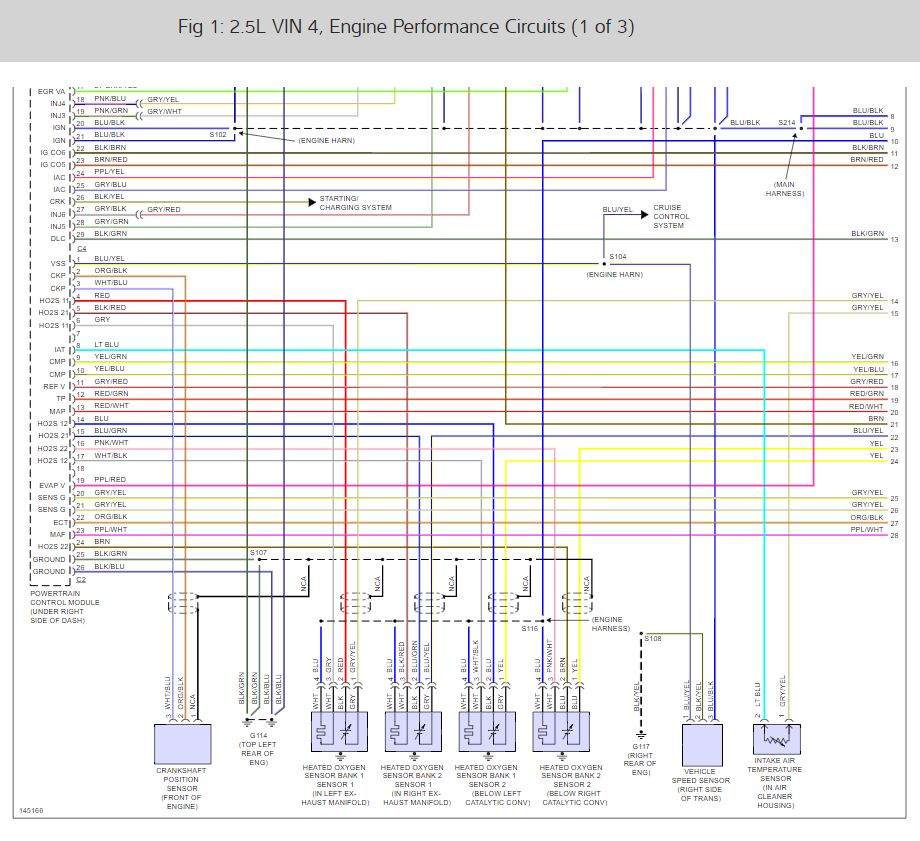

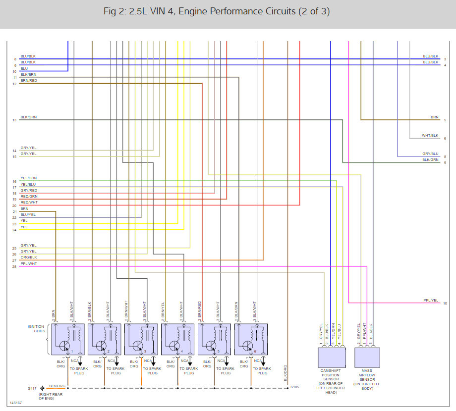

tracker will not start sometimes. changed crankshaft sensor still having no start problems. Could it be camshaft sensor? it will just turn over then it will start.

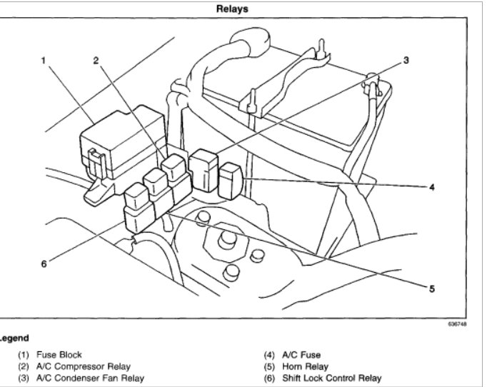

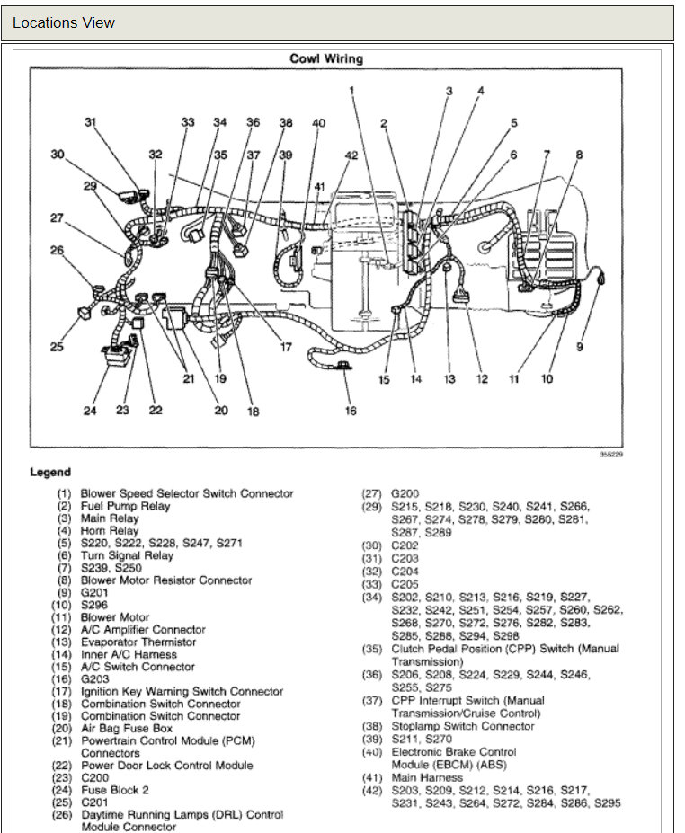

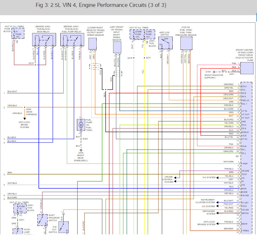

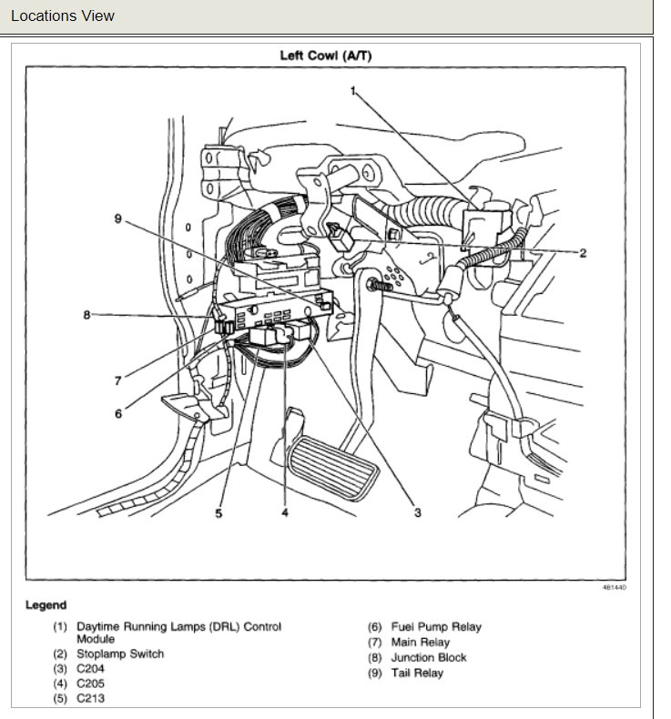

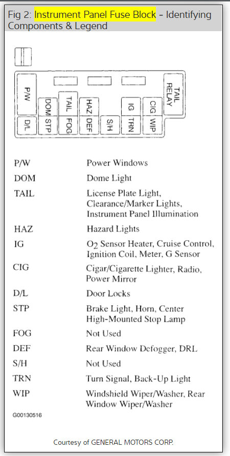

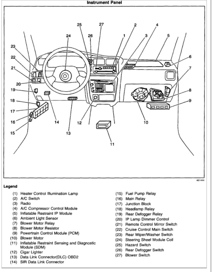

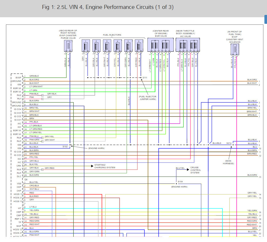

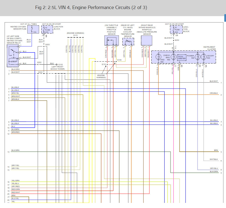

The fact that the check engine light does not come on with the key on means the system is not powered up. This could mean the EFI (main relay as it is called in this car) is not working this relay is located under the dash on the drivers side. Here is a guide to help you check the relay and also check the fuses:
and

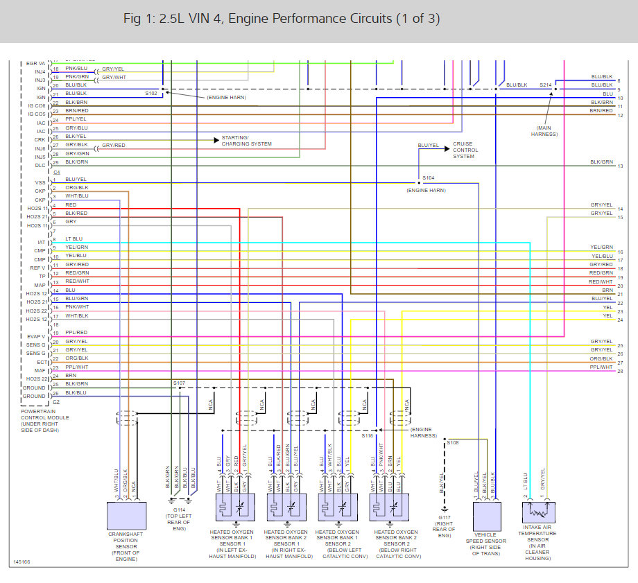

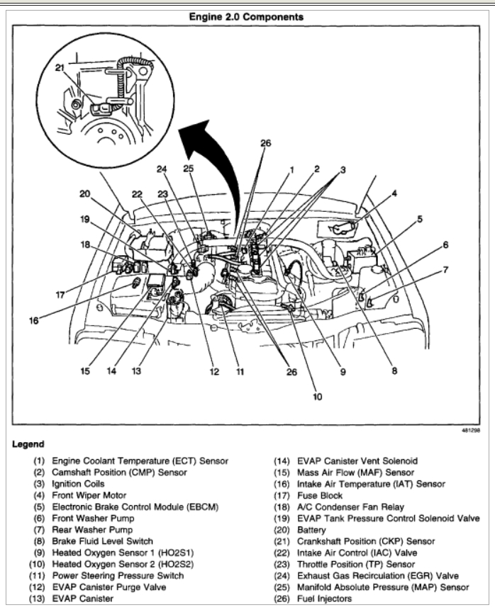

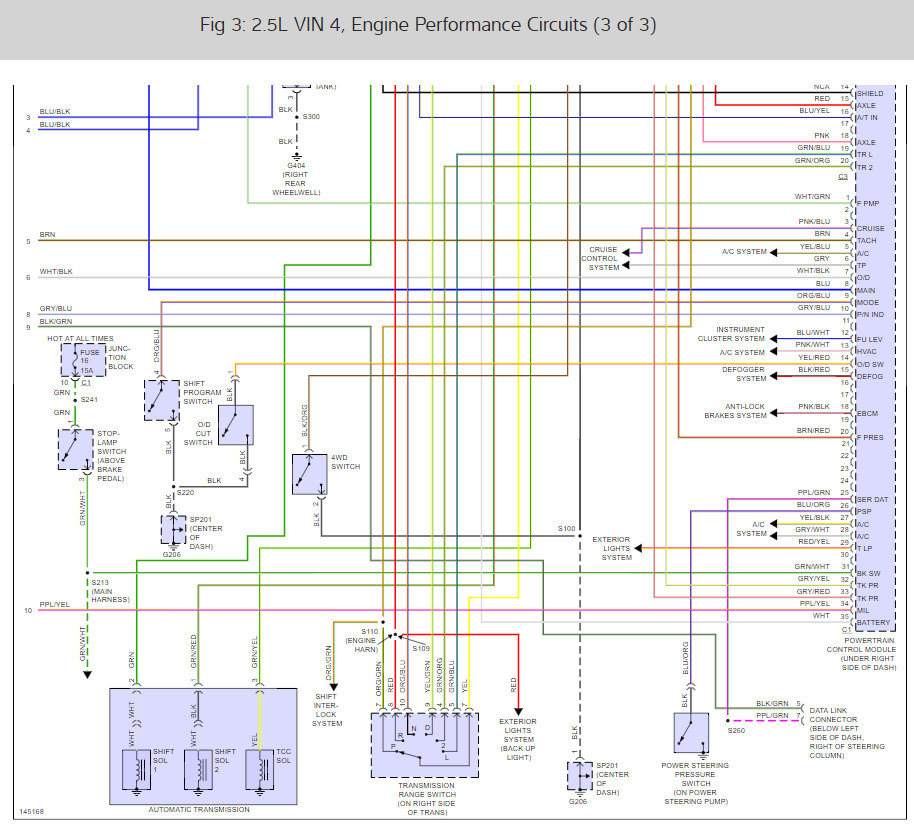

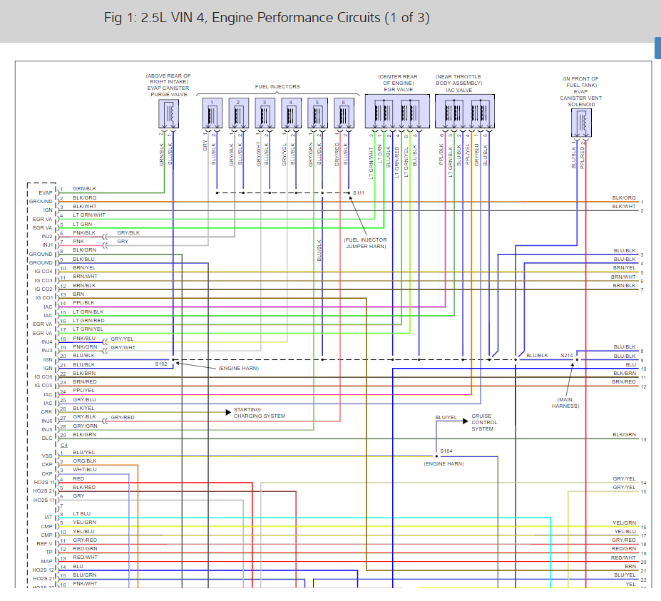

Here are the fuse panels locations and relay locations with the engine wiring diagrams so you can see how the system works.
