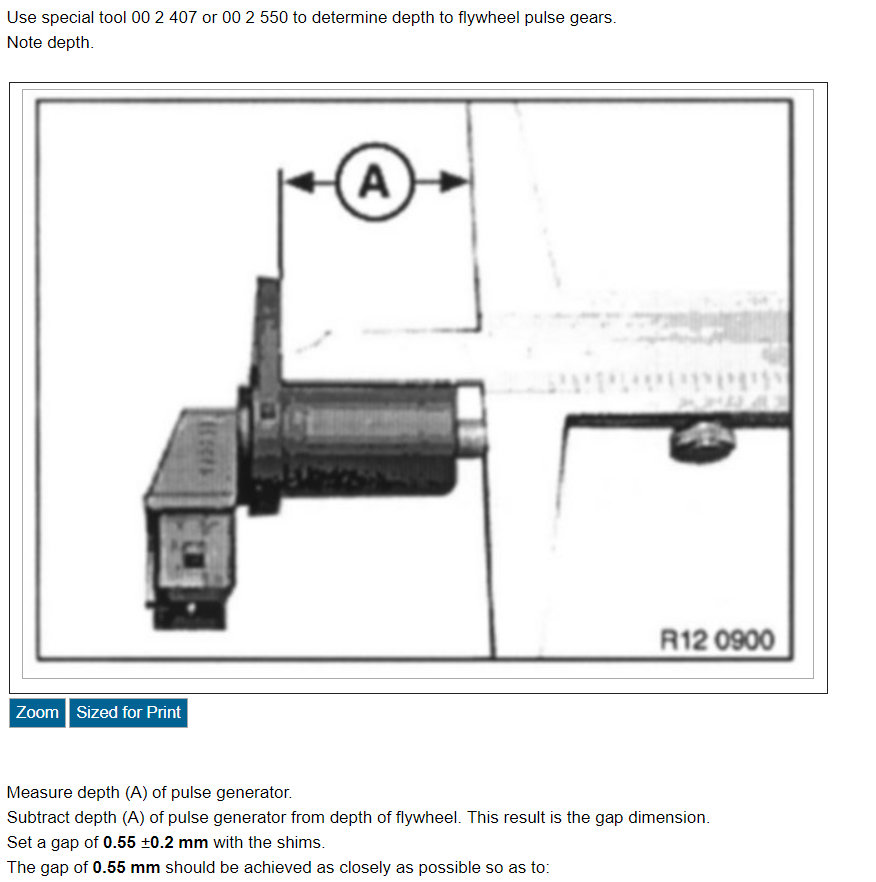

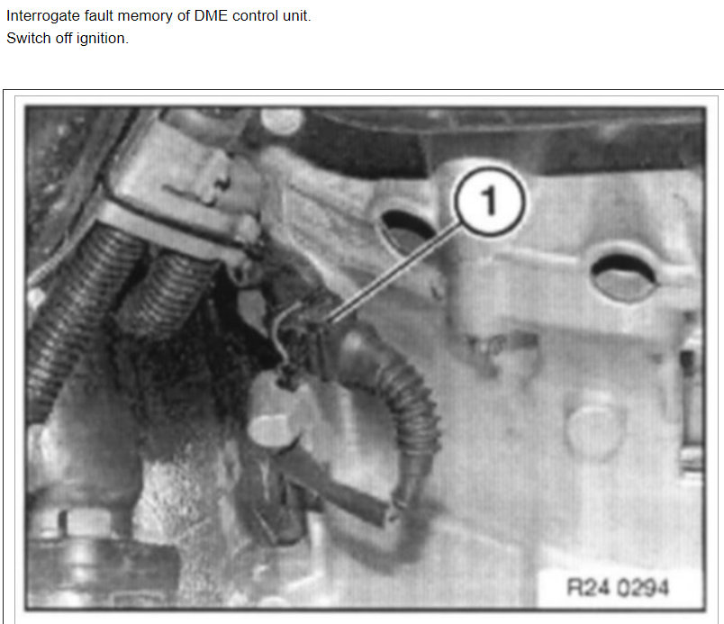

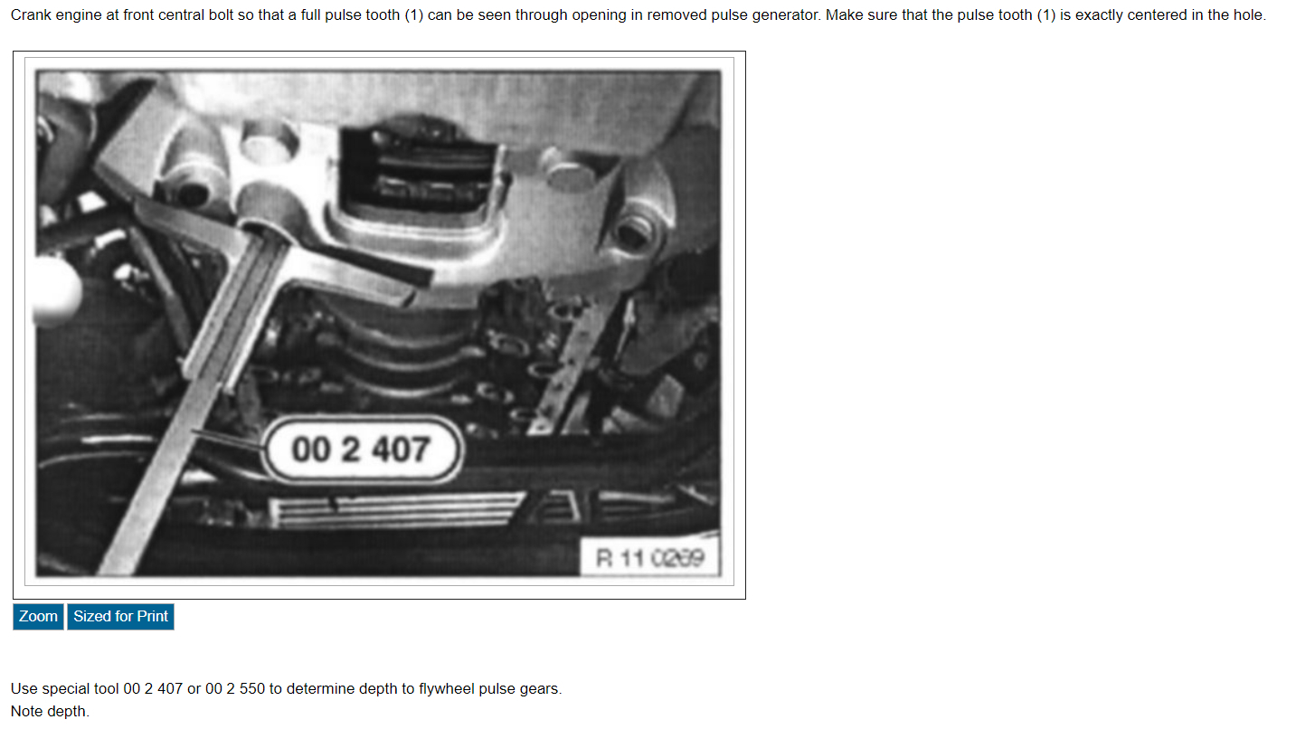

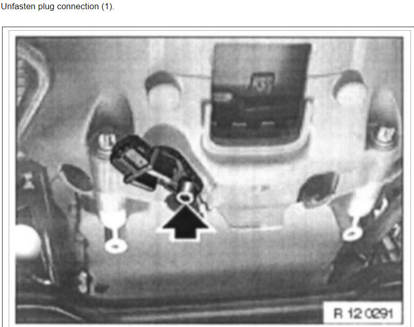

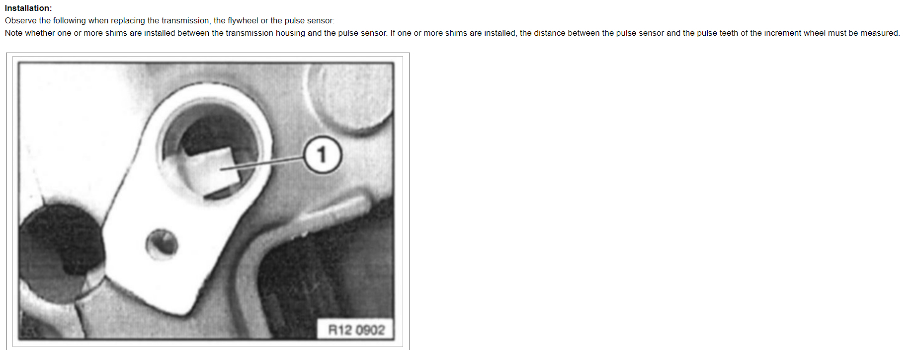

This sounds like a classic crankshaft angle sensor failure which is located down on the bellhousing on the passenger's side.
Here is a guide to give you an idea of what you are in for when doing the job.
Here is the location for your car (below)
