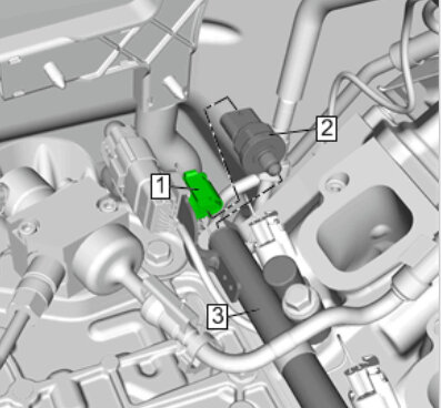

So when you say you replaced the fuel pump can I ask if it was the high or low pressure pump? I have seen the fuel pump pressure sensor in the fuel rail cause his problem. Here is the sensor location which is at the end of the fuel rail so you can swap it out, once completed clear the codes. Release the fuel pressure slowly before you begin.
The P0700 code can be caused by the battery issue.
Check out the images (below). Let us know how it goes
