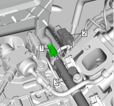

The past month an half ive had this problem of not wanting to start. Put the key in turn to on position lights come on everything goes away a does crank don’t even try to spin over.! Has codes of P0700 an P129D that is TCM and fuel pump driver mod. So ive replaced the fuel pump, fuel pump mod a the ignition switch battery is good I put a new alternator on. So idk what to do ive took it to a dealership a they told me everything was fine because it crunk up for him every time! Help me

So when you say you replaced the fuel pump can I ask if it was the high or low pressure pump? I have seen the fuel pump pressure sensor in the fuel rail cause his problem. Here is the sensor location which is at the end of the fuel rail so you can swap it out, once completed clear the codes. Release the fuel pressure slowly before you begin.
The P0700 code can be caused by the battery issue.
Check out the images (below). Let us know how it goes
