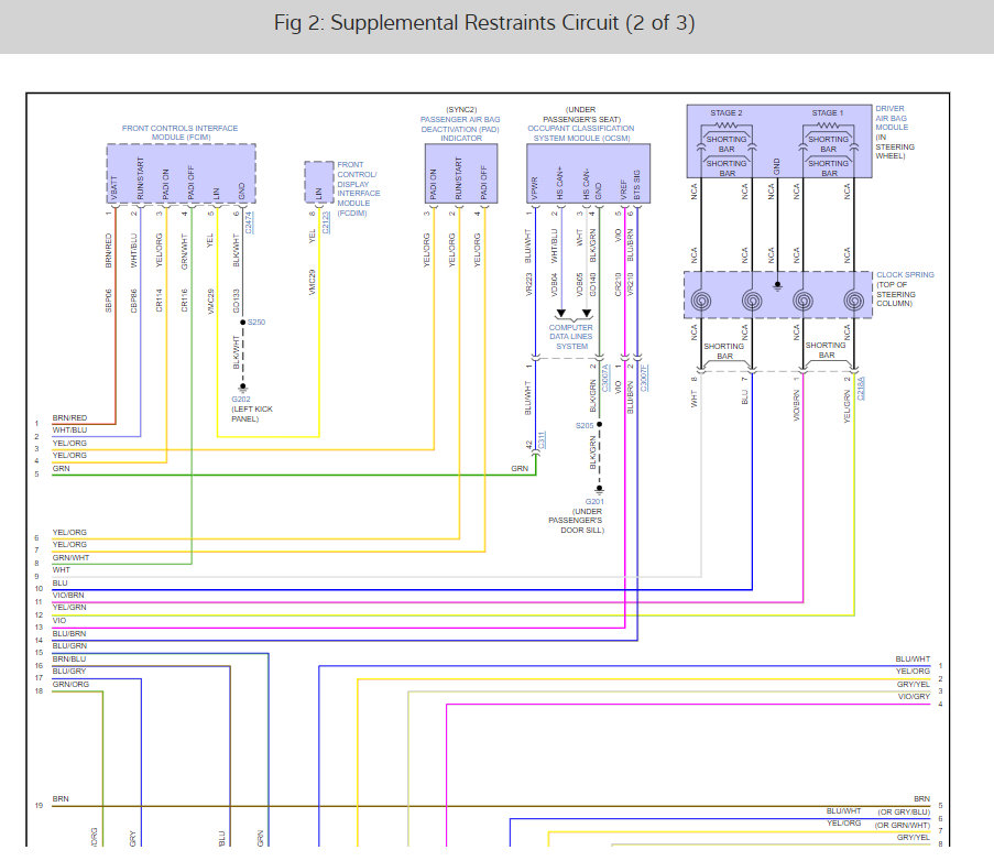

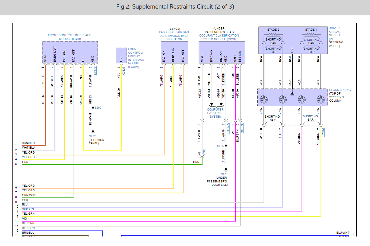

Three days ago, I had a hard braking incident where I laid on my horn after an elderly couple stopped in the middle of a busy road. No impact, however, since then I've had an intermittent SRS light come on.
I bought a scanner and got the following code(s): B00A0 status 08 fault 09
B00C0:11-28
Passenger occupancy sensor A short to ground.
Is this a possible loose connection? I looked under the passenger seat and all wires looked intact. I disconnected one sensor, looked at the connections which were clean, reconnected the sensor and cleared all codes, but the light re-occurred tonight.
I called my mechanic, but he told me this has to be done at the dealership. I called the dealership, but they wouldn't discuss the codes over the phone, and they want to charge me $120.00 to diagnose (not fix) the issue. Whether that's just to hook up the scanner or includes finding the issue, he wouldn't tell me which is sketchy to me.
I hope to hear from someone who can tell me if the sensor is the seat position sensor or if it's the weight pad under the cushion?

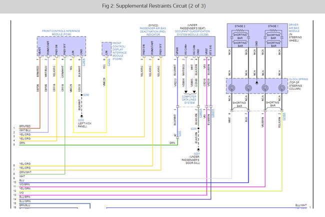

Yep, the code is for the passenger seat occupant sensor which is common, what happens is heat or water can cause the module to go out. The module is located under the passenger's seat. I would remove the module and check for water damage and corrosion on the electrical connector. This module is called an occupant classification system module (OSCM) I believe you can get a new module and replace the old, it should be plug and play. Please let us know what you find. We are interested to see what it is. Also, there is a ground wire I would check under the passenger's door sill. Check the wiring diagrams below to see what I am talking about.

Thanks for your reply, Ken. My passenger seat has not gotten wet at all or exposed to serious heat events, so I'm not sure why a sensor would fail in those regards. I appreciate the wiring diagram which will help me find the ground wire since I believe it's a loose bolt or wire as it's intermittent short to ground code. One thing I don't know is which sensor is Sensor A? There are 2 sensors in the seat, the weight pad sensor and a seat position sensor.
Unfortunately, when it comes to the SRS system, the majority of the sensors are not plug and play. They need to be programmed into the airbag control module with the new serial numbers if replaced otherwise the control module will throw a new code and disable the system. At least that's what my trusty mechanic is telling me.
I inspected the underside of the seat where the sensors are and there's no signs of water intrusion such as stains and the wiring look to be in new condition. The only things I haven't checked are the bolts that hold the seat position sensor and ground wire in place. If either of those are loose, it may be causing the light.
Jul 15, 2022 at 4:53 AM
  • 55,694 POSTS

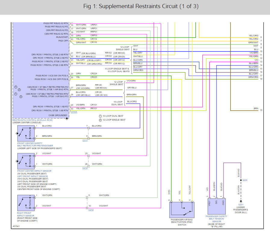

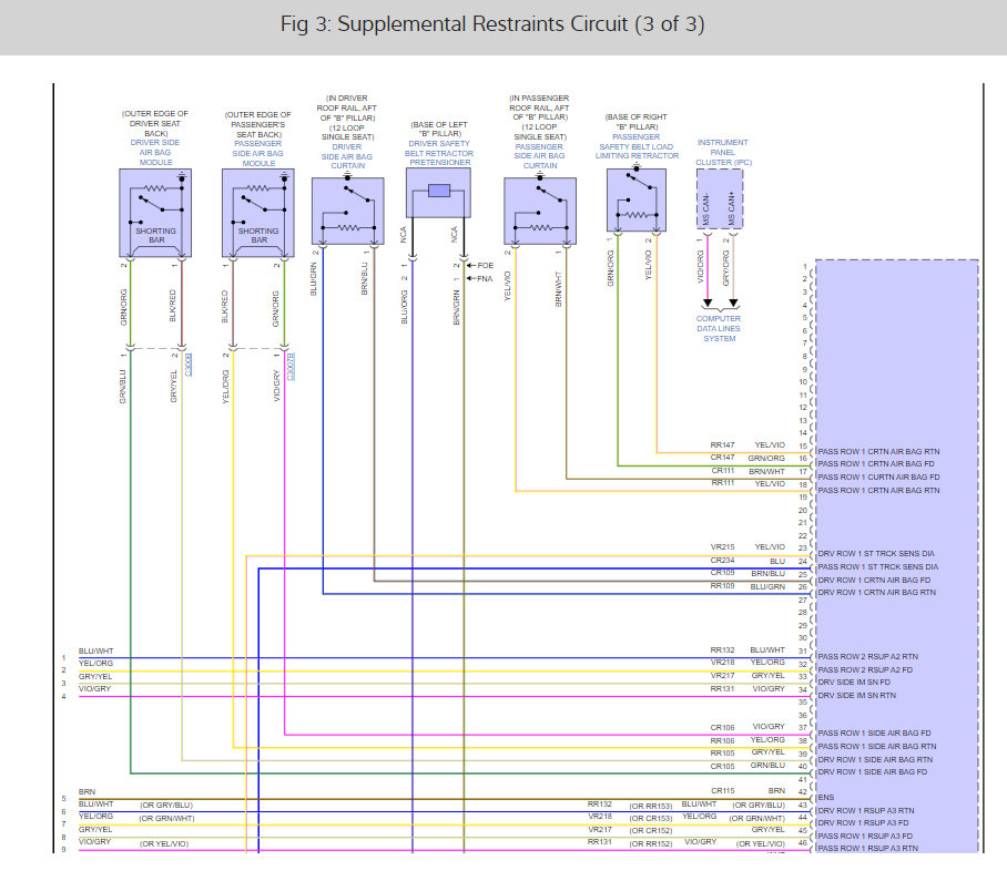

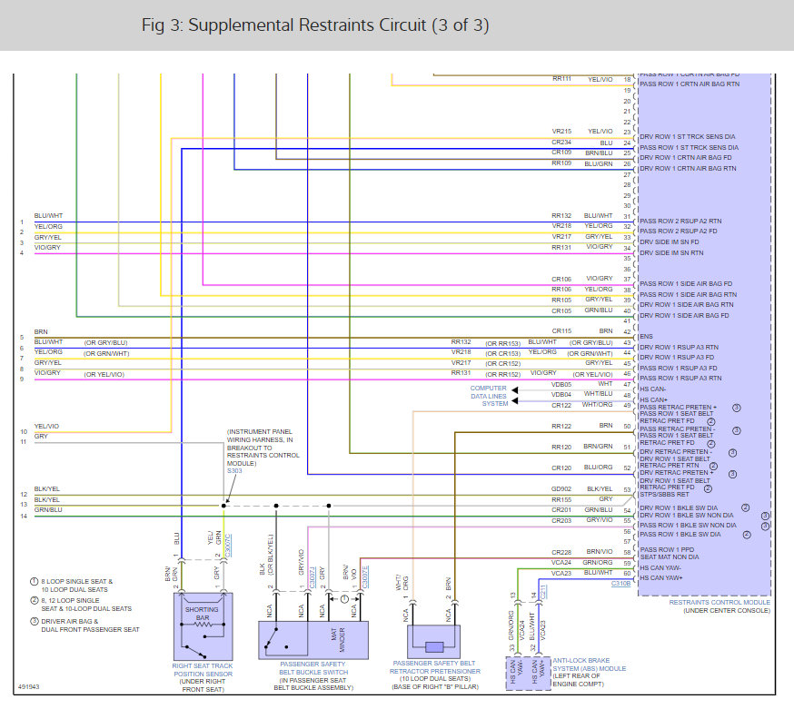

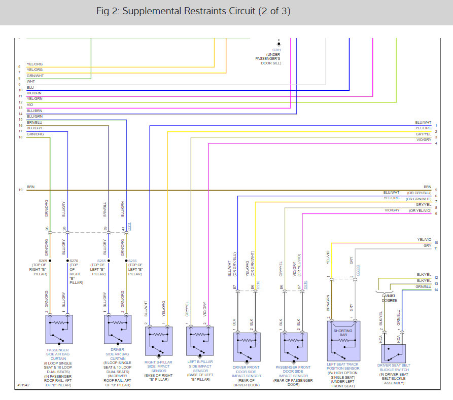

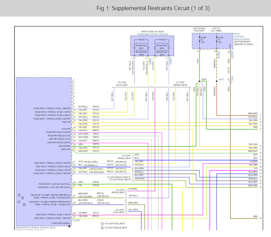

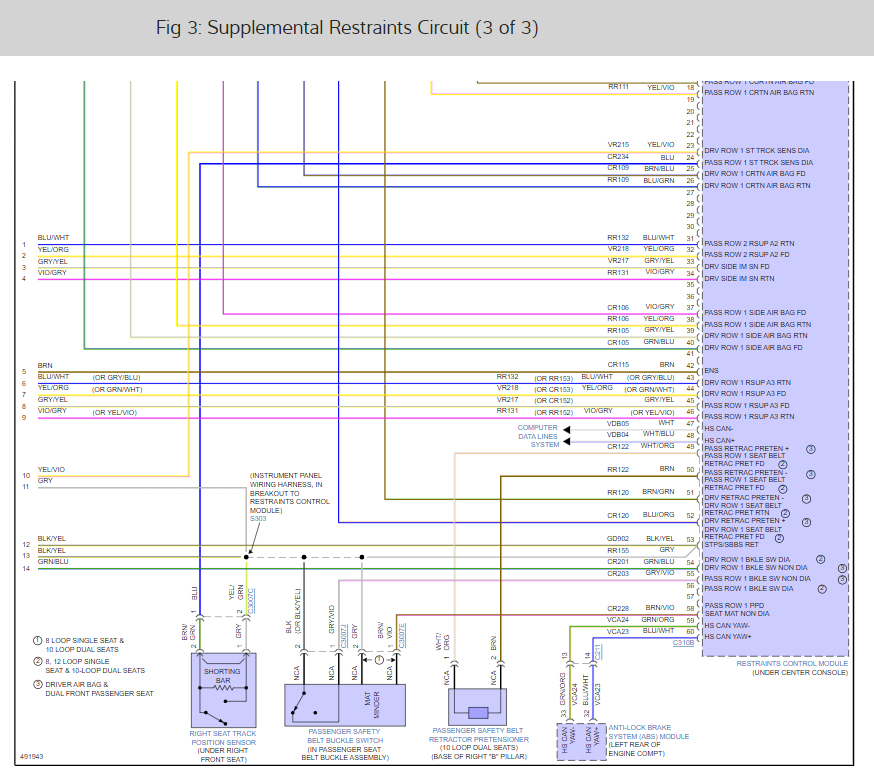

Each system is a little different, older systems let you swap parts and as long as the self-check goes okay the system would work, sometimes the sensor modules just go out for whatever reason. Here are the rest of the wiring diagrams so you can get a complete picture of how it works. Recheck the fuses and grounds and if okay replace the passenger seat module. it doesn't say which is which in my information. Check out the diagrams (below). Please let us know what you find. We are interested to see what it is.

I checked all the connections and they're tight. No signs of water damage. I reached out to a Ford certified mechanic on a question answered site and my B00C0 code had gone from B00C0:11-28 to a B00C0:11AB which is an active fault, not an intermittent fault. After sharing my codes past and present with the mechanic, he revealed it's the weight pad sensor in the seat and it's got an electrical short inside it. The only way to fix is replacement which my local Ford dealer told me is virtually impossible since parts aren't available. I've been searching high and low for the part and either it cannot be found, or it's used. I'm not about to put a used part in my van and risk another fault. The mechanic told me it can be replaced on my own, but it does require a thorough DCM code clearing which most personal code readers cannot do, or so he said. I can't replace nor can I afford to replace the part because it cannot be ordered. I searched available airbag sensors on the Ford parts site and the weight sensor isn't even listed. I'll try searching part numbers on the tags hanging on the wires under the seat but I'm not holding much hope.

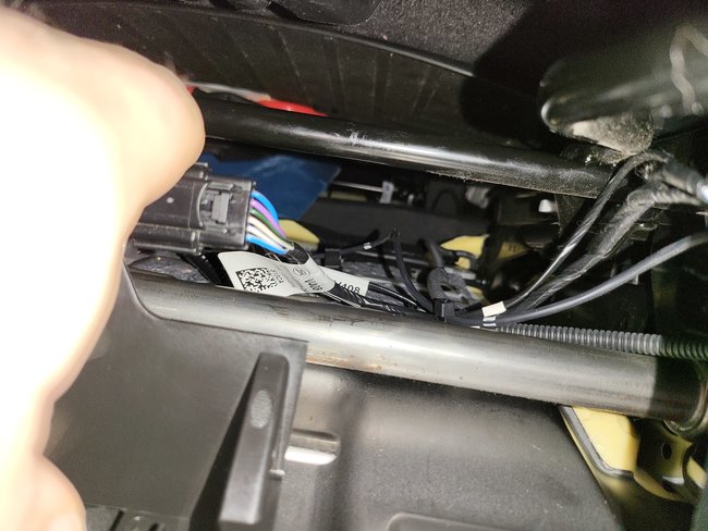

I got this pic but it's of the harness because the wires to the sensor pad are covered by hard plastic. I posted to three other transit forums in hopes someone else had this issue and came up with a fix or bypass but no luck so far. I cannot afford the $989.00 the dealership wants just for the seat cushion. With install and programming, it'll probably be around $1,400.00! The new cushion only has a 1-year warranty so if it fails again, I have to repeat the process again. I need my SRS system to be operable.
Jul 19, 2022 at 1:42 AM
  • 55,694 POSTS
Yep, it is a safety issue for sure. That does look like the module/sensor that needs to be replaced, have you tried ebay? Some people on this forum have had great luck with it.
