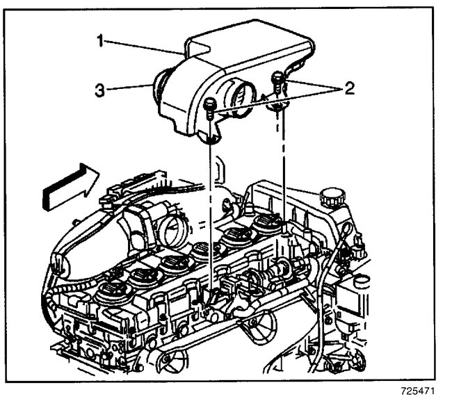

Here are the directions for removal and replacement of the coil packs. The attached pics correlate with these directions.
______________________
2002 Oldsmobile Truck Bravada 4WD L6-4.2L VIN S
Procedures
Vehicle Powertrain Management Ignition System Ignition Coil Service and Repair Procedures
PROCEDURES
REMOVAL PROCEDURE
pic 1
1. Remove the bolts (2) holding the resonator to the engine.
2. Loosen the clamp (3) on the resonator.
3. Remove the resonator.

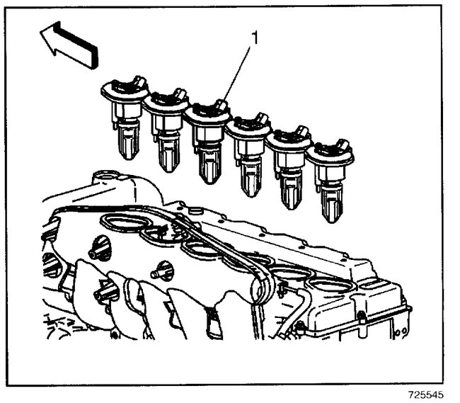

pic 2
4. Disconnect the ignition coil connectors (1) from the ignition coils.
5. Remove the retaining bolts (2) from the ignition coils.
pic 3
6. Remove the ignition coils (1) from the engine.

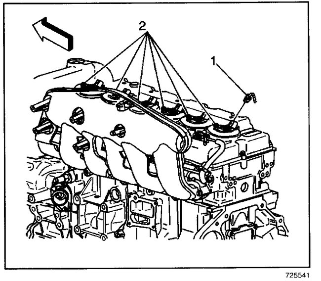

INSTALLATION PROCEDURE
IMPORTANT: Make sure that the ignition coil seals are properly seated to the valve cover.
pic 4
1. Install the ignition coil (1).
NOTE: Refer to Fastener Notice in Service Precautions.
pic 5
2. Install the ignition coil retaining bolts (2).
Tighten
Tighten the ignition coil retaining bolts to 10 N.m (89 lb in).
3. Replace the ignition coil connectors (1).
pic 6
4. Replace the resonator.
5. Install the resonator bolts (2).
Tighten
Tighten the resonator retaining bolts to 10 N.m (89 lb in).
6. Tighten the integral clamp holding the resonator to the engine.
Tighten
Tighten the integral clamp to 4 N.m (35 lb in).

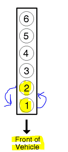

If you look at the last picture, it shows cylinder locations. Simply switch the coil pack between cylinders one and two and let's see if the misfire changes cylinders.
