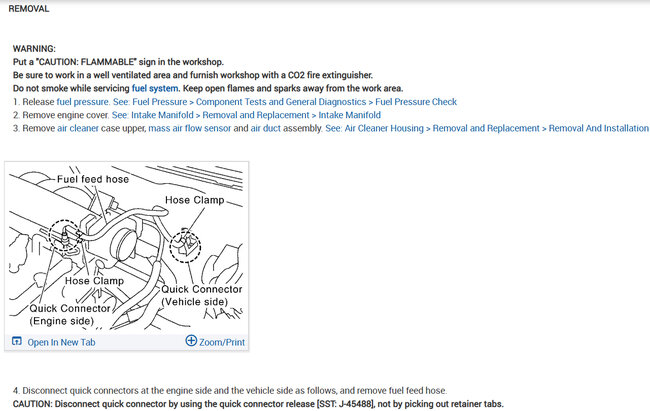

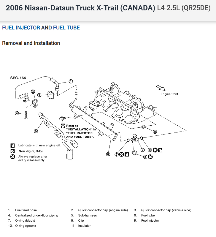

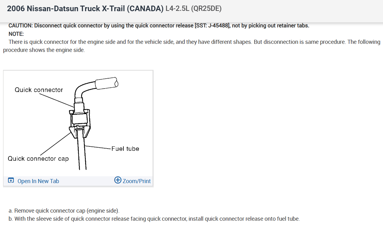

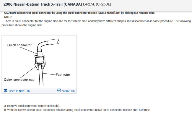

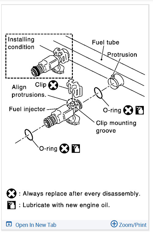

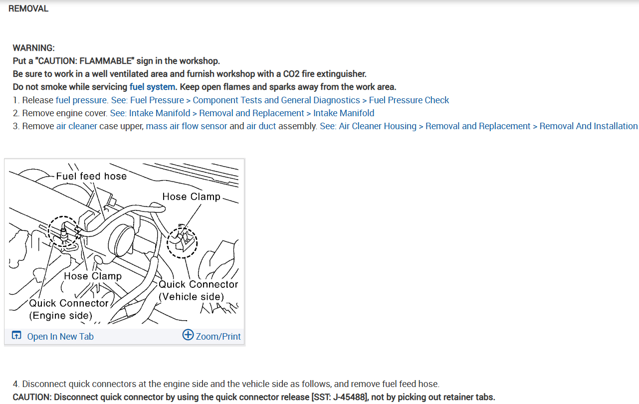

Lets do a compression test for that cylinder and if okay I would swap out the fuel injector. Please use this guide to help:
This guide can help as well:
Here is how to change out the fuel injector. Check out the images (below). Please let us know what happens.

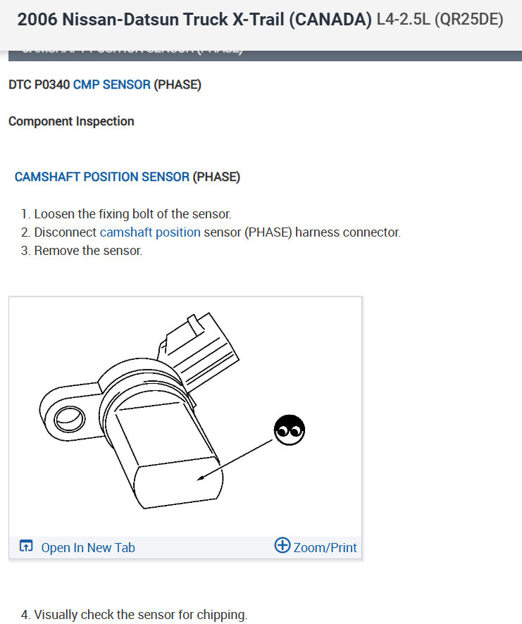

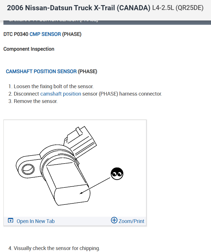

If the fuel injector and compression is okay the crankshaft sensor may cause this issue. They don't tell us where they are on this vehicle sorry, but I did find information on what to look for. Check out the images (below).
