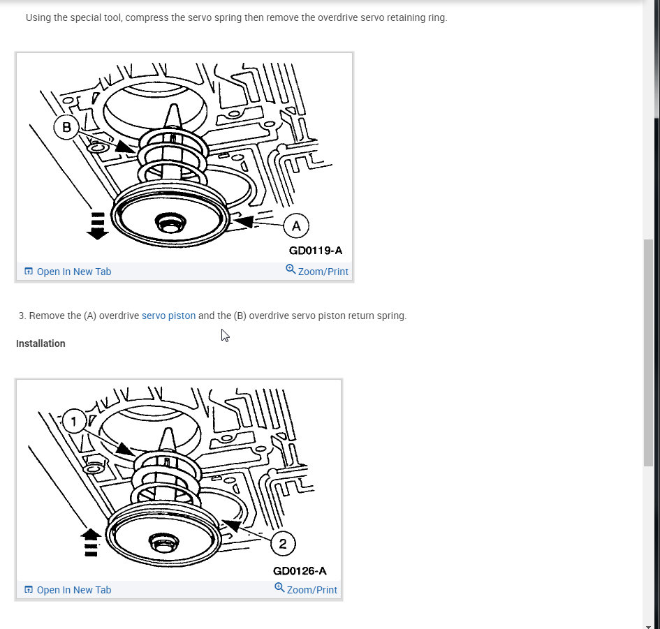

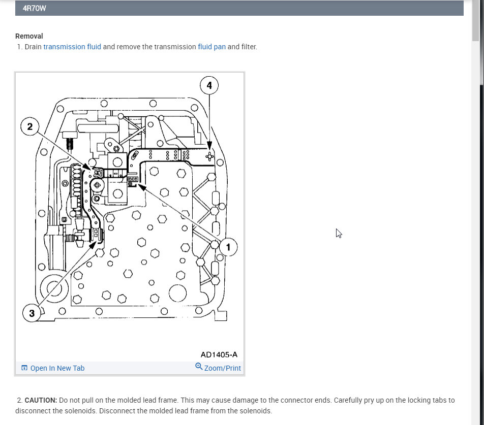

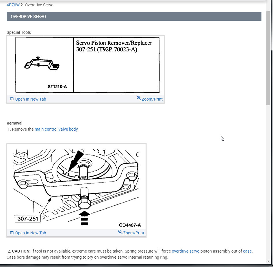

I had the transmission flushed about 35,000 miles ago. About a year ago, it started going to neutral on the 3-OD shift and has slowly gotten worse. It is used very little, but when I use it, if that occurs, I take it out of OD (button on the shift lever) and it works fine! After a few miles, I can shift it into OD (sometimes it takes a few tries) and it usually works fine until it is parked over night. Sometimes it will start out in the morning and shift through all the gears with no problem. The transmission always works great in the first 3 gears, it is the OD that is a problem. I'm thinking a solenoid valve problem.
Dec 20, 2019 at 3:31 AM

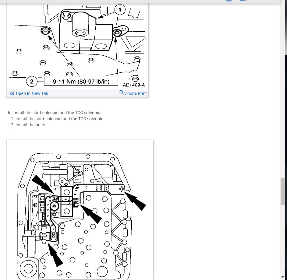

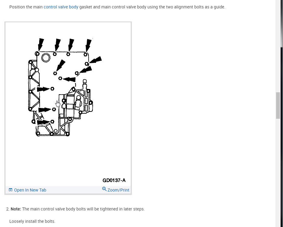

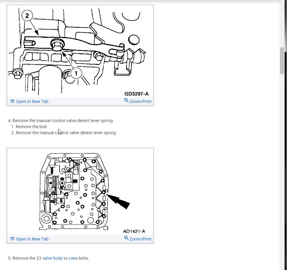

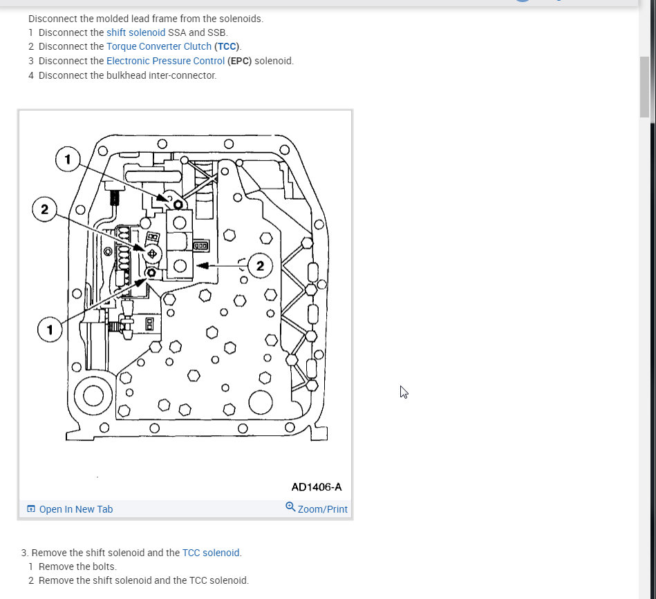

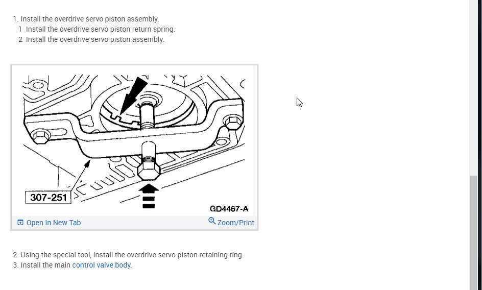

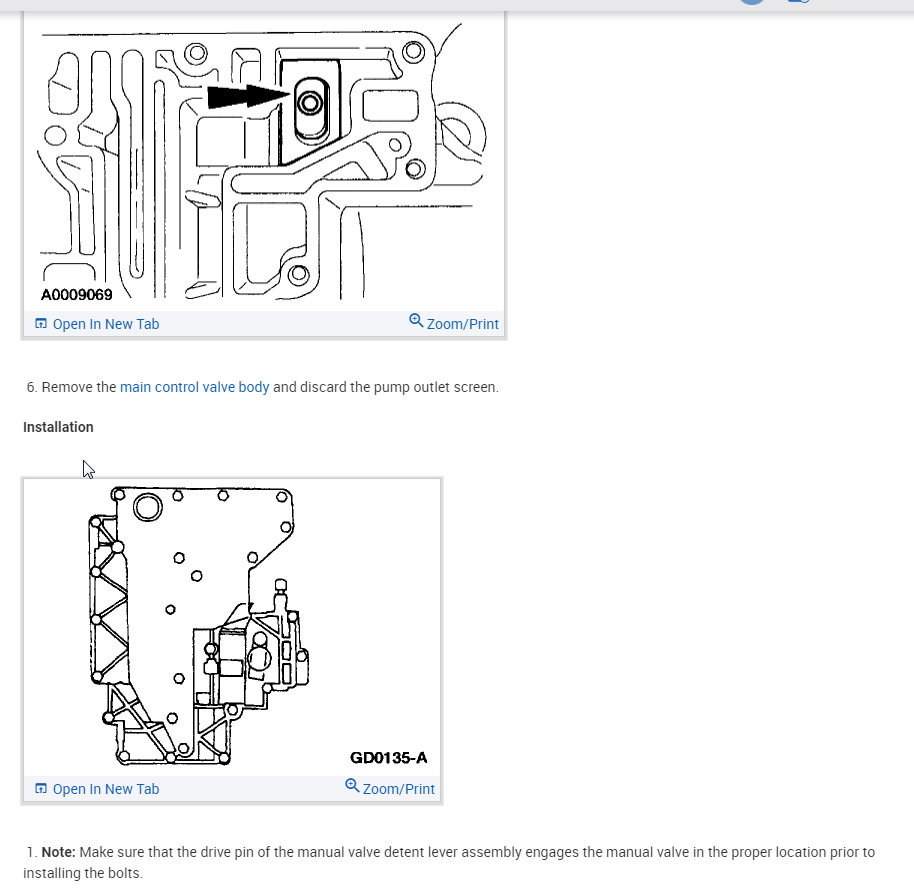

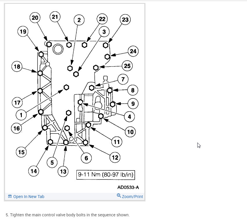

You are correct. More than likely this is the torque converter clutch control circuit or the overdrive servo. I have rebuilt a lot of these transmissions and I would go with the the servo before anything else. Normally when the seal is cut it allows fluid to pass when it gets hot. This would explain the intermittent operation.
I included processes for both the valve body and servo. Unfortunately the only way to test this is to air check it. This means you need to remove the valve body and install an air check plate and if you don't have that then clearly you can't do it. I would just go with the servo. Let me know if you have questions.
