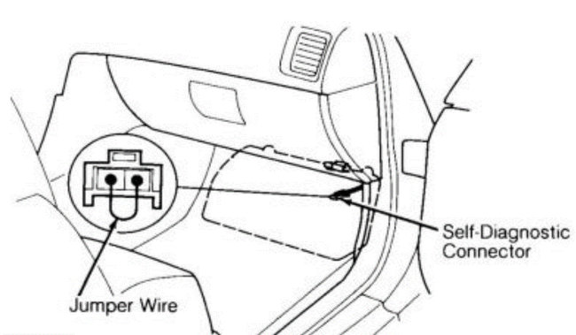

My problem is, I can not find the blue, two terminal, diagnostic connector, which is supposed to be located near the passenger side kick panel.
Is there anywhere else it could be located? Or, could it be stuffed under the dash, near the kick panel? If it's under the dash, I will have to take the dash apart to get to it.

I just came across your question. Take a look through the pic I attached below. It shows the location.
Let me know if this helps. Check out the diagrams (below). Please let us know if you need anything else to get the problem fixed.
