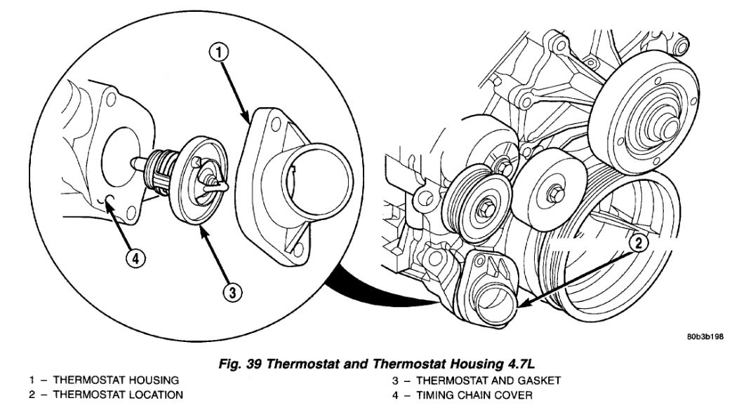

This sounds like coolant boiling in the surge tank or the heater core. I would start by changing the thermostat in case the coolant is getting too hot.
