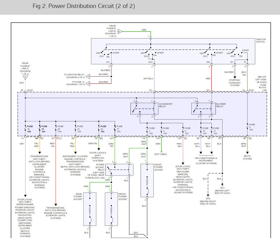

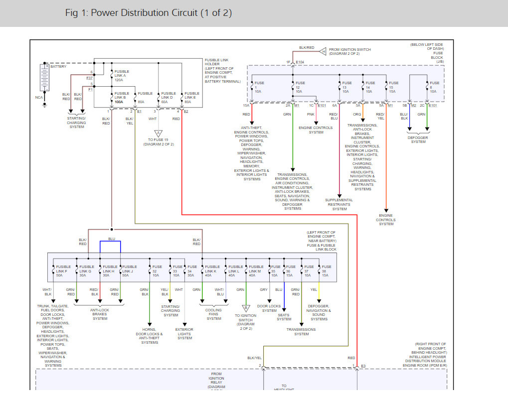

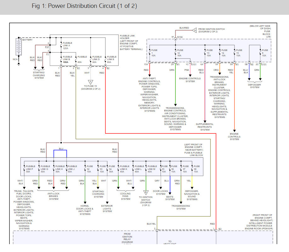

This still sounds like a connection problem. with the key on can you please move the positive and negative battery cable around to see if you can get it to act up? Also lets test through the fusible links as well. here is a guide with the diagrams below to show you what to test:

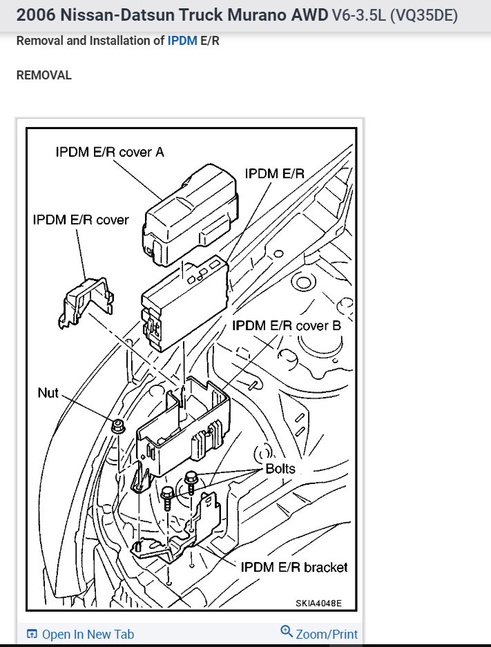

  • 55,721 POSTS

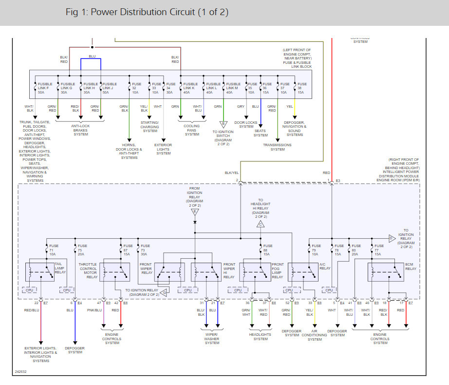

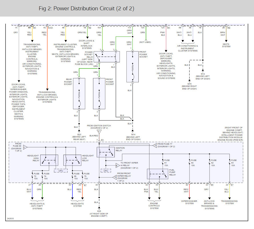

This sounds like the IPDM is going out which is common. To be sure here is guide to check for power and instructions on how to replace the IPDM which self initializes so its easy to replace:
See if the IPDM is losing power. Check out the diagrams (below). Please let us know what you find.
