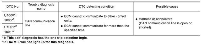

- Diagnostic trouble code "CAN COMM CIRCUIT" with CONSULT-II or U1000 without CONSULT-II is detected when TCM cannot communicate to other control units.
Possible Cause
Harness or connectors (CAN communication line is open or shorted.)

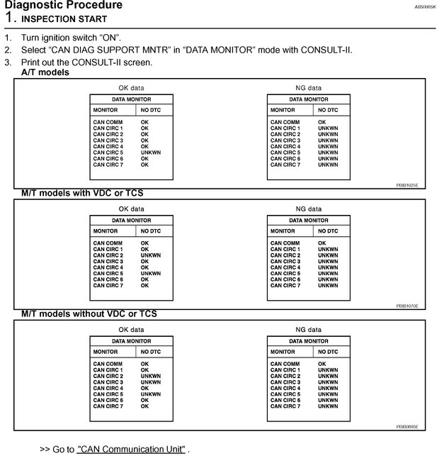

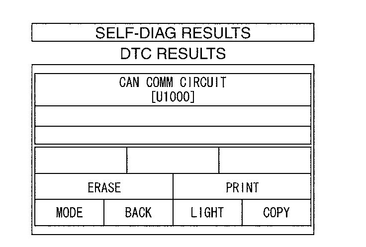

Diagnostic Procedure

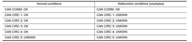

1. CHECK CAN COMMUNICATION CIRCUIT
With CONSULT-II
1. Turn ignition switch "ON" and start engine.
2. Select "DATA MONITOR" mode for "A/T" with CONSULT-II.
pic 2
3. The "CAN COMM CIRCUIT" is detected.
Yes or No?
Yes >> Print out CONSULT-II screen, GO TO 2.
No >> INSPECTION END

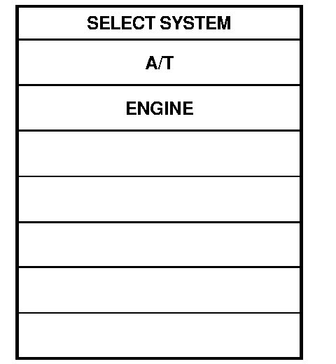

2. CHECK CAN COMMUNICATION SIGNALS
With CONSULT-II
2. Select "CAN COMM SIGNALS" in "DATA MONITOR" mode for "A/T" with CONSULT-II.
>> Print out CONSULT-II screen, go to "Precautions When Using CONSULT-II".

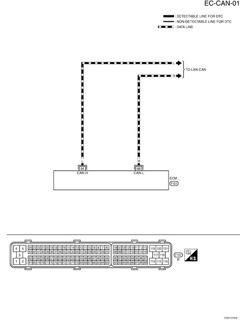

EC-CAN-01
pic 5
Wiring Diagram
Diagnostic Procedure Step 1
pic 6

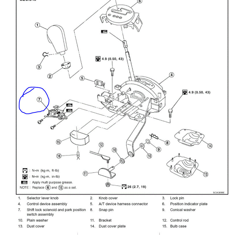

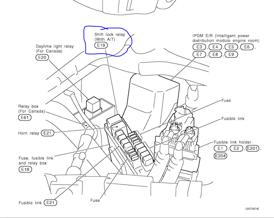

Where are you hearing the clicking while the shift indicator is flashing? Take a look at the attached pic. The item I circled is the park position switch and the park interlock switch. Could the sound be coming from that area?

It sounds as if it’s coming from near the IPDM or the other relay box by the battery.
Aug 17, 2020 at 2:55 PM
  • 110,248 POSTS
Do me a favor. Check to see if it is the shift lock relay. You should be able to feel it by placing your fingers on the relay. I attached a pic below.
If that is the relay, switch it with a different one having the same part number. Or here is a link that explains how to test one:
Aug 18, 2020 at 11:15 AM

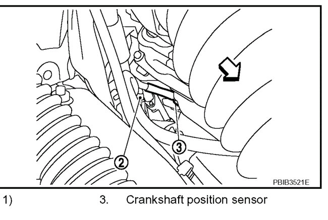

The reason I asked about the RPM's is because if the crank sensor stops sending a signal, you will lose spark. Also, the RPM signal would be lost. Check the wiring to it. The sensor itself may be going bad. Take a look through this link:

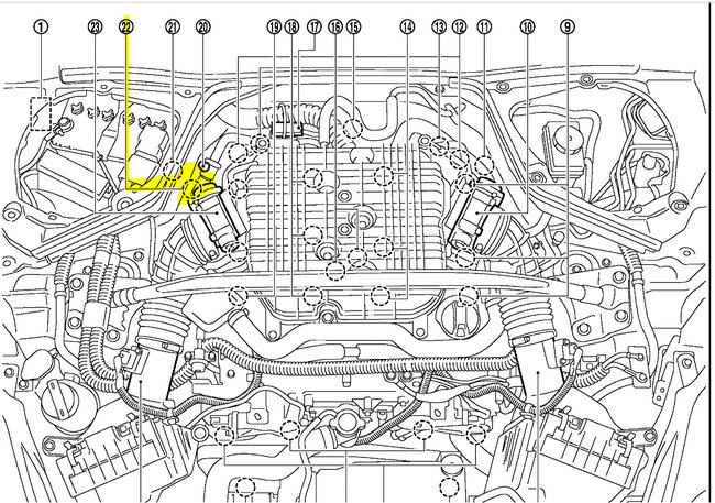

Interestingly, a faulty sensor may not set a code. I attached a pic below of the sensor location. It is a bit vague. LOL Let me know if it helps.
Aug 18, 2020 at 2:03 PM
JIM JACKSON2
  • 21 POSTS
That pic is vague haha. I’ll find it though. This does make sense because it is after the car is up to temperature when it starts cutting out. And that’s really what it feels like is that the engine completely shuts off and turns back on. I don't know if I mentioned though if I accelerate hard it will not do it or at least not noticeable. I will check out the sensor tomorrow when I have daylight though.
Aug 18, 2020 at 2:09 PM
  • 110,248 POSTS
It's below the bank 1 throttle control actuator. Here is another pic that may be more helpful.
Per Alldata:
"The crankshaft position sensor (POS) is located on the oil pan facing the gear teeth (cogs) of the signal plate."
